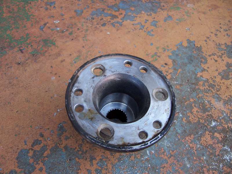

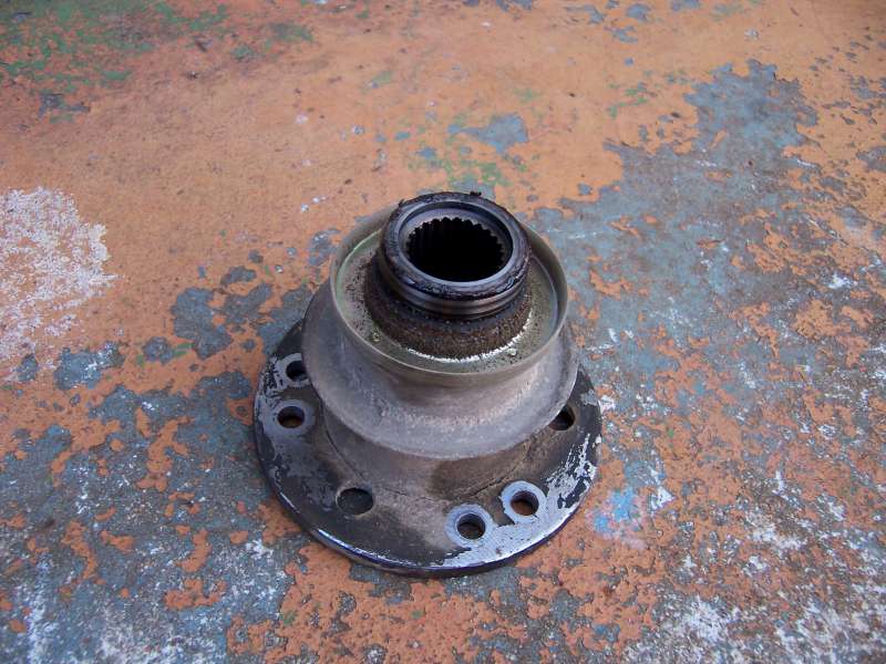

Thanks for that,
Did you just use the R30 flange, (see picture) on the 240k Stub ?
or did you use the R30 Stub and Flange ?
the Doc says.. "For Datsun 510 & 240/260/280Z",
not 240K..
as far as I can tell
Nigel

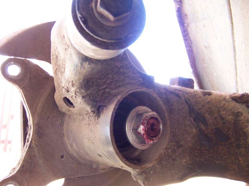

Does anyone know if the R30 flange will fit the 240K axle ?
also. can I remove the Uni-Joint flage comming out of the diff, via the bolt, and put the R30 drive shaft into the diff ?, or do I need to install the R30 diff into my 240K ?
Nigel

For the life of me, I cannot remember what flanges I used. But being that I used a R30 Diff and Axles, there is a good change I used the flanges as well. But, something keeps me thinking I needed something off a 240Z (not 240K) and it migh have been the flanges.
Have you tried to fit the flanges? Did the dust cover fowel on the stub bearing case? Or does it spin freely?
I haven't tried it yet, since my 240K is my daily drive,
but I now have a clicking sound from the rear when I apply power and take if off, sounds a bit like a uni joint dying, so I'll have a look at the flange when I fix the drive shaft.
