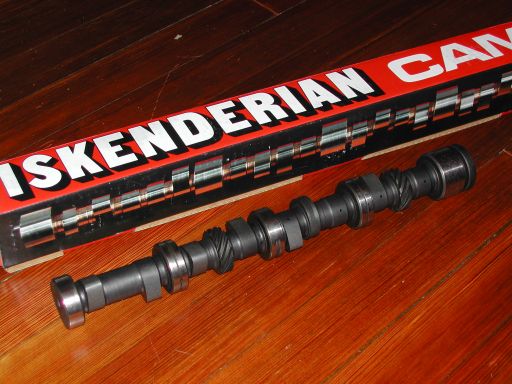

As you can see below I went with Isky. Thanks again for the recommendations. This grind was only about $100. SHould know how I like it by the end of the summer when it's back together.
michael
