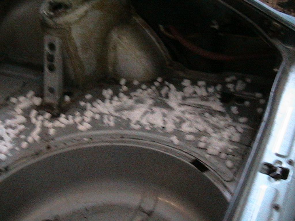

March 4, 200520 yr Author comment_115084 Although I did have one problem. I did not purchase enough dry ice. I'd say that, roughly, you need a minimum of 1 lb of dry ice per square foot. That's if you're able to get the chunks broken down into as small chunks as possible. Link to comment https://www.classiczcars.com/forums/topic/15078-how-to-use-dry-ice-to-remove-tar-insulation/?&page=3#findComment-115084 Share on other sites More sharing options...
March 4, 200520 yr comment_115132 I was surprised, after I saw the pictures of your dry ice I expected the chunks to be large. Although when i got mine each piece was the shape of a tootsie rool, almost exactly the same. Link to comment https://www.classiczcars.com/forums/topic/15078-how-to-use-dry-ice-to-remove-tar-insulation/?&page=3#findComment-115132 Share on other sites More sharing options...

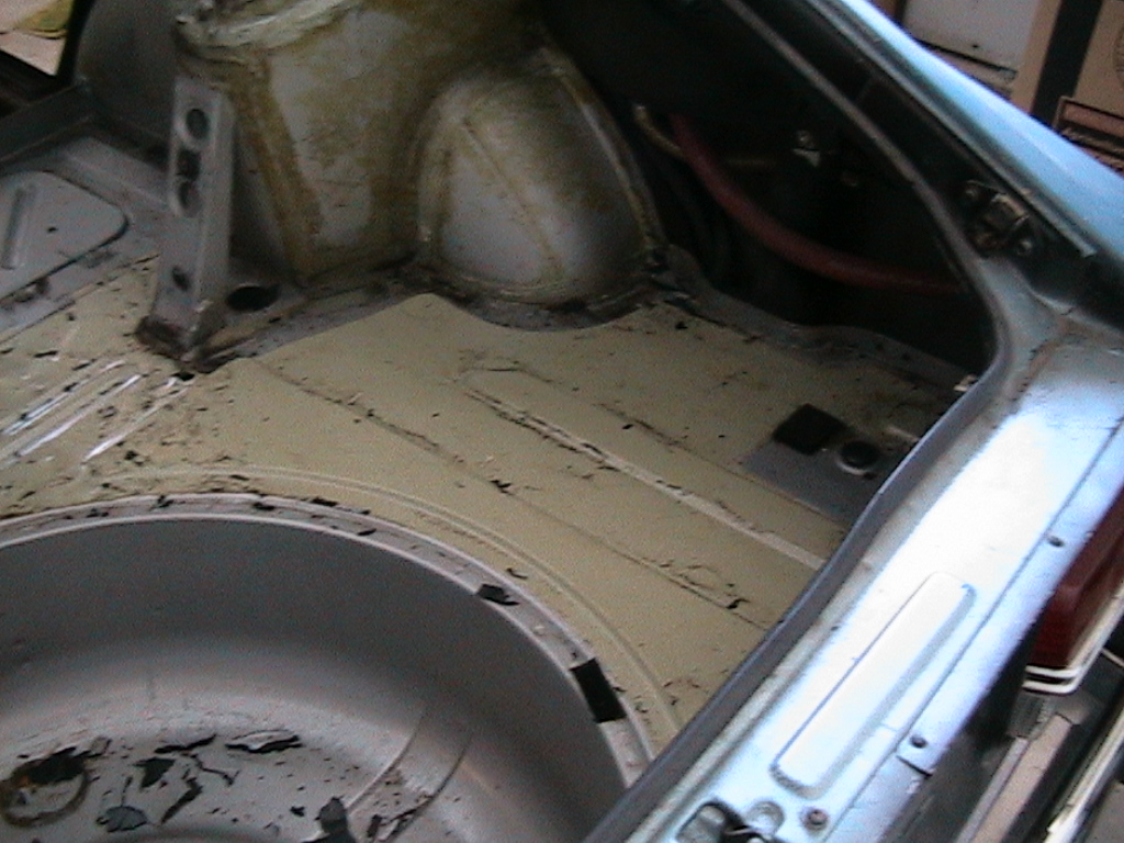

March 10, 200520 yr comment_115938 heres pictures of one section of the dry ice "technique *sorry about the bad photos Link to comment https://www.classiczcars.com/forums/topic/15078-how-to-use-dry-ice-to-remove-tar-insulation/?&page=3#findComment-115938 Share on other sites More sharing options...

April 11, 200520 yr comment_120102 Sorry to dredge this thread back up but I just came acrossed it. I will be needing to strip off my matting soon, so this thread has been very informative. I do have one question though: In some of the photos posted here, it looks as though the dry ice has not only seperated the matting, but the paint as well, is this correct? If this is true on my floorpan, no problem as they're shot anyway. But I'm going to need to do the rear deck area and don't necessarily want to remove the paint if it's not needed. Can one of the successful experimenters please clarify on this? Link to comment https://www.classiczcars.com/forums/topic/15078-how-to-use-dry-ice-to-remove-tar-insulation/?&page=3#findComment-120102 Share on other sites More sharing options...
April 11, 200520 yr comment_120110 There is no paint under the tar mat. The paint was applied after the mat was laid down. Link to comment https://www.classiczcars.com/forums/topic/15078-how-to-use-dry-ice-to-remove-tar-insulation/?&page=3#findComment-120110 Share on other sites More sharing options...
