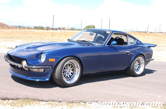

January 24, 200520 yr comment_110024 I believe what MSA and others who use large offset wheels with spacer kits are saying it is "ok" for street use. The stress on these high offset rims used on cars like ours now is on the spacer kit. Problem we see with spacer kits is people don't check the tightness of the spacer kit to the hub because it is covered by the wheel, they only check the lug nuts on the wheel. We've seen wheels shear the hub studs at track events because the person was only checking the lug nuts on the wheel (not the nuts holding on the spacer kit underneath the wheel). I would use proper offset wheels if at all possible, but that is only my opinion. I'm using 17 x 9.5" wheels at all four corners with a 5" backspacing. With my coilover setup I even got the fronts to fit without flares. Link to comment https://www.classiczcars.com/forums/topic/14683-another-offset-question/#findComment-110024 Share on other sites More sharing options...
