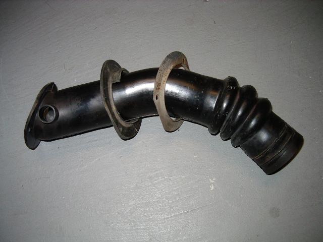

Posted December 12, 200420 yr comment_104875 anybody done this? i have had my new one sitting on top of my computer for about a month! is there an easier way to replace it than dropping the fuel tank? Link to comment https://www.classiczcars.com/forums/topic/14295-replacing-gas-filler-tube/ Share on other sites More sharing options...

December 14, 200420 yr comment_105120 Jason, Did your new filler tube come with a new rubber seal that goes between the body and the filler tube under the metal ring? Link to comment https://www.classiczcars.com/forums/topic/14295-replacing-gas-filler-tube/#findComment-105120 Share on other sites More sharing options...
December 14, 200420 yr comment_105132 Seal? My Z cars have only had the rubber gas flap and the tube itself. Do you have a picture of the seal you are refering toi, or a part number? Now I'm curious. Link to comment https://www.classiczcars.com/forums/topic/14295-replacing-gas-filler-tube/#findComment-105132 Share on other sites More sharing options...
December 14, 200420 yr comment_105133 Here you go Carl. The rubber seal gets held in place by the metal ring. It sits on the lower fender portion. Mine is trashed and was hoping to find a replacement. Link to comment https://www.classiczcars.com/forums/topic/14295-replacing-gas-filler-tube/#findComment-105133 Share on other sites More sharing options...
December 14, 200420 yr Author comment_105137 ya, my new one has one in ok condition. if my old one is intact i will let you know! Link to comment https://www.classiczcars.com/forums/topic/14295-replacing-gas-filler-tube/#findComment-105137 Share on other sites More sharing options...
