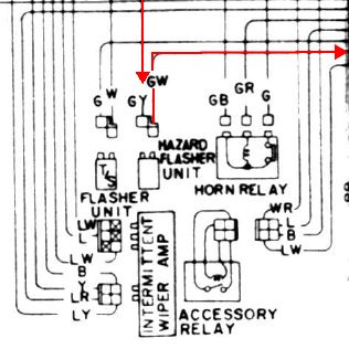

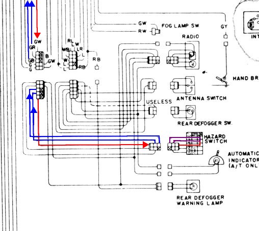

I remember under the center console there most certainly is the plug for the hazard switch. So just having a look at the wiring diagram, it seems all that would be needed to get it working is to plug in a hazard switch, and an additional flasher unit (see the pics attached).
Basically, GY puts power to the flasher unit from the fuse box, GW takes this to the flasher switch, which when turned on, puts power to the left and right blinker circuits. Easy done. Still haven't found the GY and GW wires up there yet. ;)
