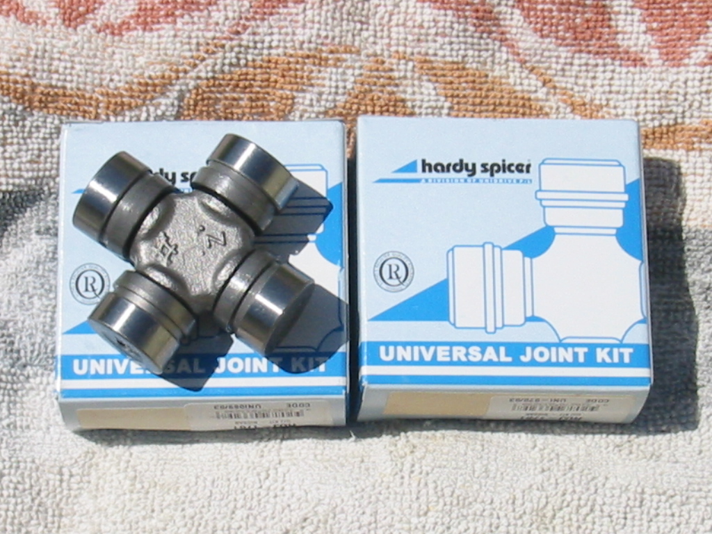

I just replaced the u-joints in my driveshaft and half shafts. I did contemplate paying extra and getting the spicer ones from MSA. BUT I ended up going to Advanced Auto Parts and getting there lifetime replacement U-joints for 13 bucks each. These also came with the grease fitting. I am happy with them. I guess only time will tell if they last. The stock one's lasted 30 years.
Hello Joseph - yes, I think that they are similar to those you have pictured. I think that I will just wait for the backordered ones. Only a week away...

Hello Greg
FWIW, the part number of the ones that I purchased is RUJ-1781. The universal joint is an internal circlip type, cap dimension 25mm and circlip to circlip dimension 44mm. They have a grease nipple which screws into one of the caps. They are made in Japan.
Note that the company that I purchased mine from is known as Hardy-Spicer (Im in Australia); I assume they relate to Spicer in some way.
They are to fit the driveshaft of a car with an original A type 5 speed transmission as standard, ie driveshaft is flanged at both ends.
