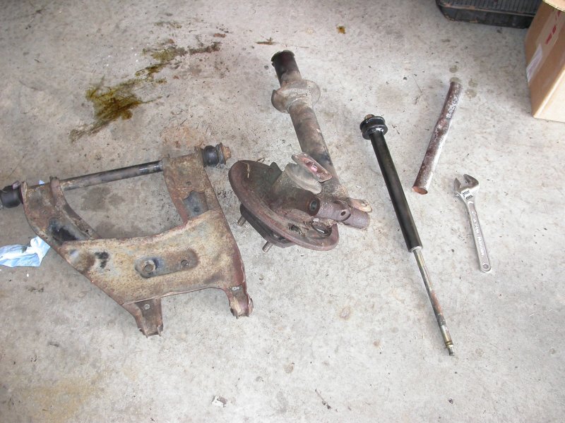

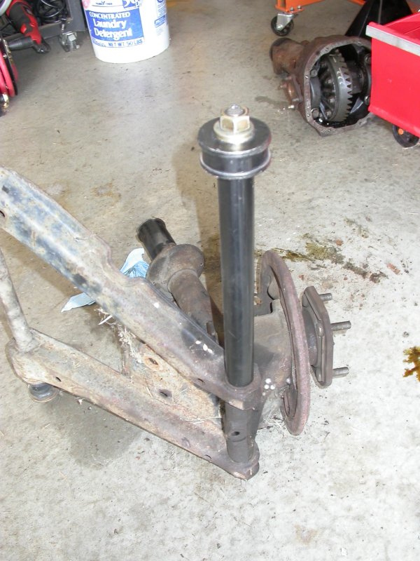

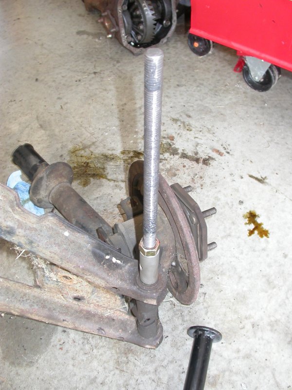

August 28, 200420 yr comment_93047 Chronology of the spindle pin pulling tool---Dan Bethea made the first ones, selling them on Hybridz. He didn't have any made up when I was about to do my suspension. I decided to make one for myself. Using mild steel etc, just to see how it would work. It worked well enough for me to find better materials to make them out of. The pic I have up on zdriver was the first version. Marty Rogan and seppi72 bought the 1st couple I made. I have since sent them updated parts for their tools.Soon after I posted pics, I saw my pics posted on another web site and selling them.I give credit to Dan Bethea for having the first idea to make the spindle pin tool. Link to comment https://www.classiczcars.com/forums/topic/12866-it-is-stuck-i-mean-fused-like-fast-food-chicken/?&page=3#findComment-93047 Share on other sites More sharing options...
September 4, 200420 yr comment_93788 The Spindle-Pin-Puller that Gary has is one I made.I have more info here http://www.linfoot.net When I buy a tool that works as advertised, I am always happy in an amazed sort of way! This tool is a godsend! After a 12 ton Harbor Freight press did nothing more than bend the pin end, this tool did both sides in about 20 - 30 minutes, with only a little sweat! The other two rear suspensions I have to do this on now will be cake! Thanks! Link to comment https://www.classiczcars.com/forums/topic/12866-it-is-stuck-i-mean-fused-like-fast-food-chicken/?&page=3#findComment-93788 Share on other sites More sharing options...
