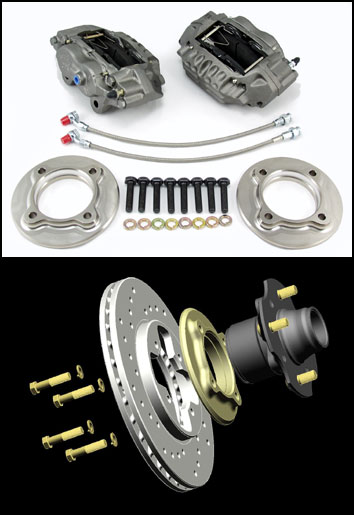

Did you see how MSA now has a kit they want to sell for $$$ which allows the use of those 84-5 300zx VENTED front rotors on the front of our Z with the use of some 4piston caliper... Well, see how their kit includes a spacer to go between the disc and hub... I've included a pic here...
Has anyone found this spacer elsewhere, like if someone wanted to get JUST the spacer and not pay MSA the $600 for the whole kit....

I think you might be able to buy just the spacer from Modern Motorsports or JSK Innovations.
MSA's price isn't too far off the market price when you figure it includes everything you need to do the swap including calipers. It's maybe 75-100 more than buying things seperately, but then, if you buy them seperately you run into a possibility they won't be compatible.
Modern Motorsports offers a complete kit, and I think buy the time you include the calipers, it comes out pretty close.
:pirate: You can save a lot of money by getting the parts for yourself at a pick and pull junkyard. I have done this setup for around $150 with stainless steel hoses. Go to HybridZ.org site and look around. Several sites sell the spacers for a lot less. Don't know your area and can't say much about prices. I just moved from Greeley, Colorado to Fayetteville, NC. They had a great site in Greeley, but not here in NC.
