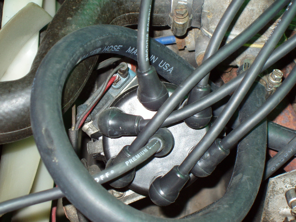

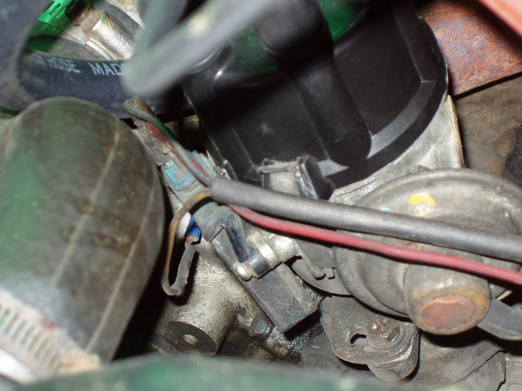

April 14, 200421 yr Author comment_77097 the manual i have does not have a diagram for sparkplug placement. it said there were to many models to put in the book or something. here is some pics of the dist. Link to comment https://www.classiczcars.com/forums/topic/11223-oil-that-does-not-come-out/?&page=2#findComment-77097 Share on other sites More sharing options...
April 14, 200421 yr comment_77100 Looks like you forgot to attach the pictures. What kind of book do you have? Did you figure out if the dizzy is points or electronic? Chris Link to comment https://www.classiczcars.com/forums/topic/11223-oil-that-does-not-come-out/?&page=2#findComment-77100 Share on other sites More sharing options...
April 14, 200421 yr Author comment_77101 they are electronic Link to comment https://www.classiczcars.com/forums/topic/11223-oil-that-does-not-come-out/?&page=2#findComment-77101 Share on other sites More sharing options...
April 14, 200421 yr Author comment_77103 another look Link to comment https://www.classiczcars.com/forums/topic/11223-oil-that-does-not-come-out/?&page=2#findComment-77103 Share on other sites More sharing options...
April 14, 200421 yr Author comment_77104 one more Link to comment https://www.classiczcars.com/forums/topic/11223-oil-that-does-not-come-out/?&page=2#findComment-77104 Share on other sites More sharing options...
