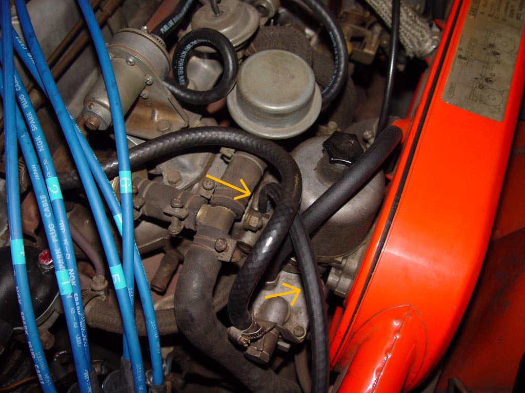

What year is the car? On my '72 240Z there is a connection on the front carb where a line connects to the diaphragm on the distributor.
I'm attaching a picture of the connection, the line the arrows point to is the one that runs to the advance on the dizzy
Purists, forgive me for using fuel lines for vacuum stuff!

Mines a 75 260 with triple webbers so the manifold is already different, ive had a mate of mine whos a mech look at it and he cant find anything on the manifold, so i just wanted to know what others with this problem did to solve it.
Thanks for the help though
With webbers there isn't anywhere to connect the vacumum advance. Forget it and dial in more static advance at idle.
two ways of doing it, set timing for full advance at around 2500 rpm, shoot for around 34 degrees, or at idle set it higher say 18 then take it for a drive, if you have pinging under load retard it a few degrees until it stops, if no pinging advance it till you get some then retard it untill it stops, then you know that you have dialed in the maximum advance that the engine can handle.
If you find that the engine is hard to start hot after setting it this way retard the timing a few degrees and that should take care of it.
