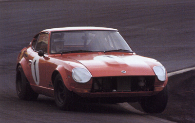

Here's a pic. of a Works ( SCCN ) 432R with the slightly wider Overfenders than the ZG type.
Notice the little "lip" on the outer edge - the ZG Factory type do not have this.
They got even wider on the aerodynamic cars that came just after this.
Alan T.

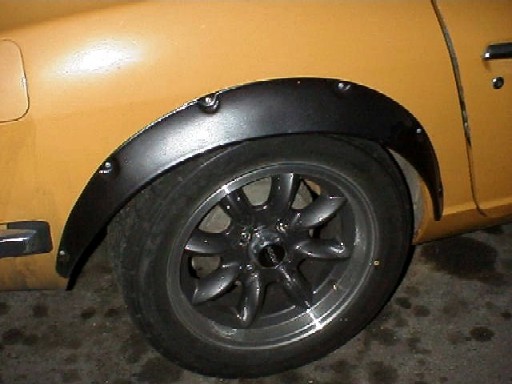

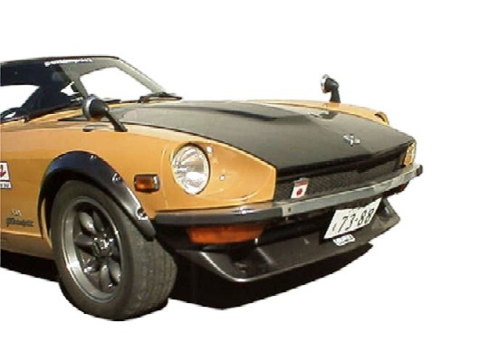

Attached pics show the type I'm looking for:classic:
They are available from 2 or 3 different aftermarket places in USA but @ about $200US, this gets pretty dear in $AUD:tapemouth
I assume these are what your refer to as ZG overfenders?
I already have an after market Japanese fibreglass G nose so the flares would finish it off nicely:love:
Those pics are of Les Cannaday's car, aren't they? I don't know if he got some "genuine" Overfenders and moulded a set off them, or the ones on his car are the real thing. Whatever, they look just about as close as you are going to get to the ZG Overfenders - I don't think anybody does anything better.
