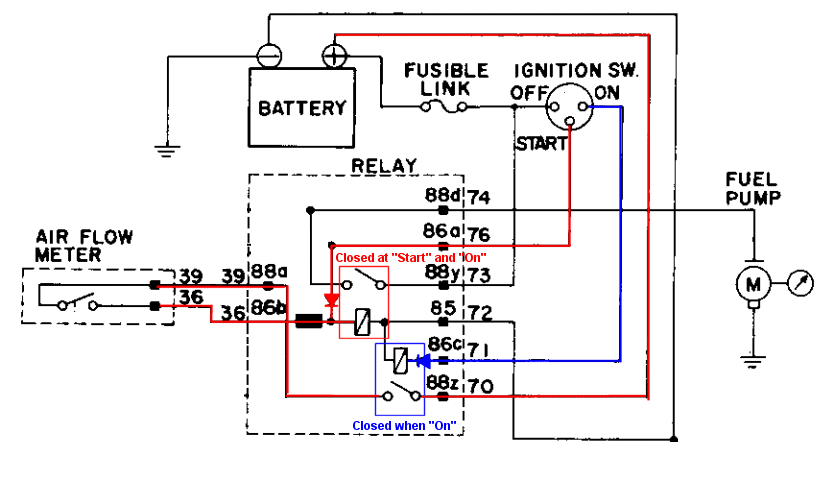

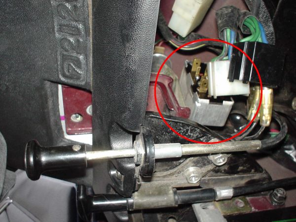

If you did these tests with the key at On, it looks like your Fuel Injection harness fusible link is blown, disconnected or has a corroded connection. It is the single green wire, that looks like some sort of extension with a connector on each end, connected to a white wire directly from the battery positive terminal. If it is in its original spot, it may be attached to the side of the relay box with a long plastic peg. OR, your FI and Fuel Pump relay is bad. It is combined for the 1976 model, attached up above the hood release handle. A silver box, about 1 x 1 x 2".
With the key On you should have battery voltage at the dropping resistors, they are fed directly by the EFI/Pump relay, which is on the circuit with the FI fusible link. There are some good diagrams on pages EF-25 and more in the FSM.
EDIT - Blue covered the relay in Posts #3, 4 and 5. That's the one. His diagram shows where the link is also. It's green.
