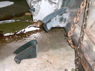

The little steel plate that bolts directly to the block and to the rubber bushed engine mount on each side is exactly the same as the one from the engine that came out of the car.

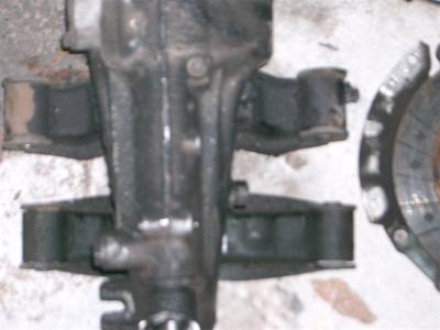

The gearbox cross member id different!!
Photos to come.
Scott
The Gearbox mounts are the same size and the 280zx one will bolt up to the 240Z no worries BUT the centre of the 280zx one is offset towards the front by 10-15mm resulting in a curved cross member.
