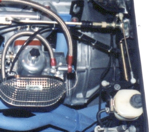

moyest,
Add another return spring from the top portion of the"bell crank" mounted on firewall to a home made tab mounted behind the mounting point of linkage (close to firewall at end of shaft heading toward carbies).
I'll try to attach a file that (if you blow it up bigger) shows what I'm talking about. The added spring is gold collored. My throttle is very firm and responsive, and the carbies shut down immediately. Also check that long throttle shaft moves freely. Drop the three links to carbs and the link to bell crank. Long shaft should not bind.
