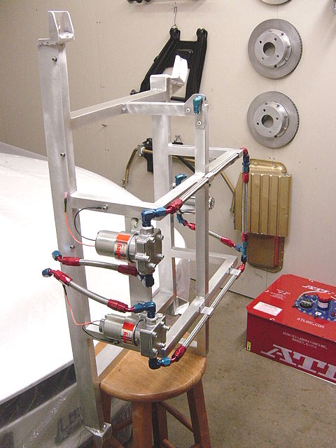

Just finished a fuel cell upgrade (out with 30 year old ATL, in with new) on completed car. Didn't want to burn it up welding, so came up with bolt/rivet method. Thought it could be of help to others that don't want to burn their cars with welding.
I have to many photos to show all here, so click on attachment to see NASCAR style frame then go to my gallery for more pictures.
https://www.classiczcars.com/forums/topic/9544-fuel-cell-for-streetrace/
