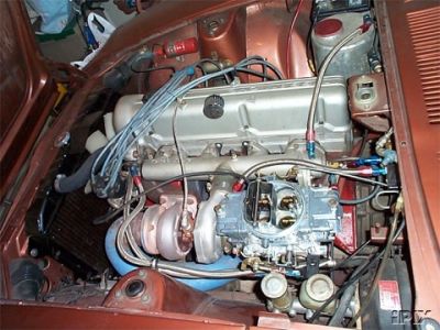

I am looking for any info anyone has on a turbo set-up for a 4-barrel carb system. I have only seen one of these on a car a while ago. I am looking to build something along the same lines as that. But just woundered if anyone had any info or anything like that for sale. Thanks

One thing I would look at on any single carb system for the L series or any inline 6 in the intake runner length. A lot of these manifolds have unequal length runners - IE shorter in the middle and longer on the ends. This will lean out the 1 and 6 and make 3 and 4 run rich. Not a good solution for a boosted engine. I personally would stay away from that type of arrangement, it lacks the neccessary tuning to compensate for the design. I do seem to remember a turbo tom? setup that was similar to what you are asking about.
IMO The factory turbo setup in much better designed and easily availiable.
