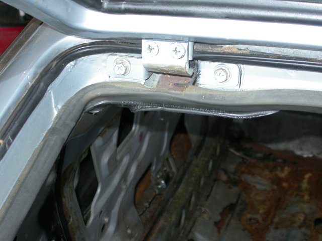

October 25, 200321 yr comment_54560 Here's the seals near the left hinge. The hinge had squashed the seal a bit, so I am not totaly convinced it is installed correctly. Link to comment https://www.classiczcars.com/forums/topic/8518-hatch-seals/#findComment-54560 Share on other sites More sharing options...

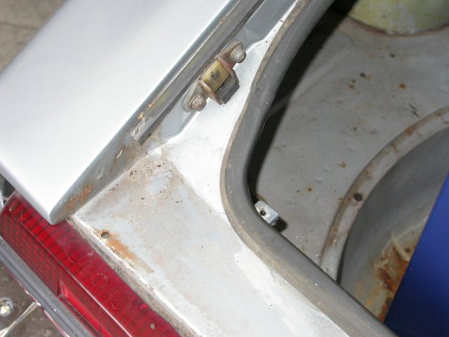

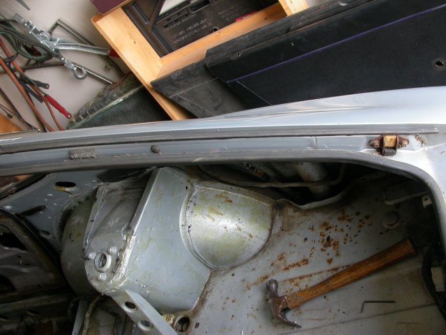

October 25, 200321 yr comment_54561 Here's the last one that shows anything different. Good luck. Link to comment https://www.classiczcars.com/forums/topic/8518-hatch-seals/#findComment-54561 Share on other sites More sharing options...
