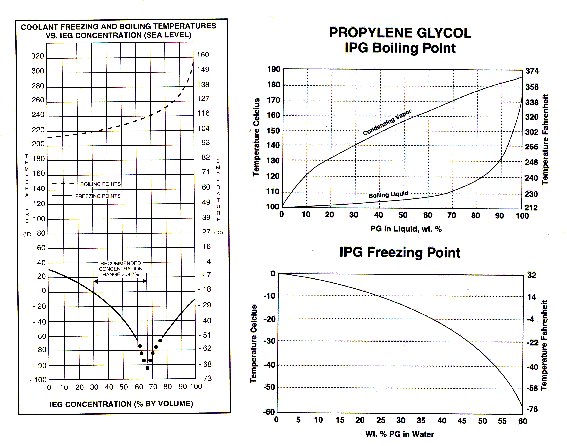

I give up. Nowhere can I find the freezing point of pure ethylene glycol. Even the handbook of Chemistry and Physics only lists the freezing point depression to 60% glycol. The only thing I did find was a very bad chart that indicates that the freezing point decreases to 67% and then rises again, which supports Daniel's contention. I stand corrected. The (very, very poor) graph is attached. The graph on the left seems to show the freezing point on the bottom curve, and the boiling point on the top curve as a function of the % glycol. Note that the article that I got this from was comparing ethylene and propylene glycol, and I think the left curve is ethylene, and the right two propylene.

.........The only thing I did find was a very bad chart that indicates that the freezing point decreases to 67% and then rises again, which supports Daniel's contention. I stand corrected. Anyway...

Daniel had stated that a 100% fill of antifreeze would freeze before a 50/50 mixture, and I had a hard time believing it. From the graph I found, and from the fact that several different antifreeze manufacturers state that they do not suggest more than 67% antifreeze, I conclude that he is right.

Originally posted by Daniel
For ethylene glycol the maximum protection is at 67% ethylene glycol in water. A ethylene glycol solution of this concentration will freeze at -84° F (pure ethylene glycol freezes at 8° F).
That data matches well with the graph I posted. So I guess it was the right graph! The quotation Daniel posted from Peak seems to synopsize most of our discussions well.
