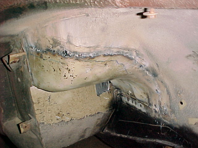

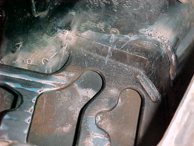

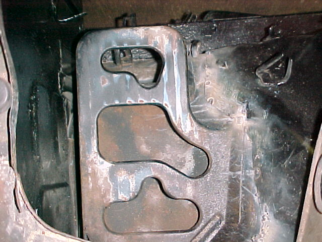

These will go up in the gallery however I thought I'd toss them up here for discussion.
These are pics of the donor battery well from Roger Schmidt at the Z barn. Cost was 122 bucks however he sends the entire corner from the strut tower back to the firewall section. It requires alot of cutting and fitting, however its an alternative to not having to custom fabricate something depending on the severity of your rust.

so the last things left to weld are the passenger floor support and the drivers side lower rear corner. Oh and a small spot in the firewall where the harness runs through on the passenger side. It started to rot out because of the battery well.
If I had an english wheel I would have no problem fabricating these patches so no more unfortunate Z cars have to be cut apart, however I guess in some form, the donor car is breathing life into another. :ermm:
