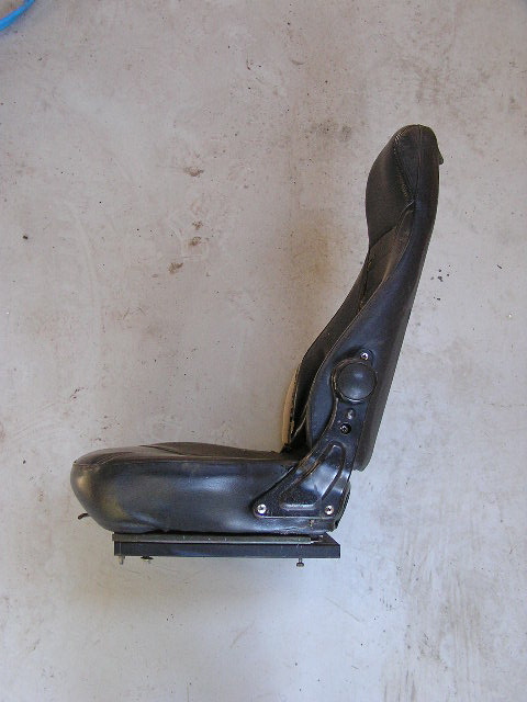

I just took the drivers seat out today adn I think this will give you a bit of extre height.
