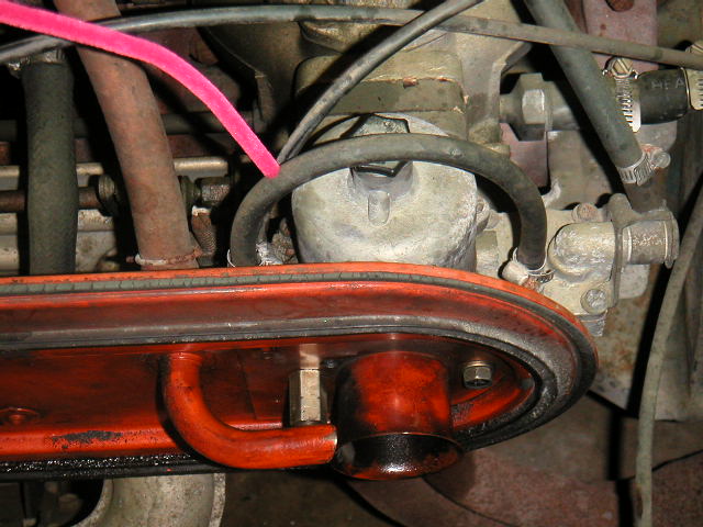

My 72 240 had su carbs , on the top of the carbs there are two hoses coming out one is from the fuel rail and the other goes to the factory aircleaner . When I try and start the car fuel pours from the rear carb where the hose goes into the aircleaner ,I have tried to insert a pic . not sure if it worked. These are the only to fuel style lines from the top of the carbs . And only the one closest to the fire wall is doing this . As a bit of info the car hasn't been ran in about two years , I just replaced all of the ingition and starter < thanks to all who helped with that issue> and does have the smog pump hooked up <which I want to remove with all that crap > Please any helps thanks Jeff
the vent (overflow) hose from the floats. check and readjust your float levels. make sure the system is working properly and its stopping the flow of fuel when your float reaches its stop point.

AND Open the bowls and see which style floats you have. If tyou have the loose, brass float, you may have a sunk one, where gas has seeped into the float enough to overflow the bowl.

I just saw your photo. 1972 3 screw carbs have the attached plastic float that is NOT prone to sinking. I'll bet you just need to clean the bowl jets.
No biggie-undo the fuel line, and remove the four screws on the bowl cover. When you lift the bowl cover off, the float should be attached. remove the float hinge pin and place pin and float aside. You will see the bowl jet in the cover. Remove it and clean it. What you may find is a piece of teflon thread sealing tape caught in the jet.
