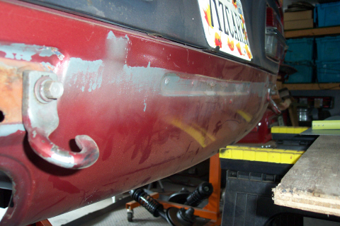

Posted September 25, 200321 yr comment_50853 I was reading (drooling) my fall issue of Sport Z. Checking out the centerfold (again). That beautiful Orange 1973Z up in Minnesota. :love: Anyway I noticed that there were some tow/tie down hooks by the rear bumper guards. Are these homemade? Or are they available some where? Link to comment https://www.classiczcars.com/forums/topic/8076-rear-towtie-down/ Share on other sites More sharing options...

September 25, 200321 yr comment_50864 If you are refering to the two hooks on either side beneath and behind the bumper, they are original equipment. They were used to tie the car down during shipping. They might have been removed from your car since they bolt on through the splash pan. On my 78 280Z there are three grade 12 bolts holding them on on each side. There are also two located in the front. If you look inside the fenderwell ahead of the tire, you will see them. I think all cars use some form of these. I have seen them used as a point to hook up a tow strap or chain. I personally wouldn't recommend that. Link to comment https://www.classiczcars.com/forums/topic/8076-rear-towtie-down/#findComment-50864 Share on other sites More sharing options...
September 25, 200321 yr comment_50870 Ed.. to answer you're question... I have no clue since I haven't seen the picture... sorry:classic: Sblake01... The hooks you're referring to (might be the same as Ed, IDK?) They are on most if not all uni-body cars (like the Z). These are used for tie downs when the car is on a truck or boat for shipping. Since the cars do not have frames they need some place to secure the car and wrapping a chain around suspension parts just isn't an option. If you notice a car hauler you will see what I'm talking about... they wrench the chains down tight to compress the suspension so that the car doesn't bounce every time the truck hits a bump.Nate :cross-eye Link to comment https://www.classiczcars.com/forums/topic/8076-rear-towtie-down/#findComment-50870 Share on other sites More sharing options...

September 25, 200321 yr comment_50876 I bought my 73' Z from a guy in Arizona. I decided to ship it to Dallas so my Dad could check it out. The guy who hauled it used the hooks on the back bumper to strap it down. When I got the car back into Houston, I noticed that the bumper was pulled down on both sides (more on the right than the left). It turns out, the guy strapped my car down with a chain, which left marks on the rear valence (behind the gas tank) and used so much torque it bent the ends of the frame rails and the sheet metal where the bumper is attached. This would have been covered by insurance, but when it was delivered, my Father didn't notice the damage.I think these hooks were really meant to keep the cars from rolling around when being shipped from Japan and not really meant to have so much torque on them as to compress the suspension in the rear of the car.I'm sure I have some pictures of the damage somewhere. I'll post them if I find them. Link to comment https://www.classiczcars.com/forums/topic/8076-rear-towtie-down/#findComment-50876 Share on other sites More sharing options...
September 25, 200321 yr comment_50878 Here's what the rear hooks on the early cars looks like. They are the same on both sides, unlike the front which has a hook on one side and a closed loop on the other. They are a mirror image of one another, so there is a right and a left. The later cars, used a closed loop similar to the one found on the front, it was an "L" shaped piece of flat stock with a closed loop. I think they changed to this type when they went to the larger bumpers... probably beginning with the 74 1/2 260 in the US. I use mine to pick up the chassis shell with an engine hoist so I could get the shell up high enough to work under... no problem as long as you don't have the running gear in the car.... Link to comment https://www.classiczcars.com/forums/topic/8076-rear-towtie-down/#findComment-50878 Share on other sites More sharing options...
