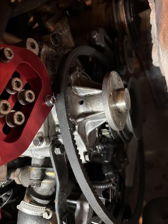

My water pump seems pretty new (3y)
The pulley was a bit too stiff when I take it out.
May be it has worn out the bearings (?)
That pulley should spin without any tension IMO. Is that Ac I see in the background hooked up during testing?
