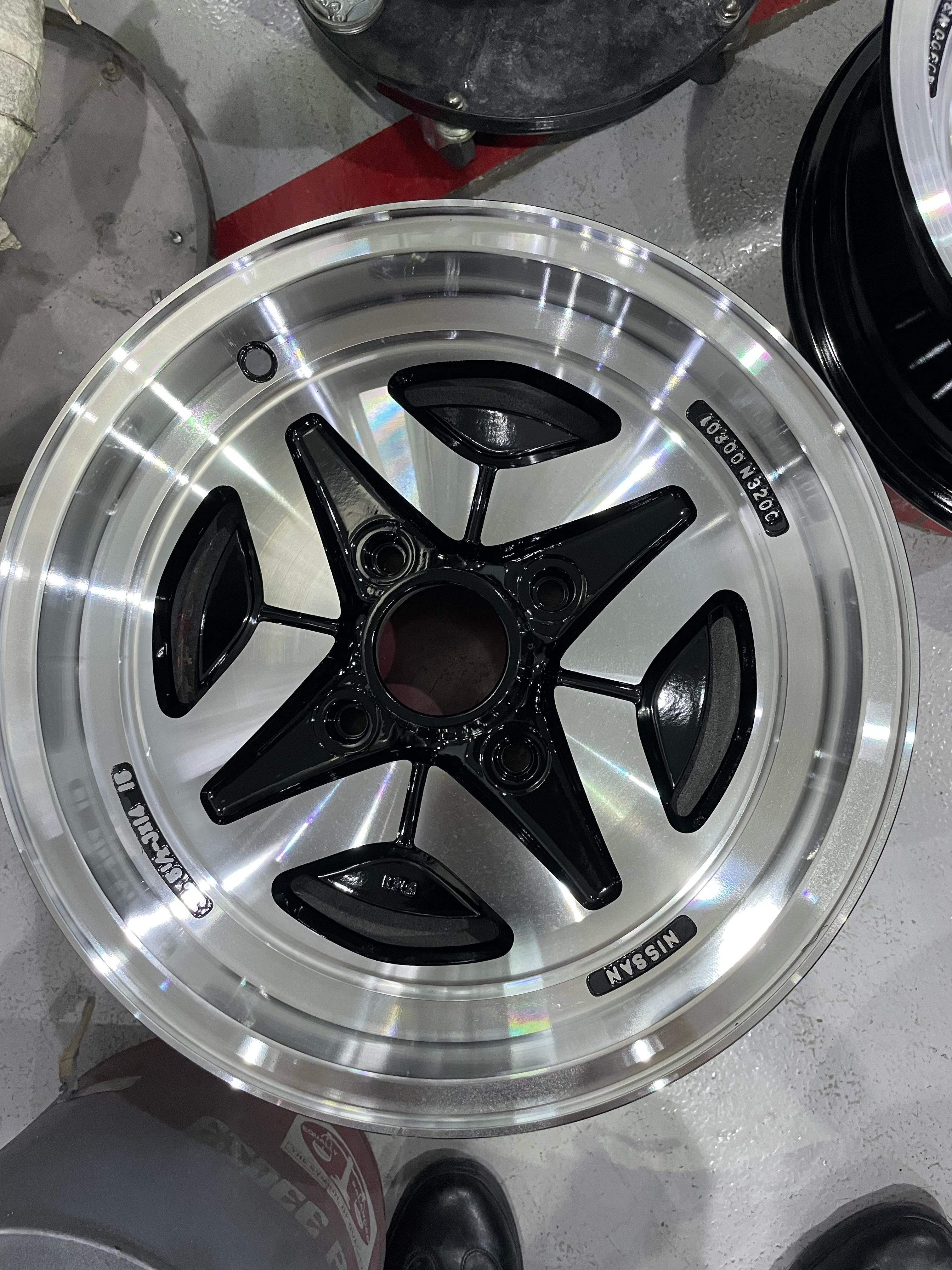

I have a stock standard 1977 280z.
I have purchased and reconditioned a set of 14x5.5 Nissan alloys (see pictures).
I live in Qatar so tire choices are extremely limited. I can get some basic Yokohama ES32 in 195/70R14 if I want a stock black wall look.
However I am tempted to import some BF Goodrich Radial TA's in either 225/60R14 or 205/70R14 at 4 x times the cost - because I love the look.
My question is that with 5.5 inch wide alloys can I definitely get away with the 225/60s (which have a similar circumference to stock) or do I have to go with the 205/70s (which have a taller/larger circumference)?
I have read a lot of people saying that 225s are OK, however I worry that they have 6 inch wheels not 5.5. At 4 x the price of the tires I can get locally I really don't want to get it wrong.
Thank you for your help (and please feel free to share pictures in your response).

I know these datsun 260z rims quite well and i would never go over 195/70R14 tires on these!! The 280zx has 6 inch wide rims and 195/70R14 tires on!
The standard on 5,5 Inch rims is 185 and max 195 i would advice you!
Best drive would be i think the todays 185/60R14 but then it leaves a bit of open wheelhousing..
I would prefer a good ride above a good LOOK! ;-)

I have a set of aftermarket wheels on my 1977 280z with 195/70R14 front and 225/60R14 rear and I really don’t advise going over 195 front as the steering becomes very difficult.
I do have the original wheels (same as you have) but I don’t know what the tire size is on those.
