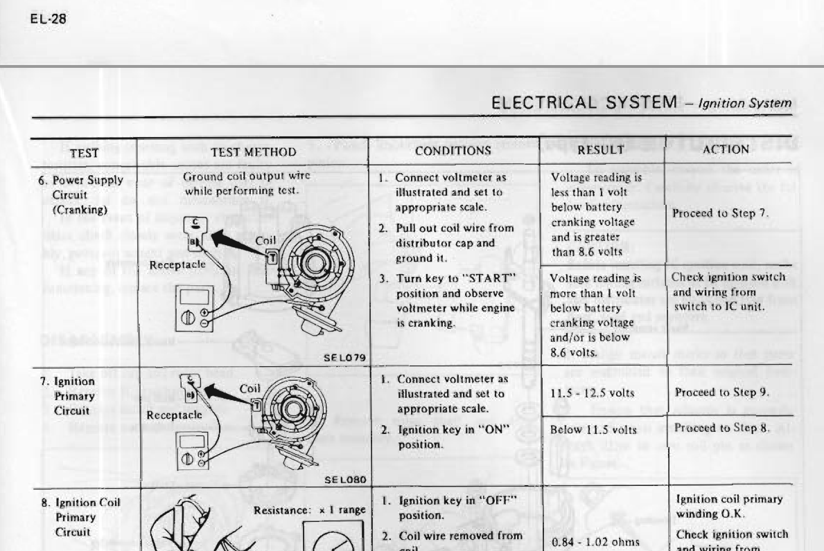

Fair enough. Not by the car now but tried starter fluid yesterday and it didn't do anything. All the tests at the ECU checked out except the voltage test for the air regulator on pin 21 so I know I probably need to do some harness tracing. Do you know of any tests for the icm? The coil seems fine but I'll probably just buy a new coil since they're not to expensive just to make sure it's not that.
I should have mentioned the distributor itself also. They are known for worn bushings allowing the reluctor wheel to contact the stator ring, breaking things. If it won't start with fluid, it's not going to start with gasoline.
Good old Blue wrote up a thing about them. The magnetic pickup can fail, there's a test for that. The air gap can be off, there's a measurement for that. Described in the Electrical chapter.

Good call was finally able to get back to the car, the rotor bushing in the distributor seems shot now, it's just like the picture in the link. Anything I can do to fix that without buying new?
Sorry meant to quote the air gap, link is the refurb it seems so I reckon I'll read threw it and try a repair
ZCarDepot has been good at sourcing parts. He shows a pickup coil for a ZX. The other parts are hard to find though. I've seen the bushings for sale in the past but not recently. Might be simpler to put in a 240Z distributor with a Pertronix conversion. Or a 280Z with an HEI module.
