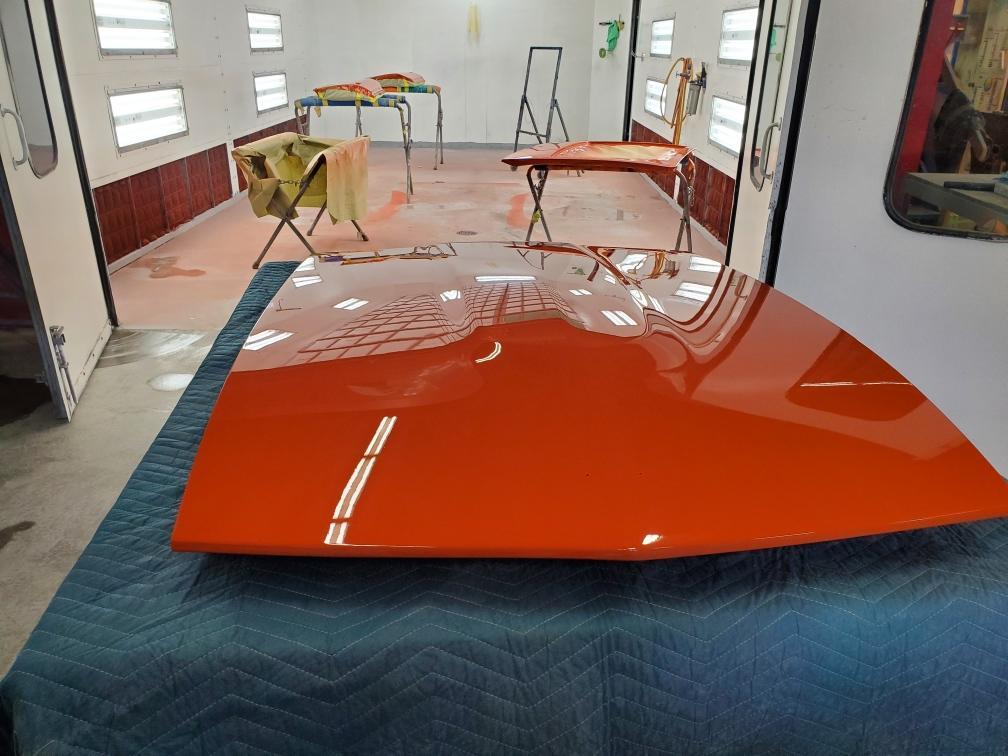

By Springtime of 2024, a local bodyshop had changed hands. I knew the guy. I asked if he could get me in! I was the first one in the new clean paint booth.
He said, I'm gonna do it my way! Okay, do it! Another 6 grand later......oh well, I past the point of no return awhile ago.
Looks red from the lighting, but it's really 918 orange
Damn!

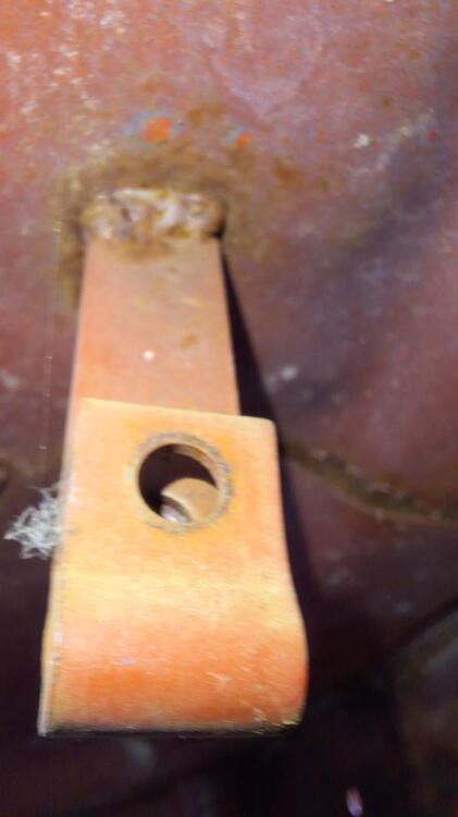

Now there's 3 different gas pedals that I know of, there's at least 2 types of throttle control cable brackets. I think the earliest type of bracket and pedal are what I found on car #1042, the wrecked green, red and white car.
The bead blasted (top) one, came from 1/70 car.
The bottom one came from 6/71 (my car)
The middle one came from in between. It goes with this bracket that Jenny removed from one of her cars.
throttle bracket jenny.jpgthrottle bracket jen3.jpgthrottle bracket jen2.jpg
This bracket is a beefed up version of the first version which clearly failed. What I learned was the original alignment of the cable bracket welded on the bulkhead to the pedal tab (the cable hooks to) is offset.
I installed the pedal on 1042 and noticed this. I measured her measurements and mocked up her bracket on my car. I get the same offset. I consulted with Patcon ... again, he's been such a big help. We agreed that I should line it up! Now I was adamant about restoring this car to exactly original state, but......this is one thing I'm going to add. Because of cooler temperatures here in Montana, I thought it would be nice for warming up the car. Plus, it's cool.
