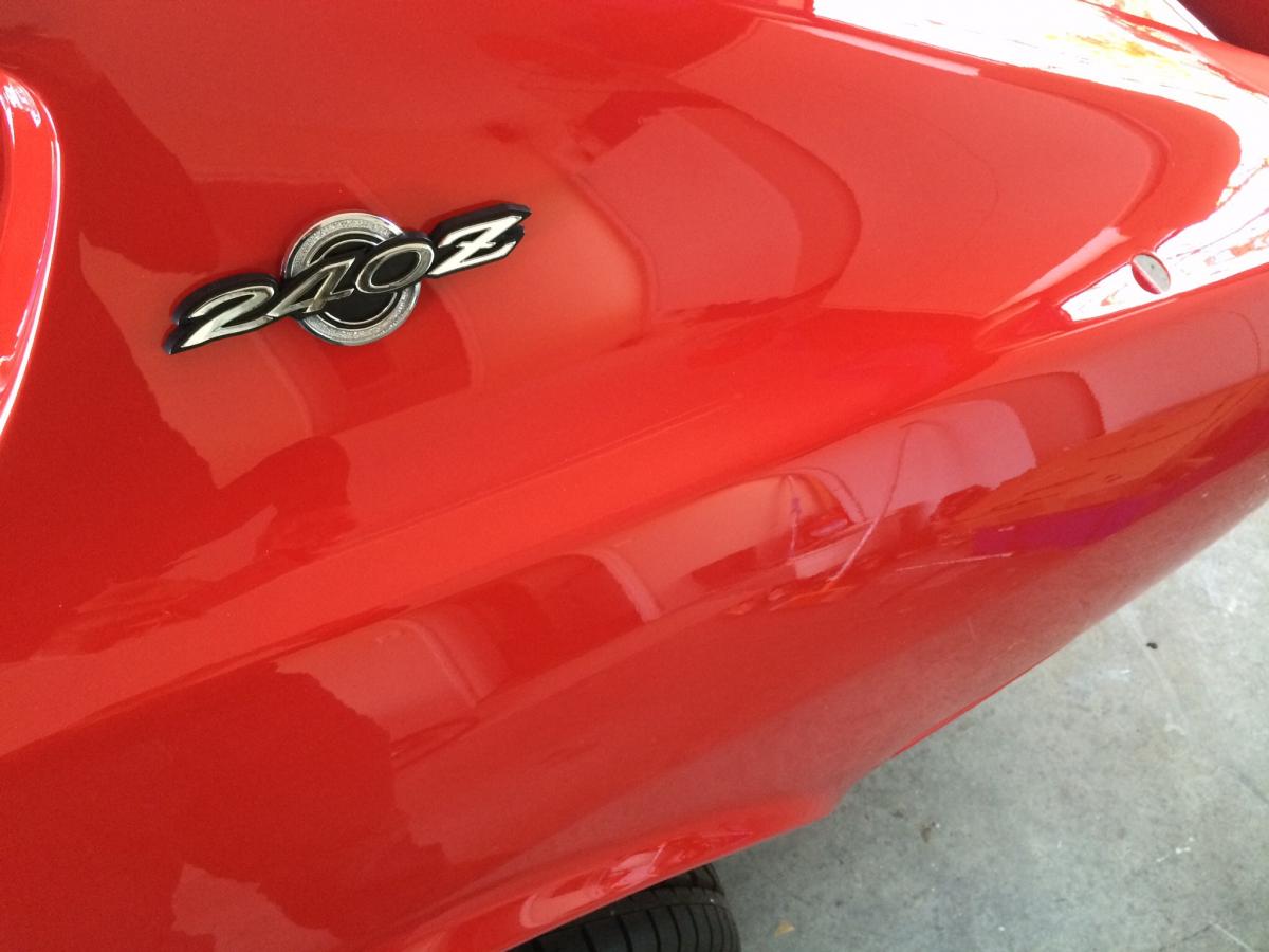

September 4, 20159 yr Author comment_476982 Wow, just read this first thread from many many years ago. Here's an undated pic. Link to comment https://www.classiczcars.com/forums/topic/6908-help-needed-alan-hs-30-h/?&page=4#findComment-476982 Share on other sites More sharing options...
September 4, 20159 yr comment_477001 How about a photo of the whole car? Link to comment https://www.classiczcars.com/forums/topic/6908-help-needed-alan-hs-30-h/?&page=4#findComment-477001 Share on other sites More sharing options...
September 5, 20159 yr Author comment_477031 I'll start a build thread. Link to comment https://www.classiczcars.com/forums/topic/6908-help-needed-alan-hs-30-h/?&page=4#findComment-477031 Share on other sites More sharing options...
