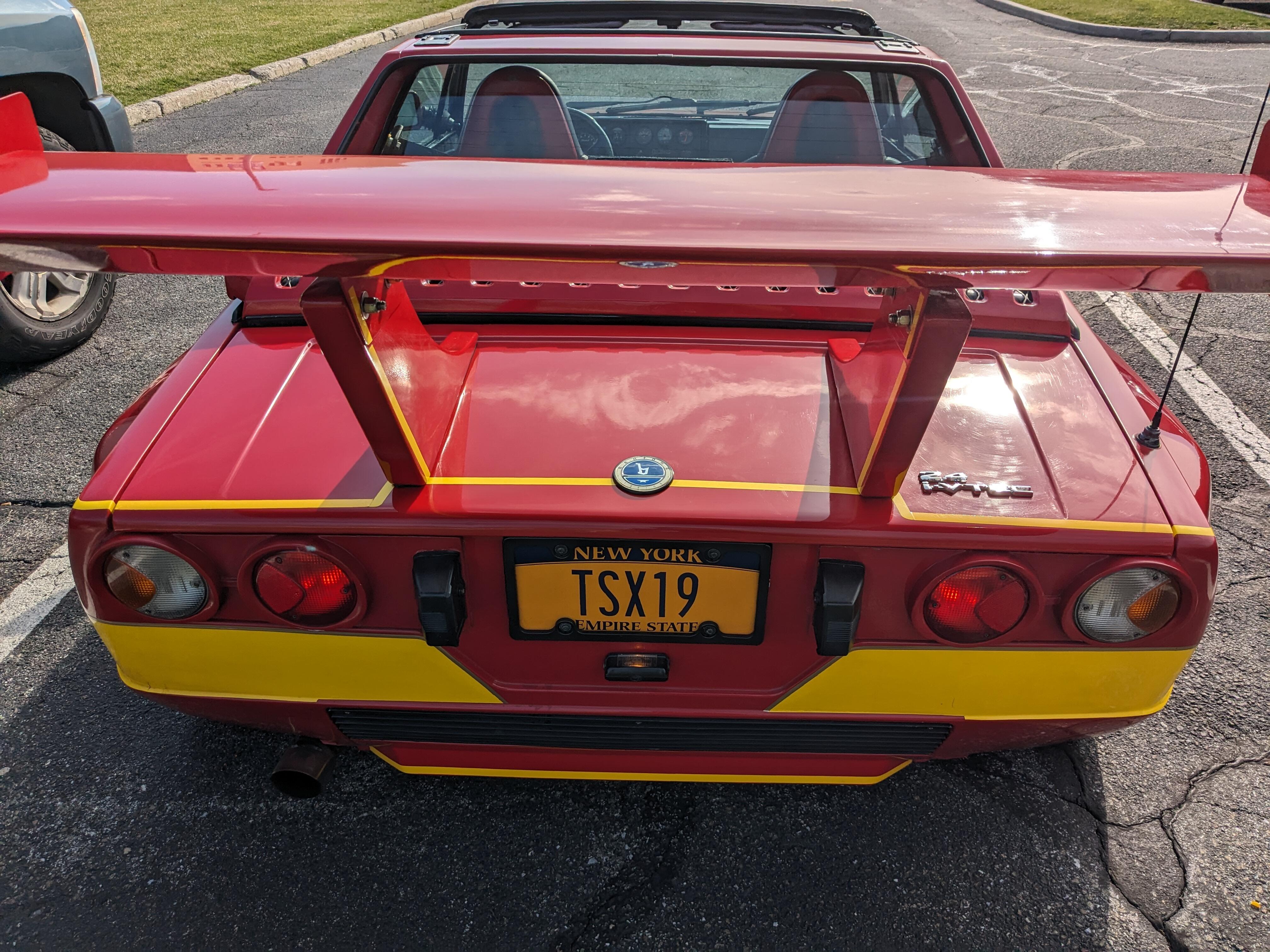

Today on my lunch break I ran the thin 3M tape down the fender, around the nose and back up to the pass door edge.
I think it looks OK without the wide stripe on the nose, at least I feel that way today....
After school I removed the spoiler, located the correct push pins & primed & painted them to match. I don't like them standing out more than necessary.

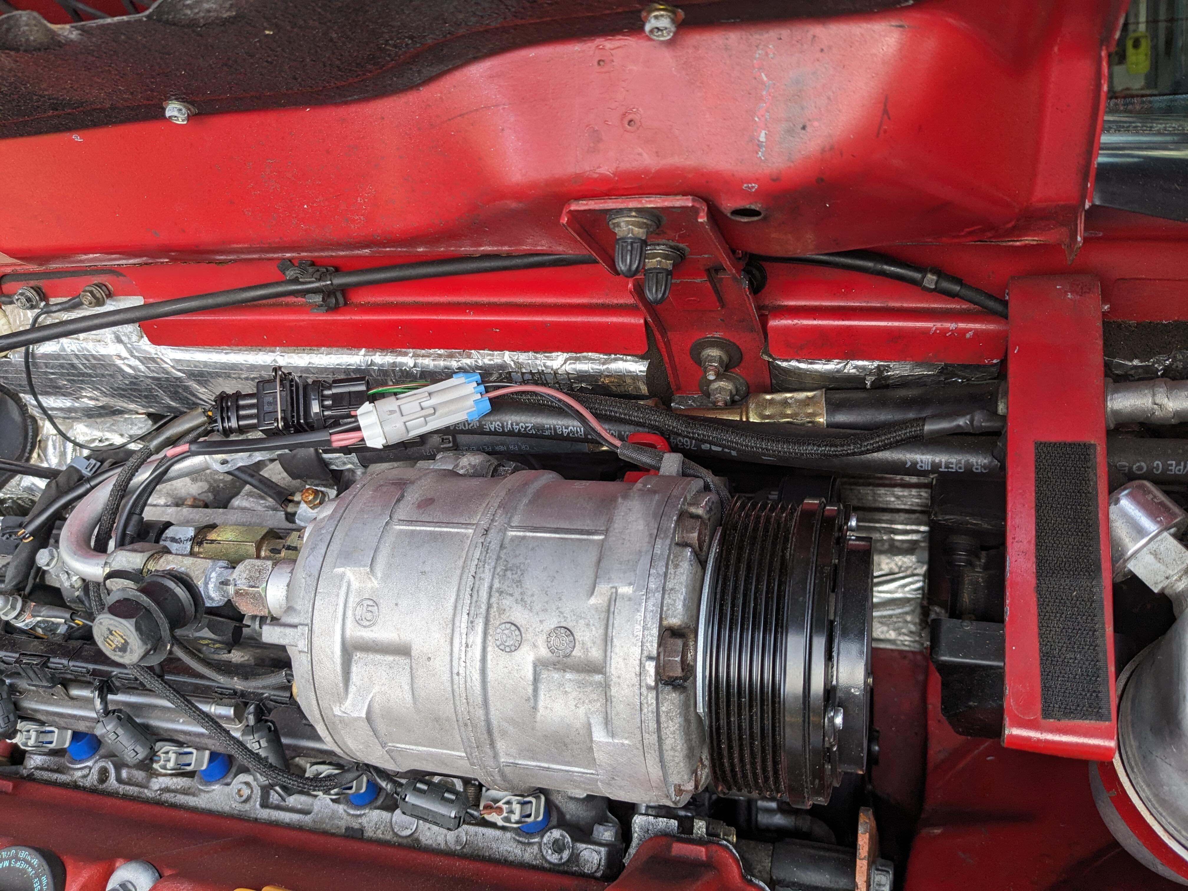

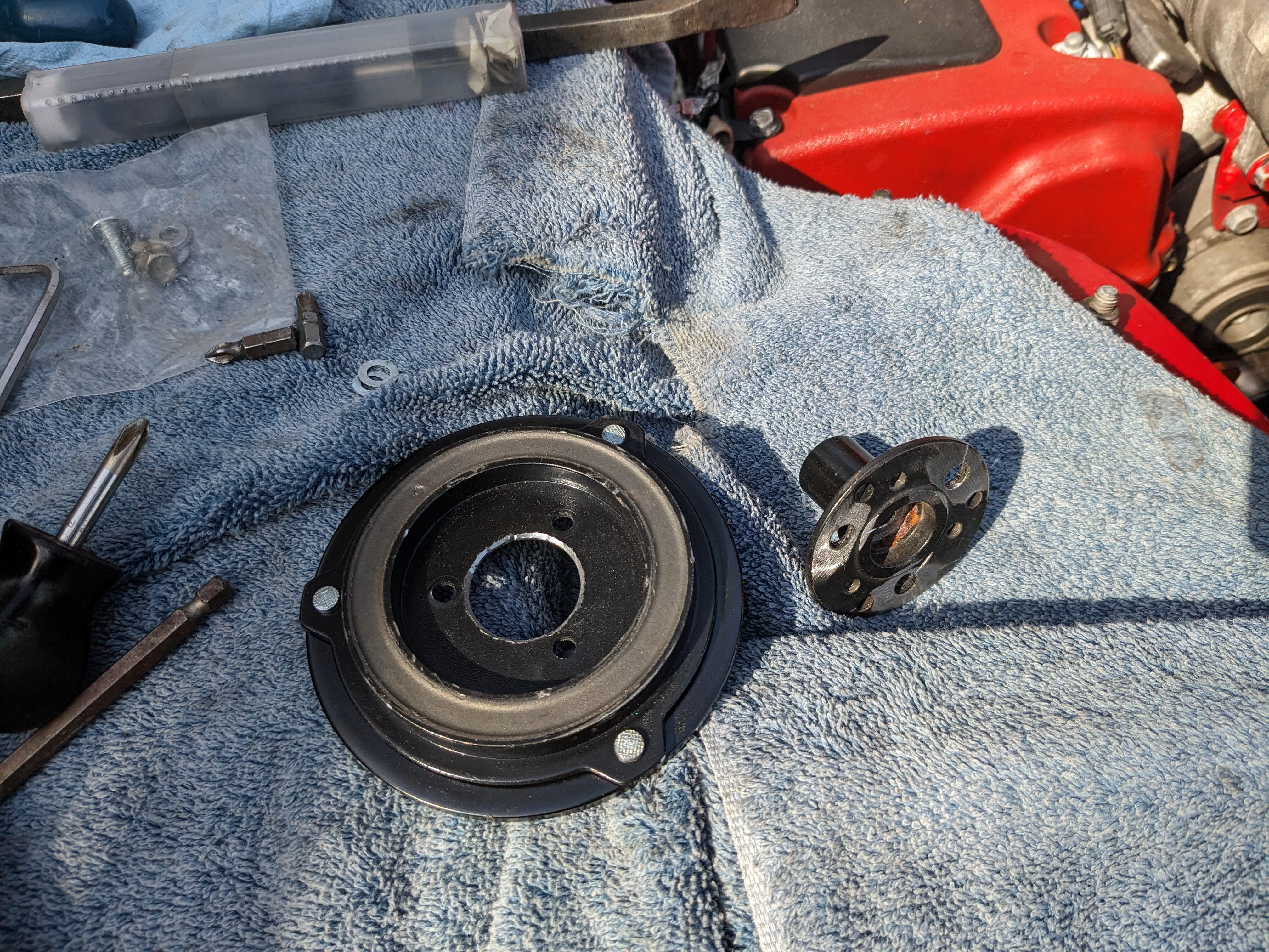

Replaced the ac clutch today. I bought one meant for a Mini, so I had to change the harness connection, and modify the outer magnet plate hub, the Mini version had a smaller OD compressor shaft. Also had to redrill the magnet mounting plate. Why might ask why go to all the bother, it was because the Volvo factory clutch is over $250, if you can find one, vs. $50 for any number of readily available sanden clutches . When I looked online, for ones that might fix the Volvo DCH compressor, I was focused on the bearing depth and dimensions.
New belt length is (6PK)1650, 25mm shorter due to reduced OD of the pulley.
Took some back & forth to get the plate clearance in the .010-.015" clearance range. Fortunately I had a stash of M4 stainless washers

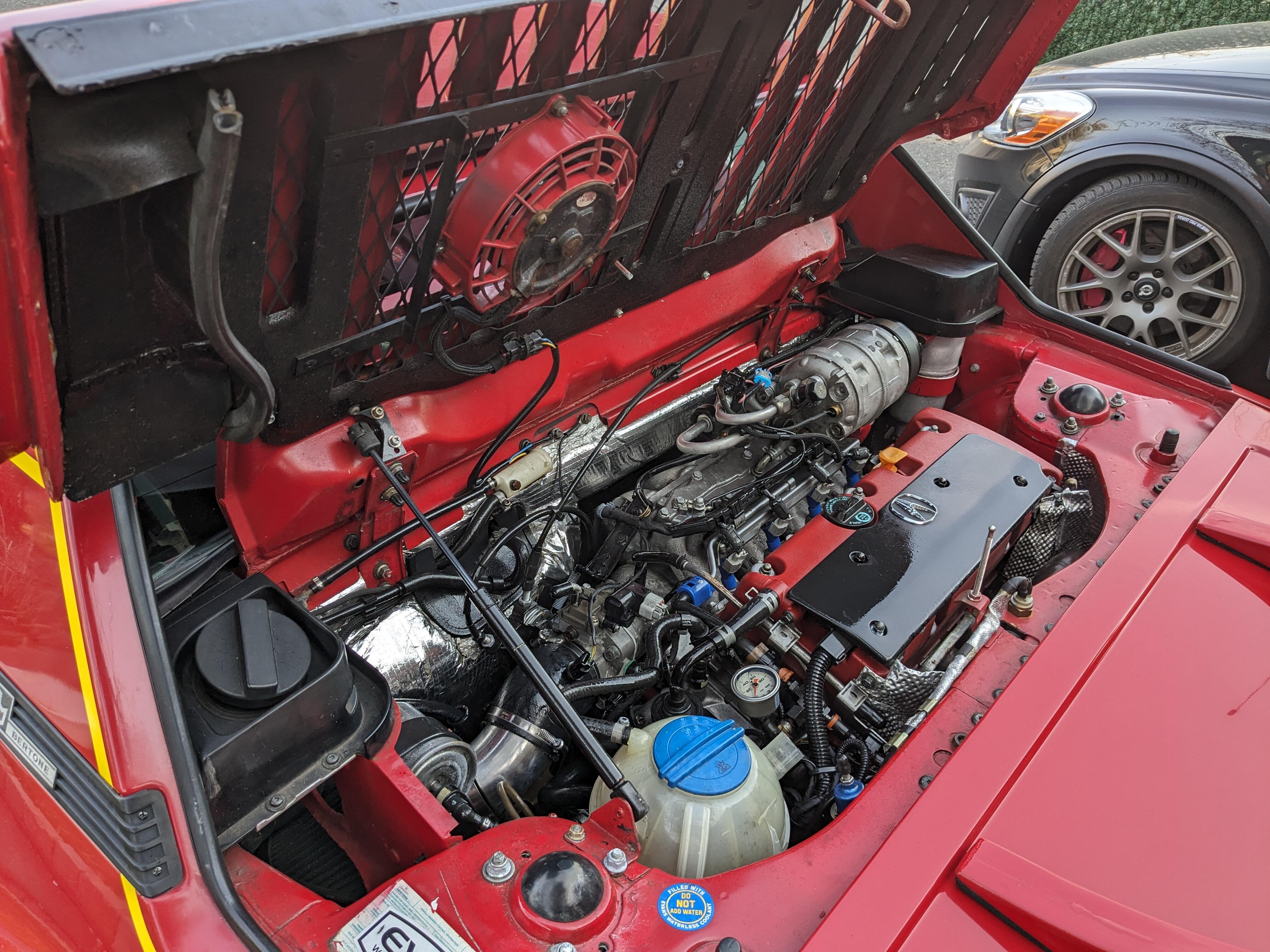

Engine bay needs some detailing, the body shop left my car out in the rain, uncovered when they had it last fall. I NEVER did that - if it ever got wet, I drove it until it was dry back there.PXL_20240314_215456885.jpg

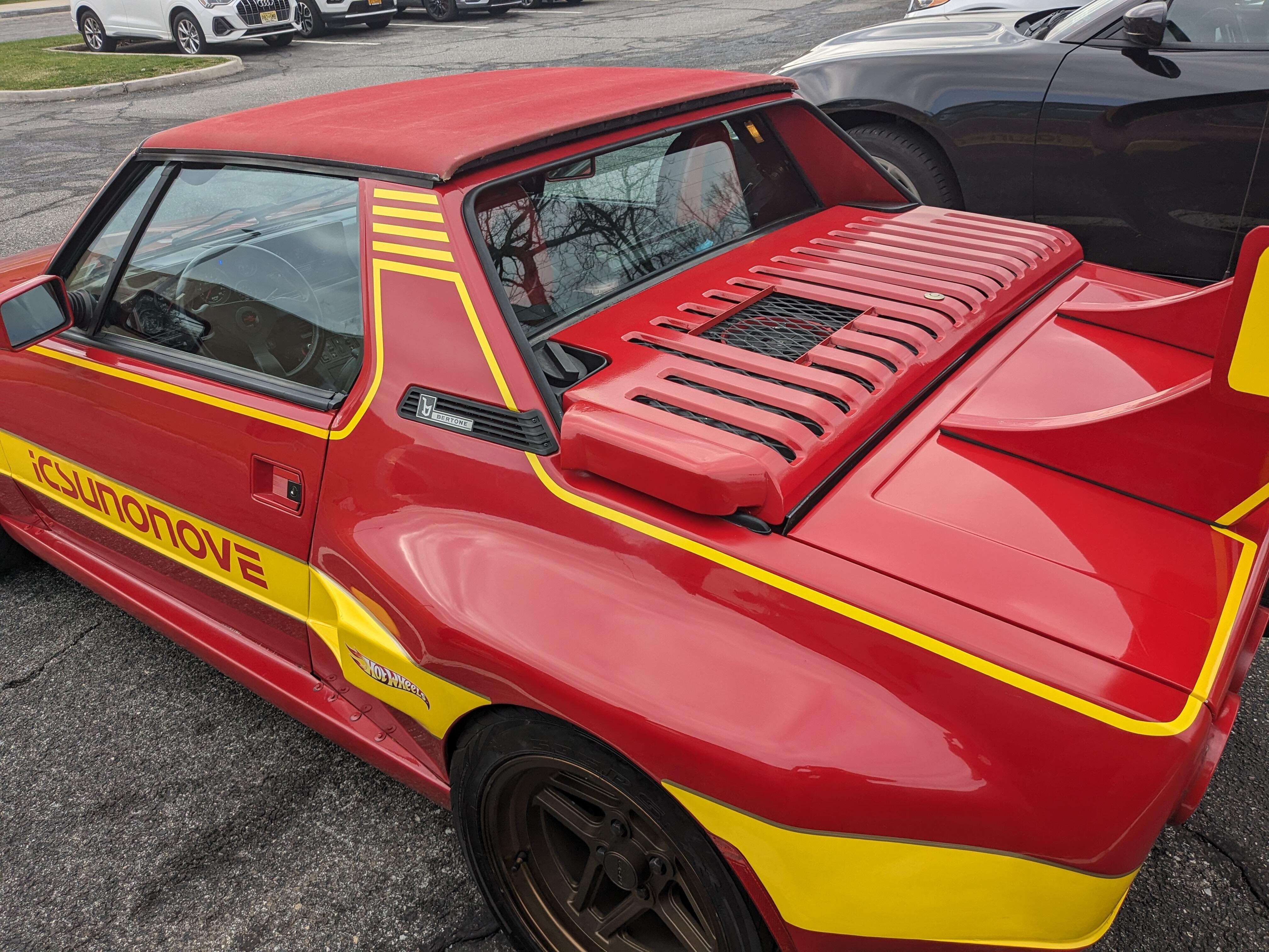

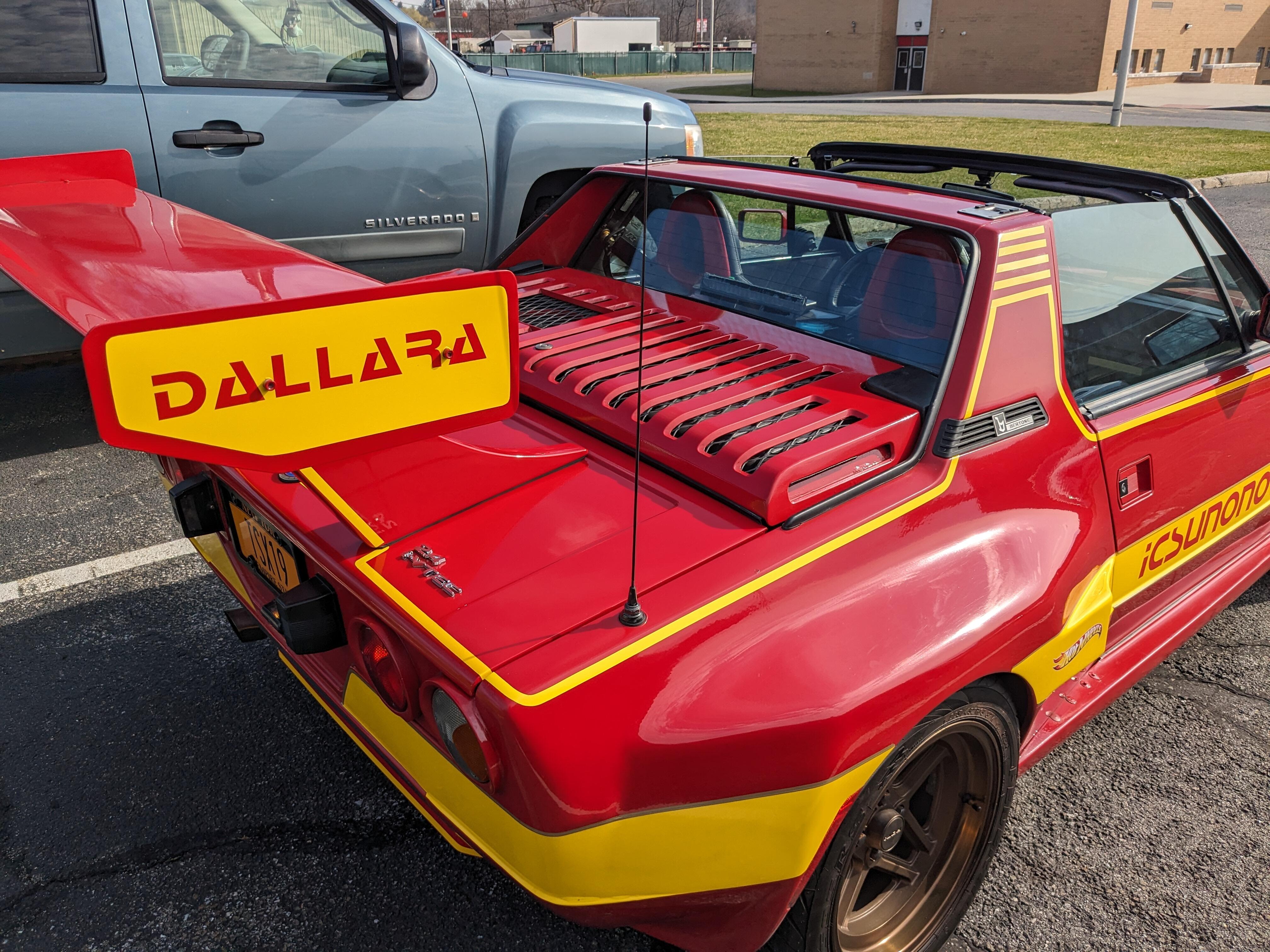

Removed and remade the targa, 1/4 and trunk striping - the coating on it had peeled since I last did them, 3M tape too.

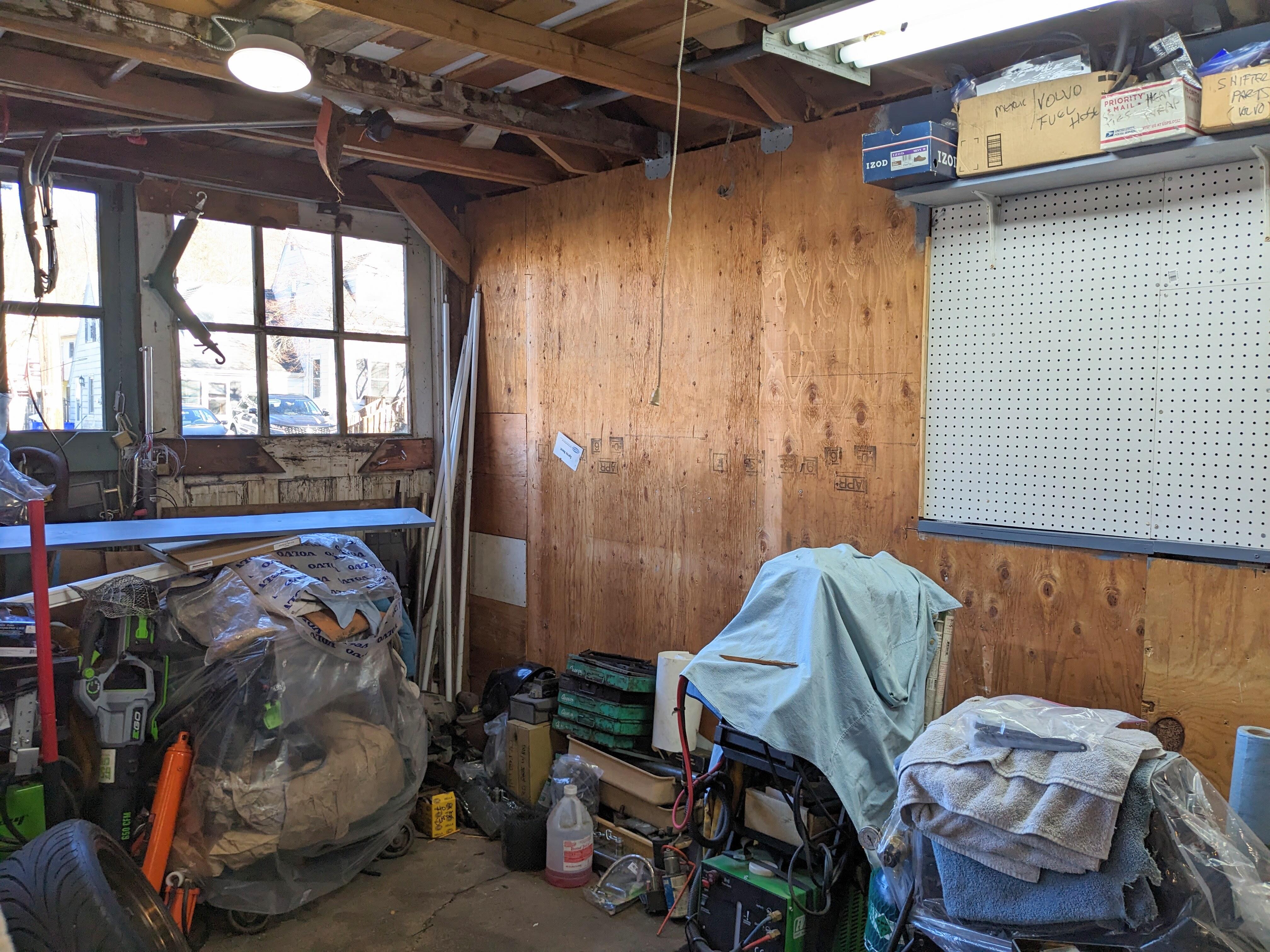

My back has been bothering me for several weeks, so nothing going on with the garage. I felt well enough Thursday to get a little forward movement. Good job I was going to the chiropractor Friday  AM, 'cos my back told  me I shouldn't have. Yanking the nails was what tugged on my lower back, mostly.
Anyway, cut out the sheathing, added insulation & fitted the uppermost shelf. I'll finish the shelf brackets after I do the pegboard.

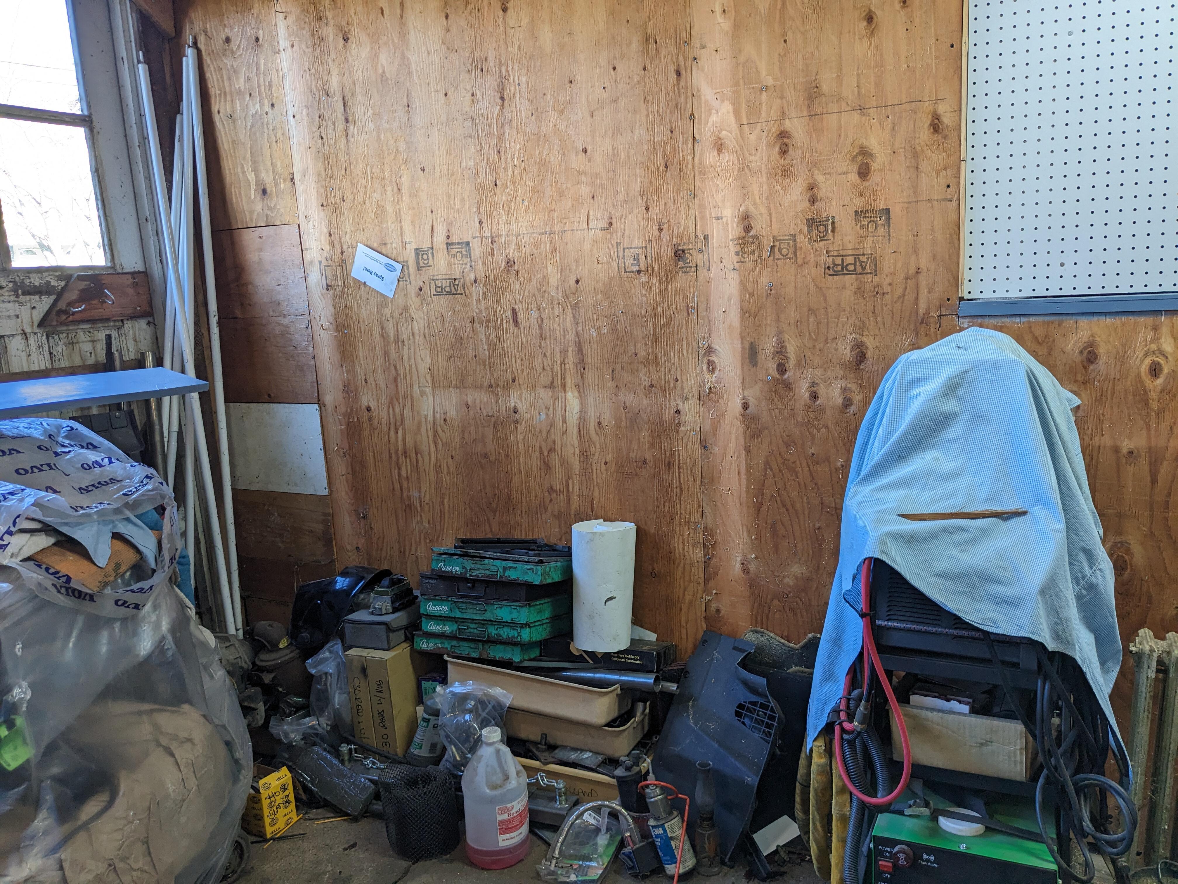

Yesterday  I removed the lower sheathing. Sill plate is in really bad shape at this end
excavated more of the soil outside, made a more complete trench to keep water off the sill/wall until I get to finish the drainage and sill/wall, it's supposed to rain all day today
Added some wood to the outside, to keep the elements out. it was in the low 30's, so very cold
Have to figure out how to jack up the wall so I can get the bad sill out.

A bad back is no fun!
If the rafters and celing joist are tied to the wall plate well enough, you can setup a temporary wall inside the existing wall about 12-16". Use bottle jacks and temp posts to jack up the ceiling structure.  It should take the wall with it. Be sure you have all the studs free from the plate. You dont need a lot of movement to have enough gap. You may have to replace the sill on shorter sections to get it in there.
