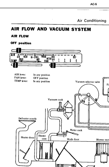

Nissan used a vacuum-controlled shutoff valve in their 280Z's.  Completely blocked coolant flow through the heater core.  Your Bronco valve combines the function of the vacuum cokc and the water cokc.
