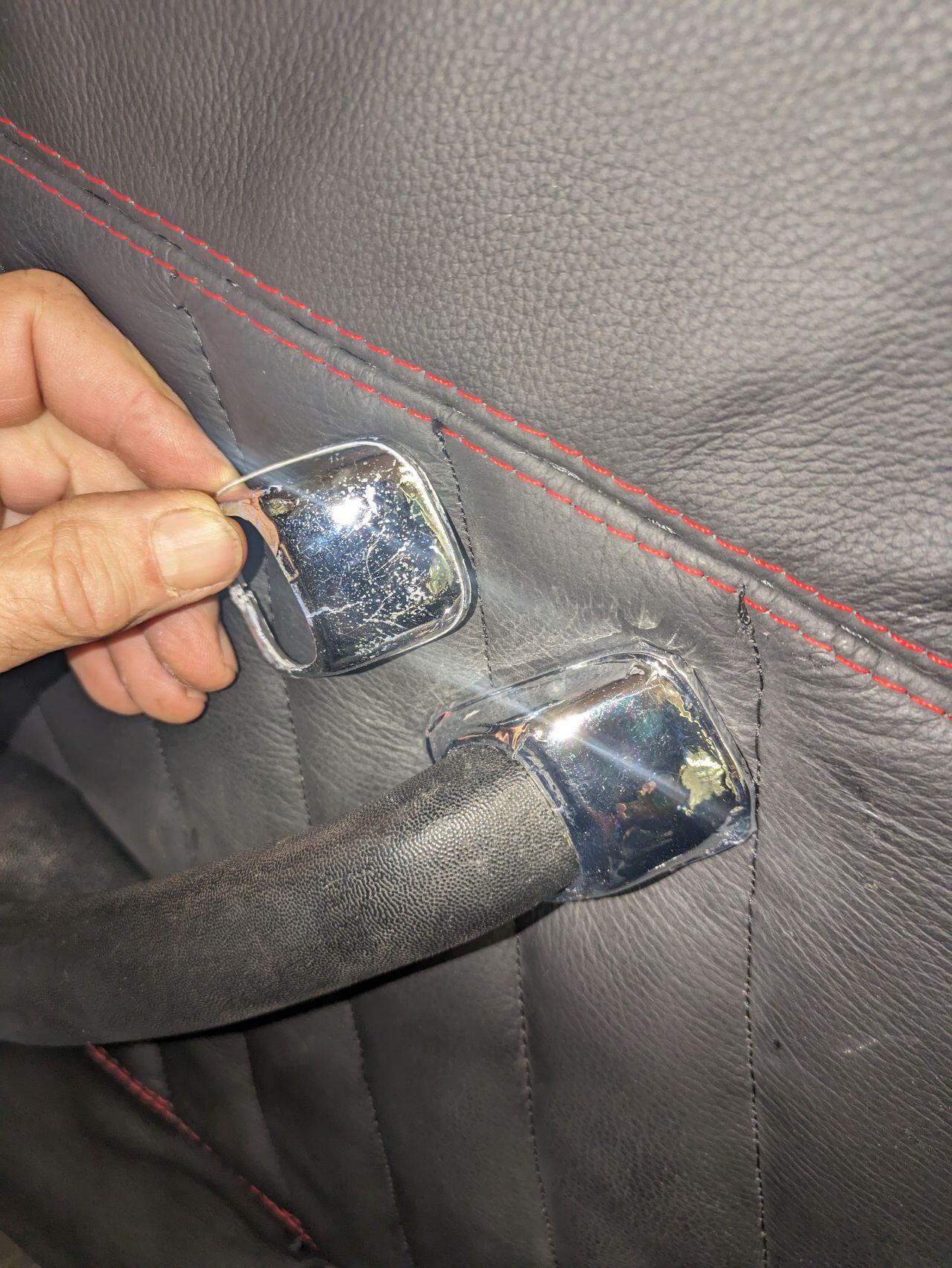

OK, not prefect but close. I'll post the obj file tomorrow if anyone wants to make one or two. I printed it in PLA, sanded it, sprayed it with a few layers of gloss, then stretched chrome vinyl film over it. I will print the next one in ABS because this one warped a little when I heated up the vinyl wrap to stretch it.
The photo shows the original one in my hand and the printed one installed. It looks like a chip is missing in the printed one but that's just some strange reflection.
