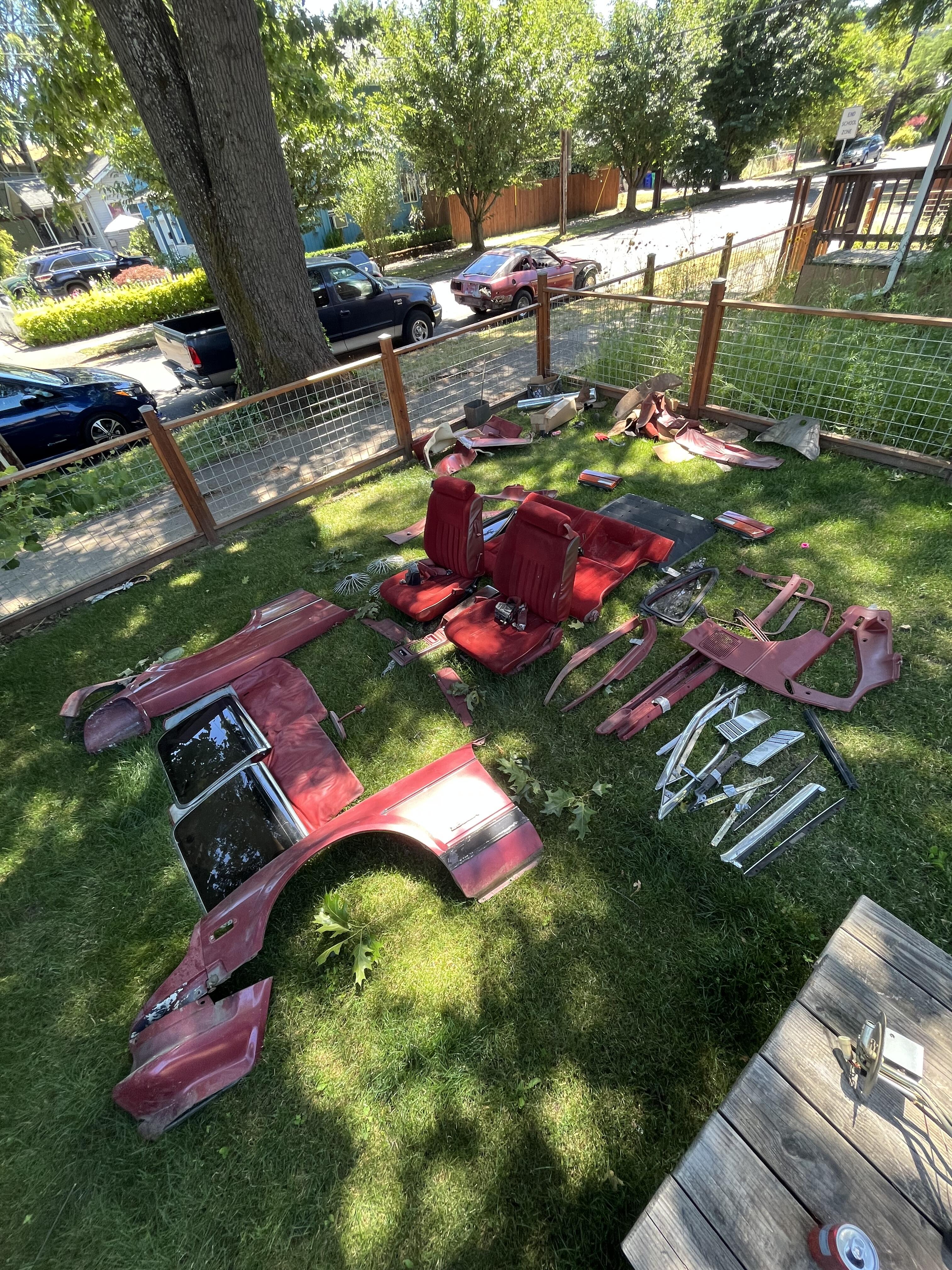

July 31, 20232 yr comment_655551 Keep everything from the parts car! Parts are hard and expensive to find. Gut the interior, especially if its the same color as your car. Gut the HVAC, there is a resistor pack for blower speed that is mounted to the blower housing that is impossible to find if yours dies. You cant get the vacuum motors, that control where the air flows from the dash. Keep all the gauges. Keep the weather strip that is on the doors. It is NLA and no one makes the stuff yet. Pull it all and put it in totes. Keep the outside mirrors for when yours dont work anymore. Keep the steering column cover and all of the wiper/headlight/curze control/ blinker stuff that is in the column cover. Keep all of the control modules that are under the carpet. Keep the curze control actuator/cable that is in the engine bay. Keep the engine and all of the electronics. Keep the distributor. Pull the EFI wire harness and put it away. Keep the ECU. Keep the door glass. IF the windshield is good try and get it out and keep it (you cant get a new replacement). $^!# just keep the entire car if you can. There is so much that you cant get anymore!!!! I would go back to a stock exhaust manifold and skip the header. The manifold off the spare car will be the same. The O2 sensor that you installed will not help the performance of the car. The ECU is designed for a narrow band O2 sensor. The ECU wont know what do do with the signal from a wide band Sensor. The car will run without the O2 sensor connected. The O2 sensor has a very small part in the ECU calculation for fuel. Get a correct sensorĀ The screws on the AFM that you adjusted are for air/Fuel ratio at idle only. Places that are overlooked for vacuum leaks are dipstick, oil filler cap, Power brake booster, vacuum advance canister (if the diaphragm is bad) and the PCV system. Link to comment https://www.classiczcars.com/forums/topic/68473-1977-280z-efi-baseline-settings/?&page=2#findComment-655551 Share on other sites More sharing options...

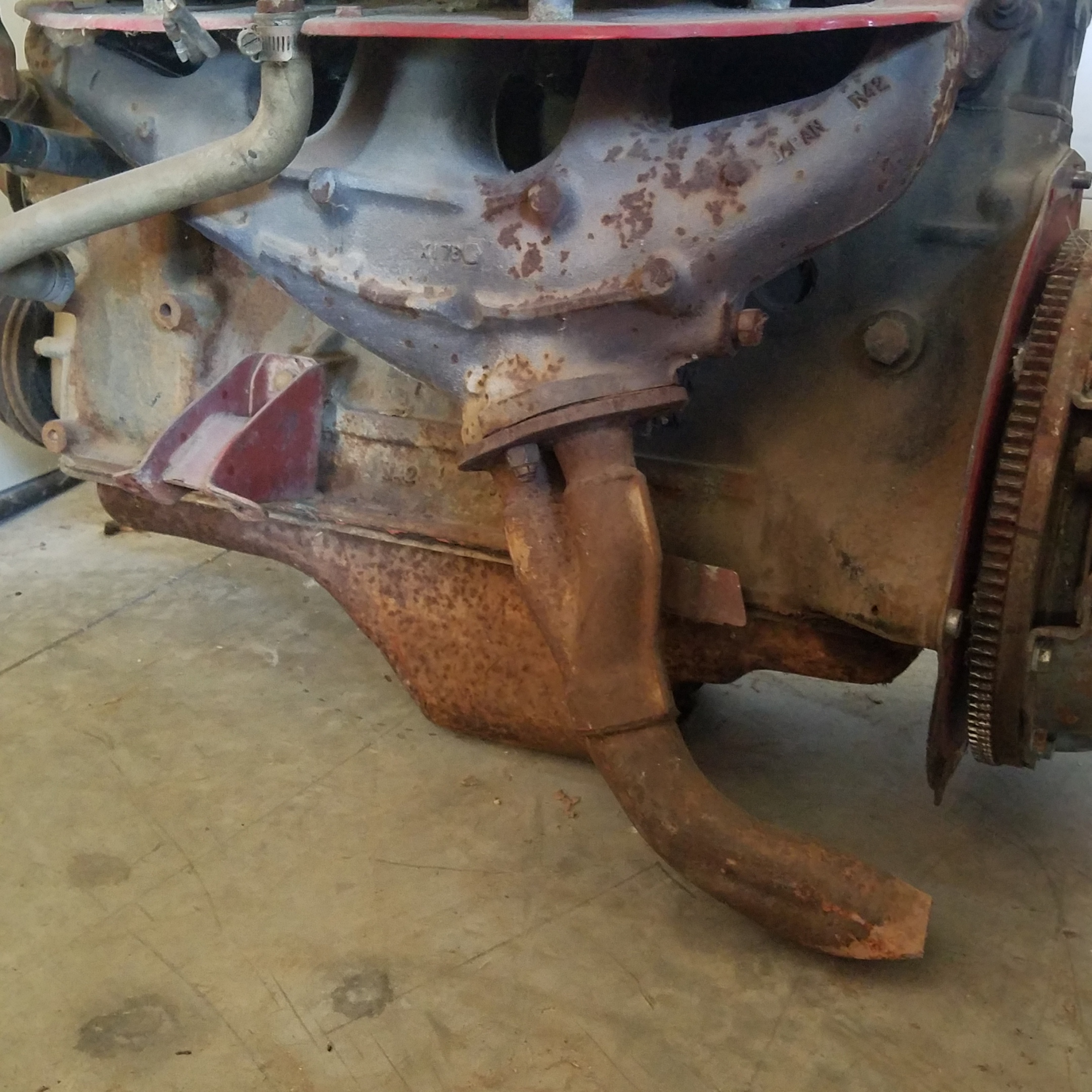

August 2, 20232 yr comment_655595 I will swap you the exhast manifold for the ECU and the EFI wire harness if the harness has not been cut. It can be removed in about 20 minutes. 99% of the wire is on the drivers side with one wire crossing over to the passenger side. That one wire follows the firewall and ends up near the battery. Link to comment https://www.classiczcars.com/forums/topic/68473-1977-280z-efi-baseline-settings/?&page=2#findComment-655595 Share on other sites More sharing options...
August 2, 20232 yr Author comment_655600 Do you have the Downpipe as well? Link to comment https://www.classiczcars.com/forums/topic/68473-1977-280z-efi-baseline-settings/?&page=2#findComment-655600 Share on other sites More sharing options...
August 2, 20232 yr comment_655602 I have part of it. I will post a picture of what I have when I get home. Working nights. It is all still on the engine. Edited August 2, 20232 yr by kickstand80 Link to comment https://www.classiczcars.com/forums/topic/68473-1977-280z-efi-baseline-settings/?&page=2#findComment-655602 Share on other sites More sharing options...
August 2, 20232 yr comment_655605 One of the Y pipe bolts is broke off. Link to comment https://www.classiczcars.com/forums/topic/68473-1977-280z-efi-baseline-settings/?&page=2#findComment-655605 Share on other sites More sharing options...
August 2, 20232 yr comment_655608 Par for the course. Very common problemĀ Link to comment https://www.classiczcars.com/forums/topic/68473-1977-280z-efi-baseline-settings/?&page=2#findComment-655608 Share on other sites More sharing options...
