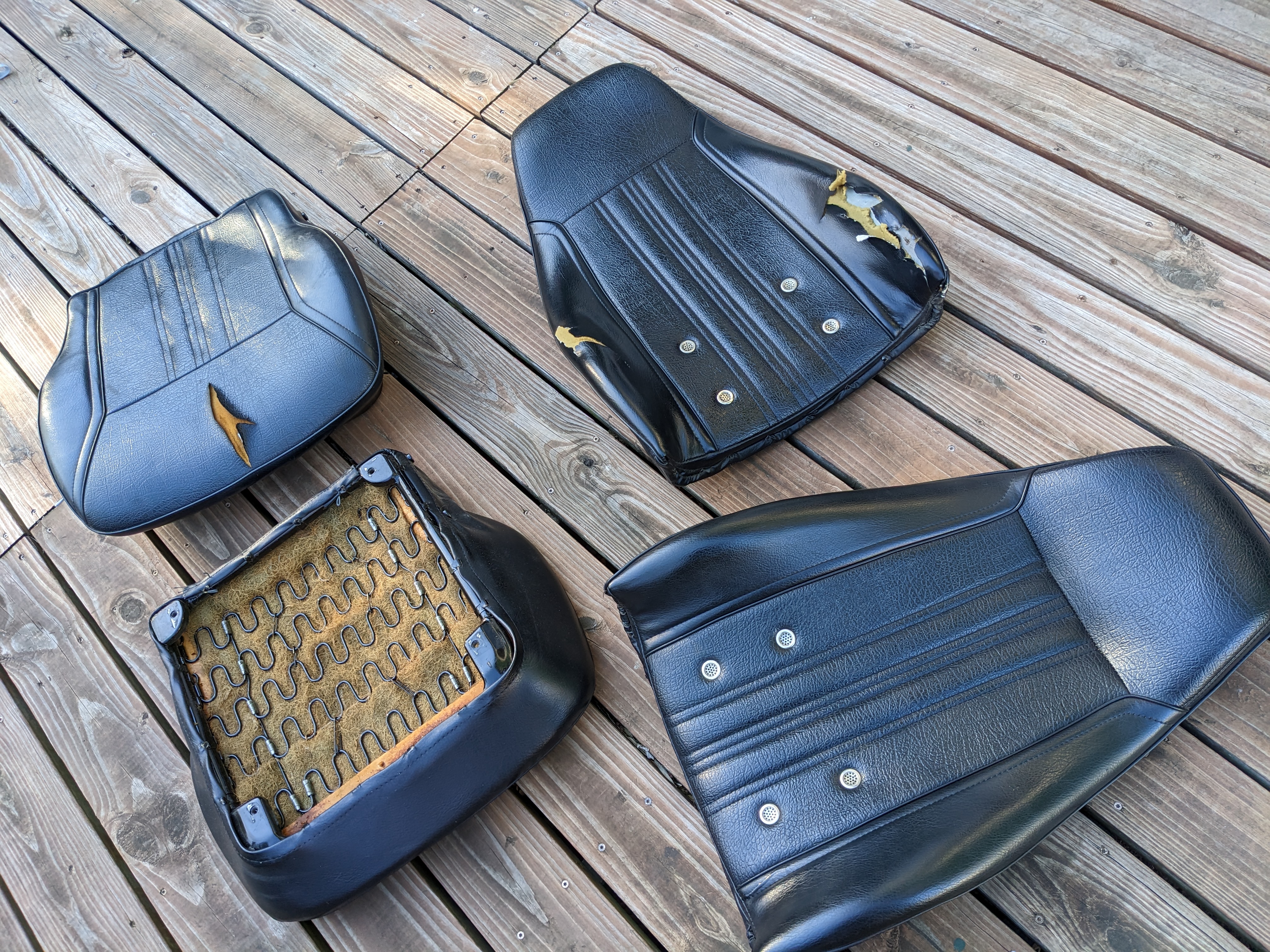

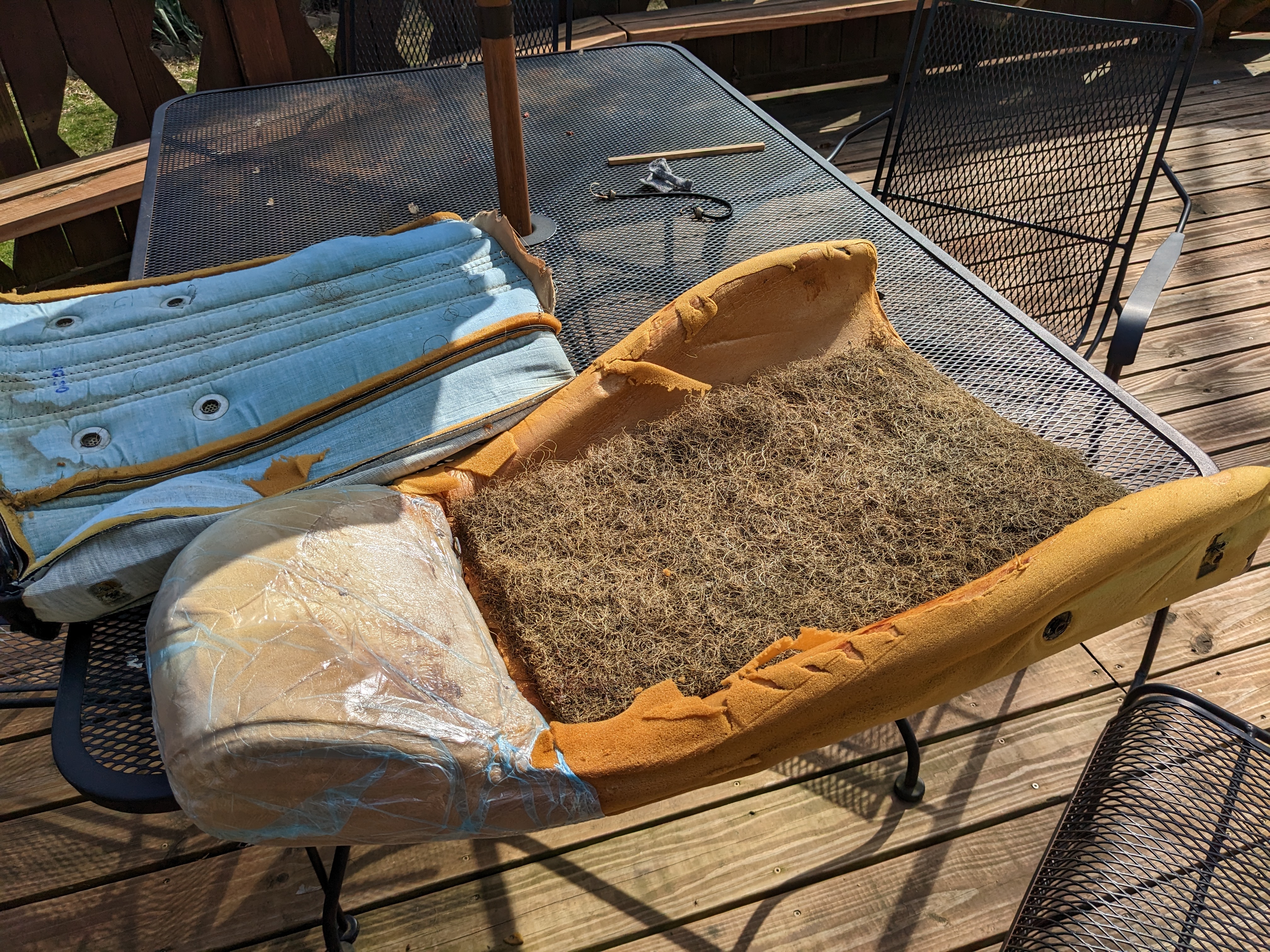

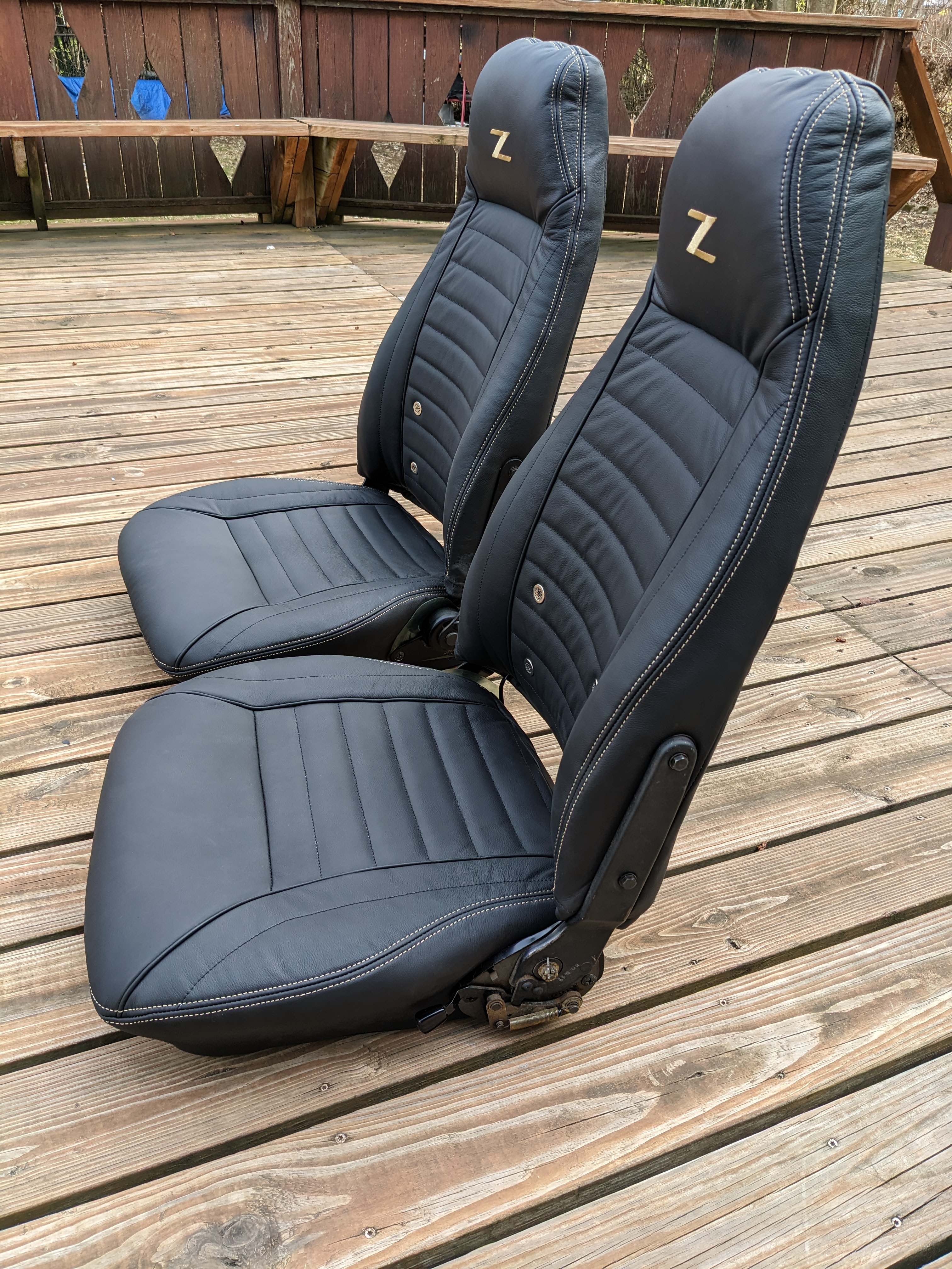

I bought the leather versions of their upholstery (off Amazon, included vents & "Z" embroidery without additional cost), and the new foam to go with. My original seats have 250K miles, so I figured safer to have the foam. There was much hay on the floor.

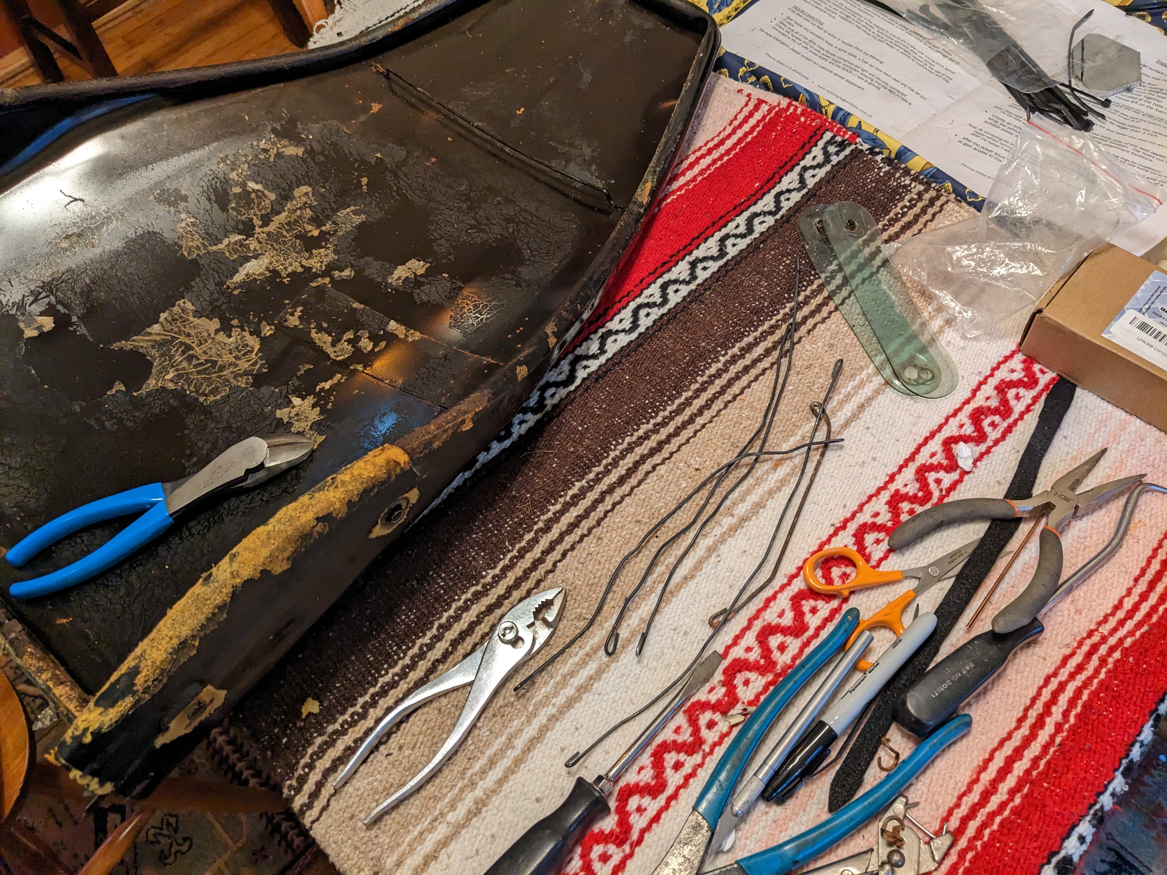

I watched a coupe videos, just to get the gist of the Datsun construction. One guy used dozens of tie wraps(!). I'm familiar with Volvo & Honda (S2000) seats, many hog rings on those, so it was nice to see the way Datsun went about it.
Anyway, took the seats out yesterday, and the carpets & under-matting. I have new carpet also, so I need to clean everything up,  fix the heater valve coolant leak, then put the new carpeting in, so I can reinstall the seats.

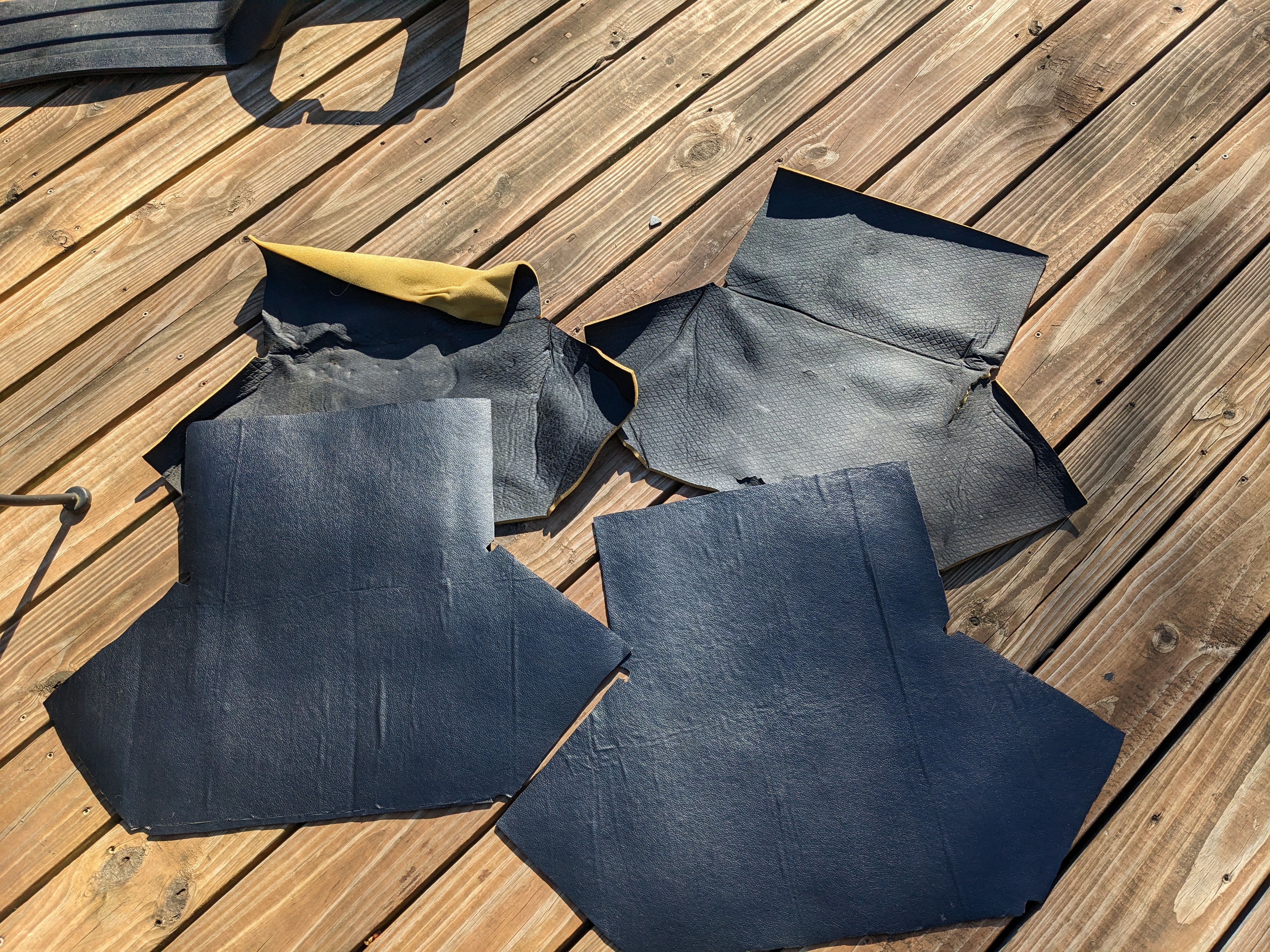

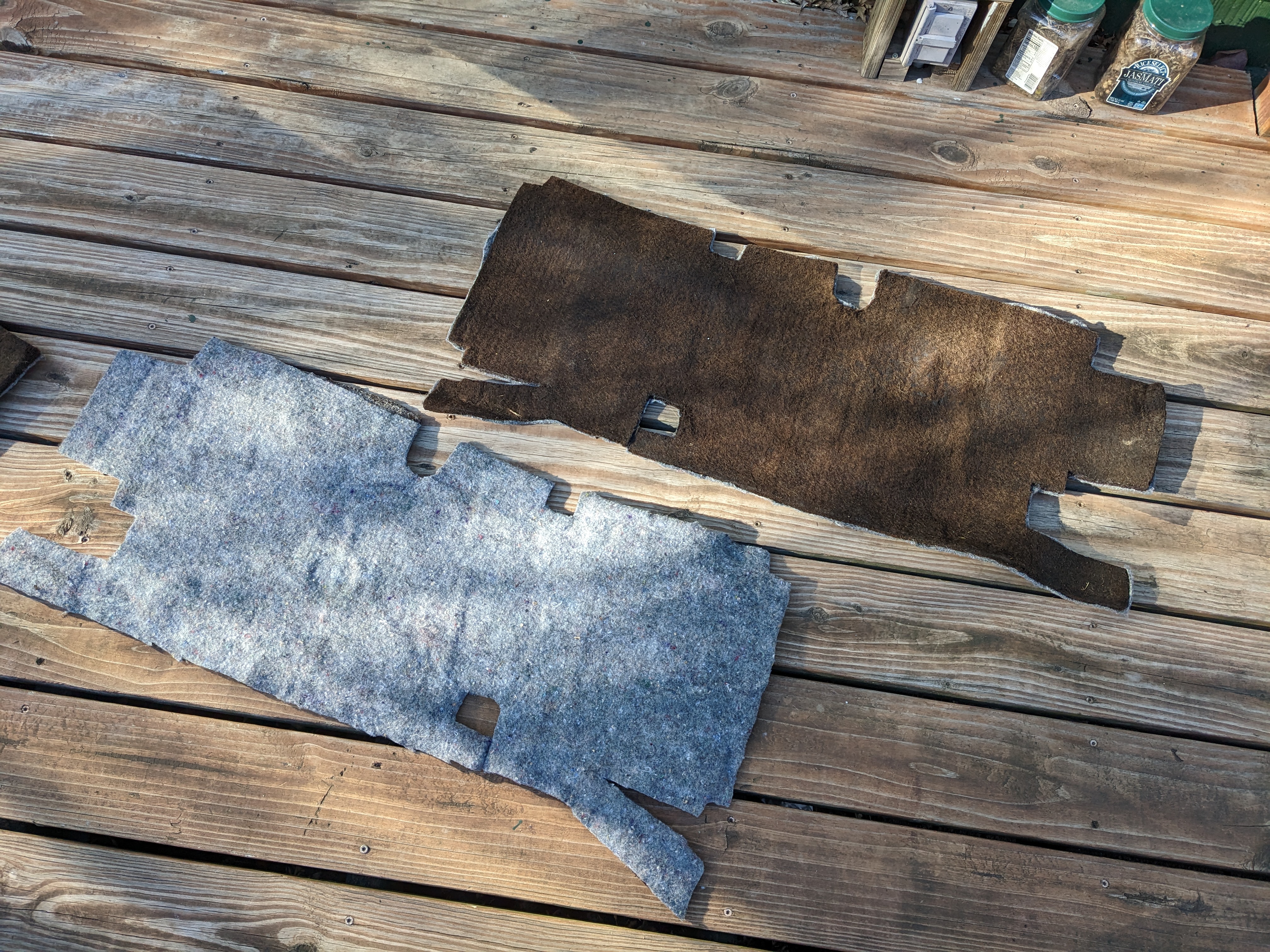

Added a reinforcing layer to the under-mats

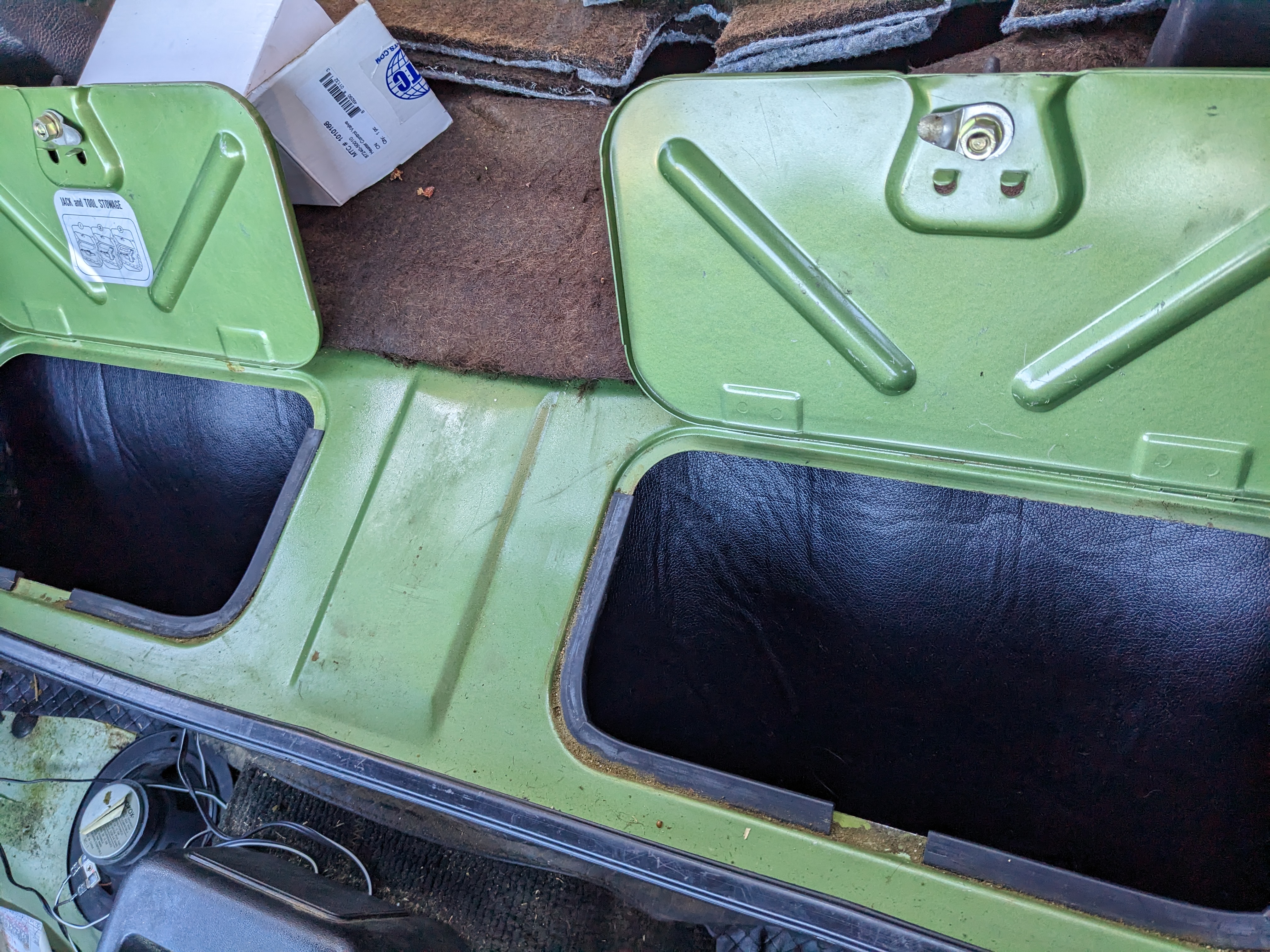

Made new cubby inserts, foam w/ vinyl layer glued

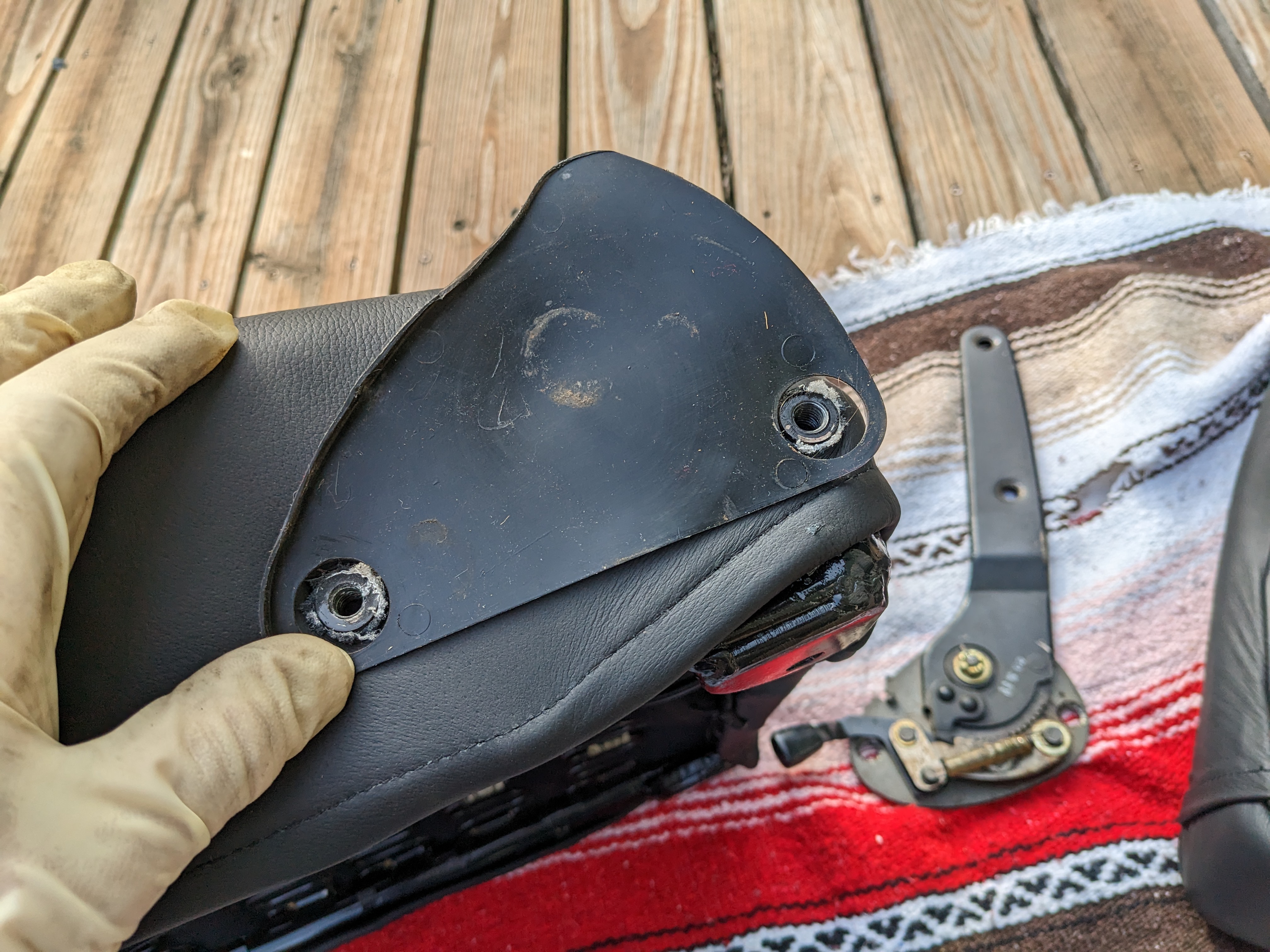

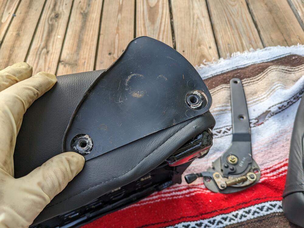

removed the seat hinges & rails. Pass seat back upholstery was still good, but I don't want vinyl . Have to clean up the hinges & rails before they go back together. I'm missing the outer hinge covers on both sides.

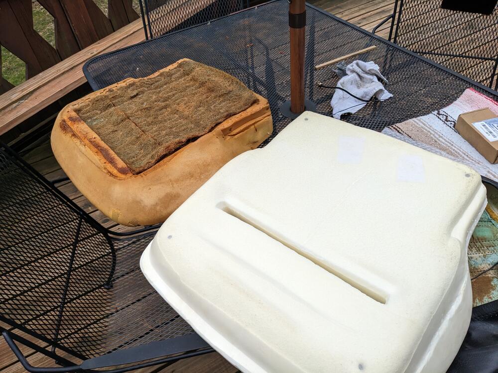

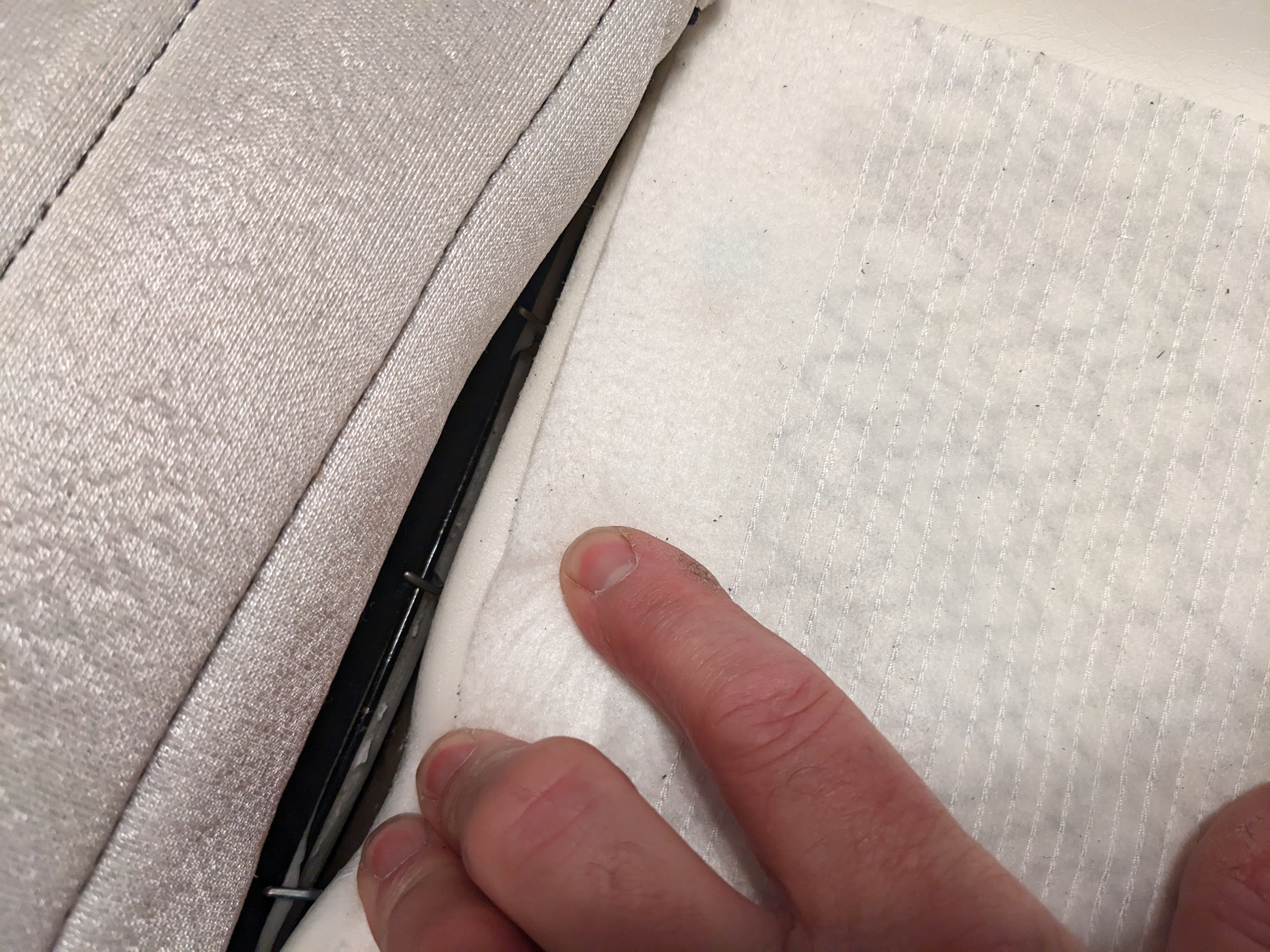

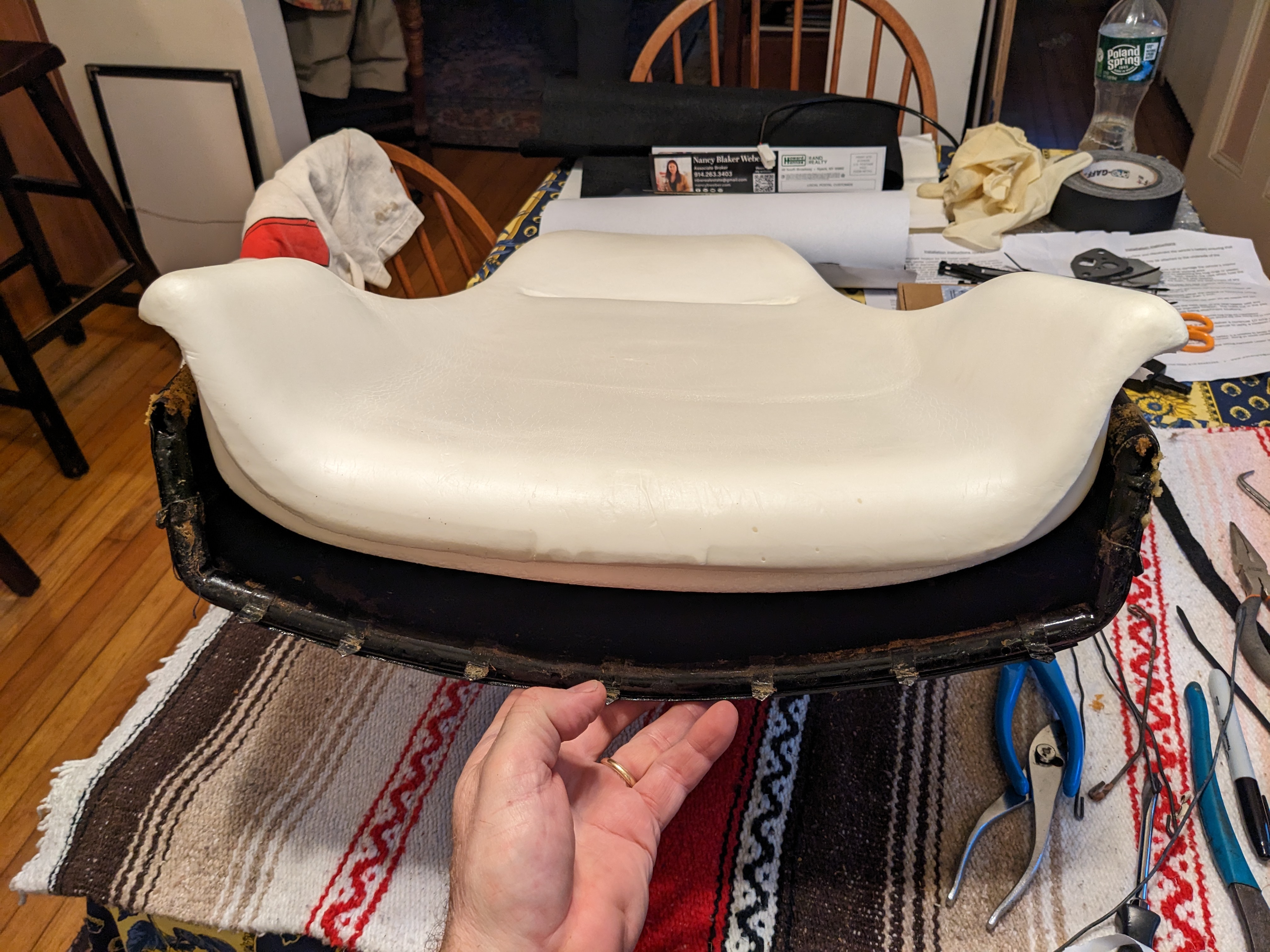

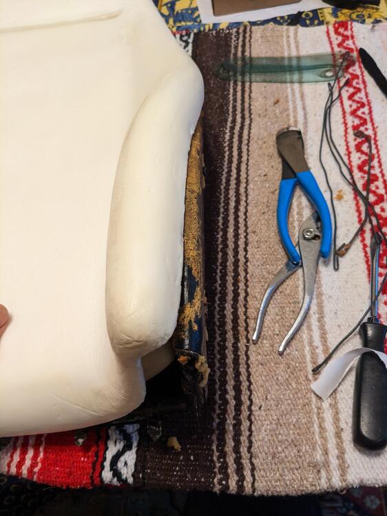

Foam comparsions - new one is thicker, doesn't need the hay layer

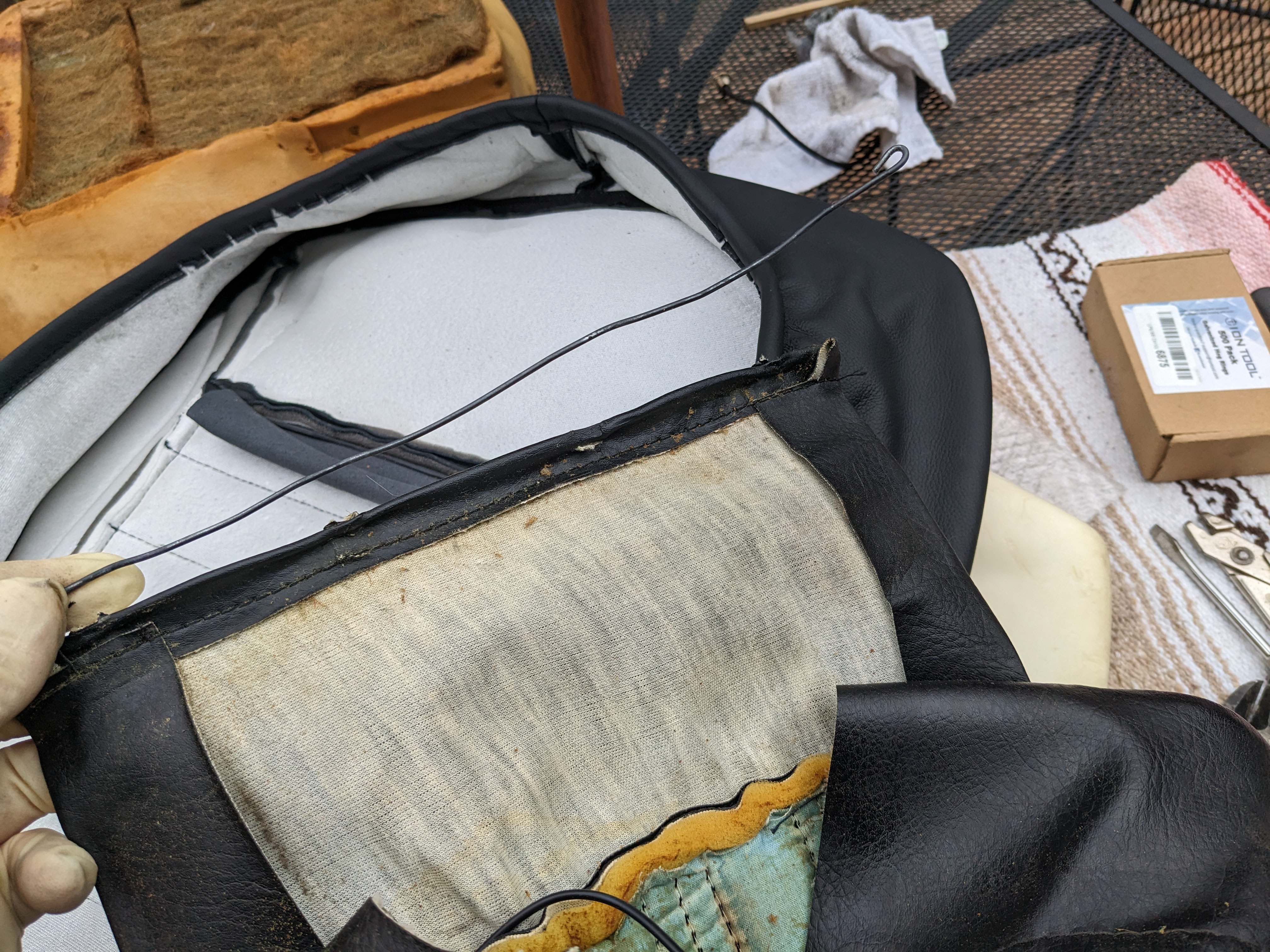

transfer perimeter  wire from originals

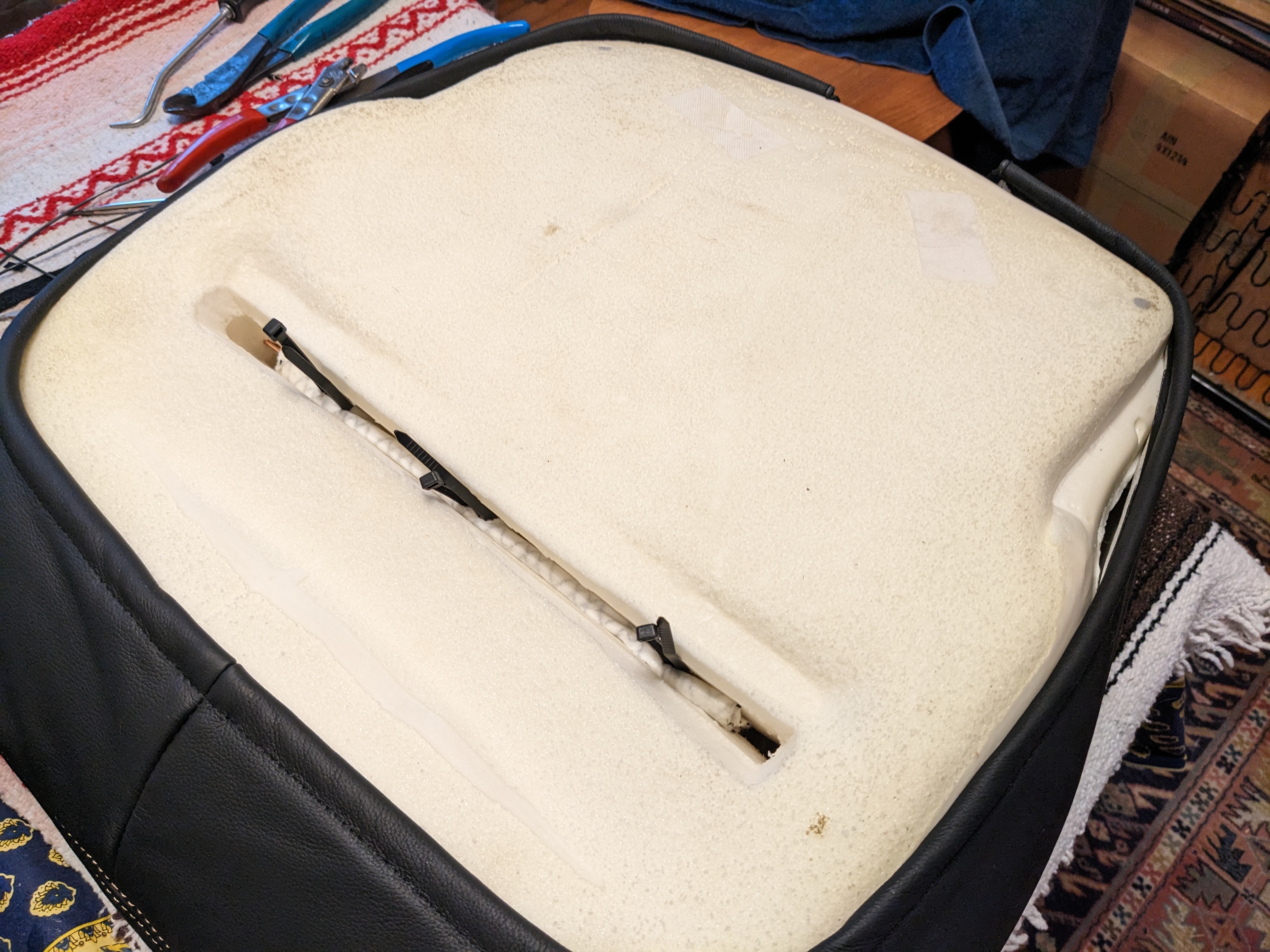

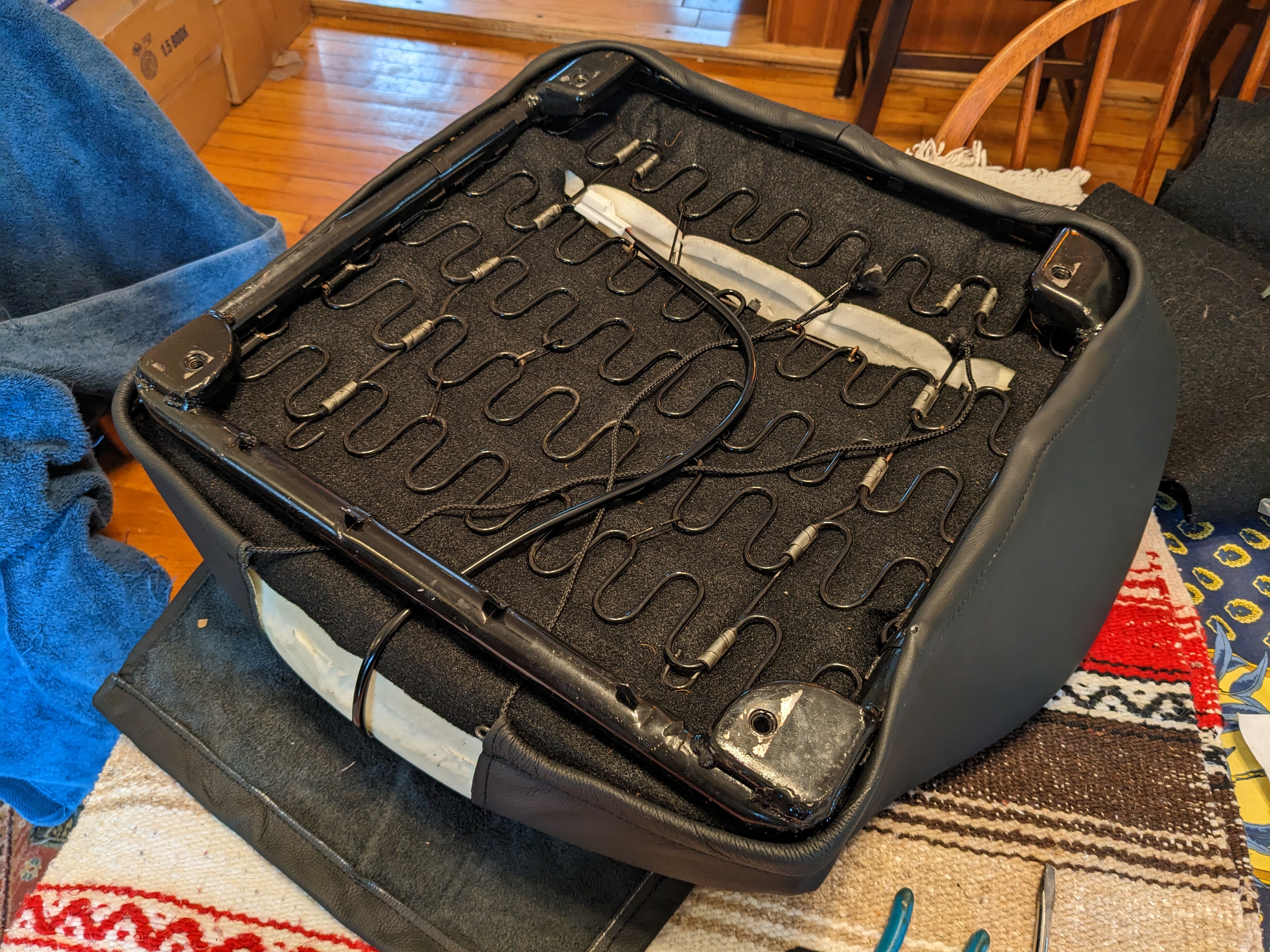

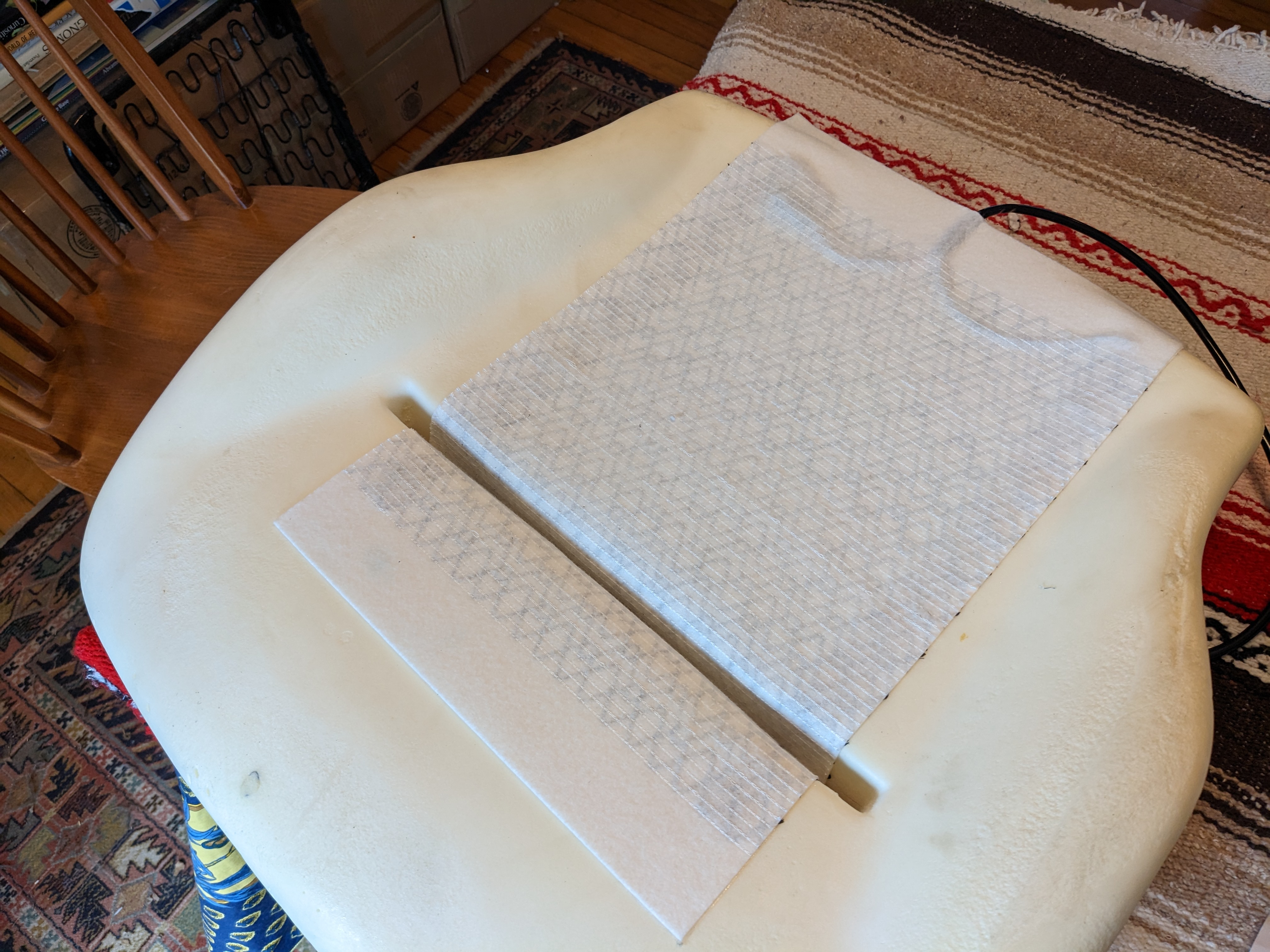

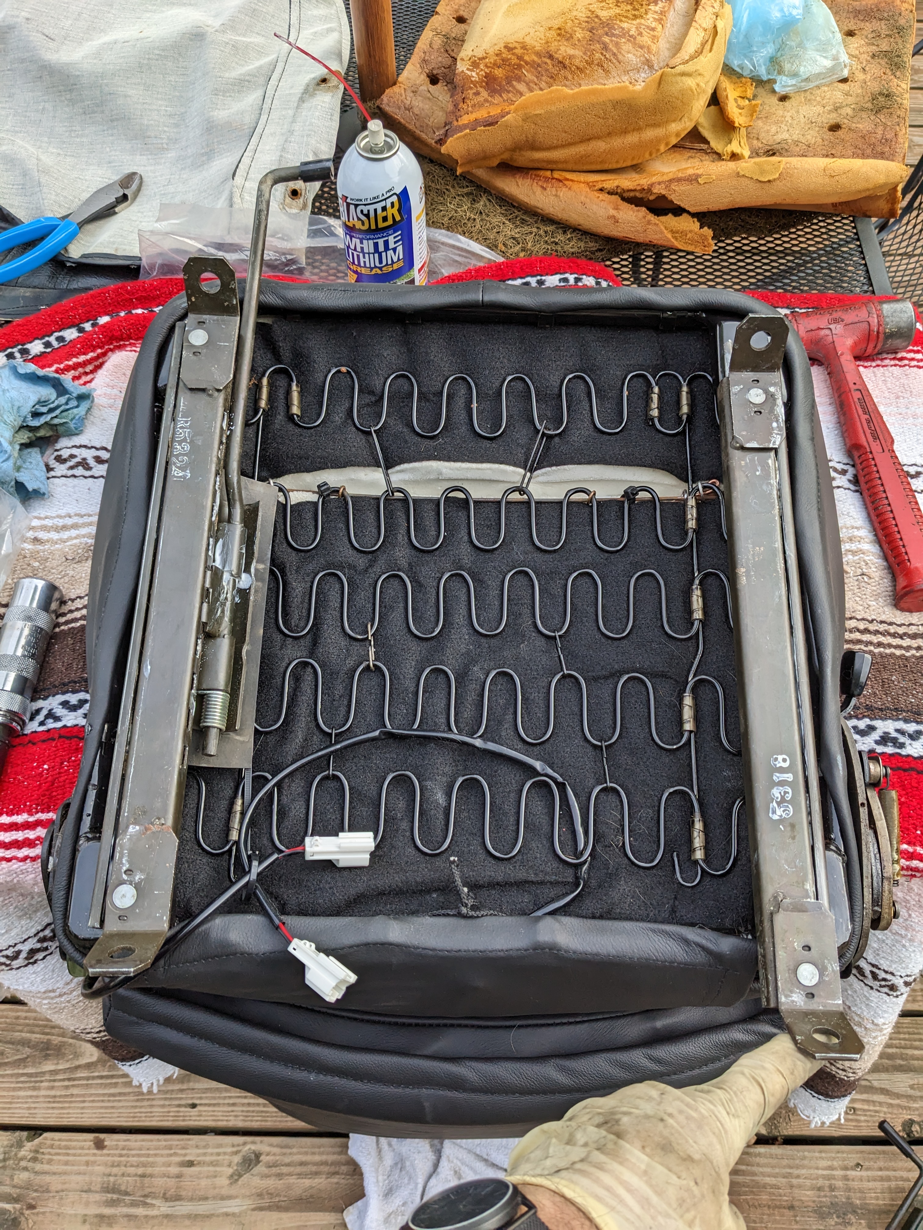

Started raining, so I moved indoors. Adding seat heaters while I'm at it.

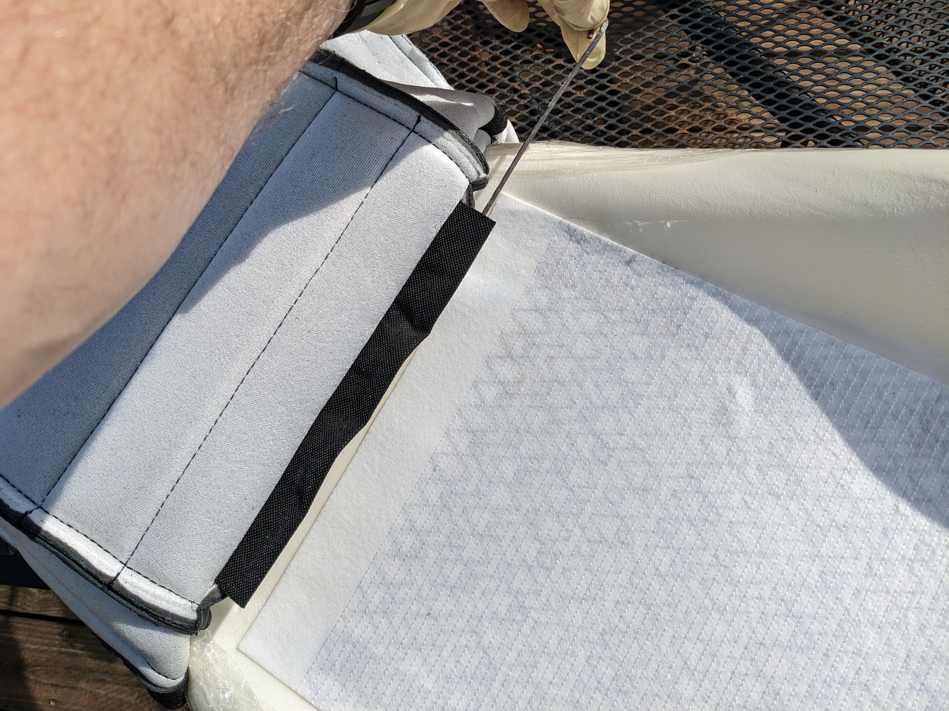

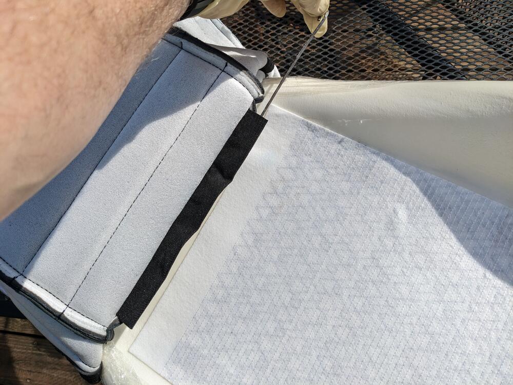

Used tie wraps to add in pulling the upholstery flap through to the wire frame

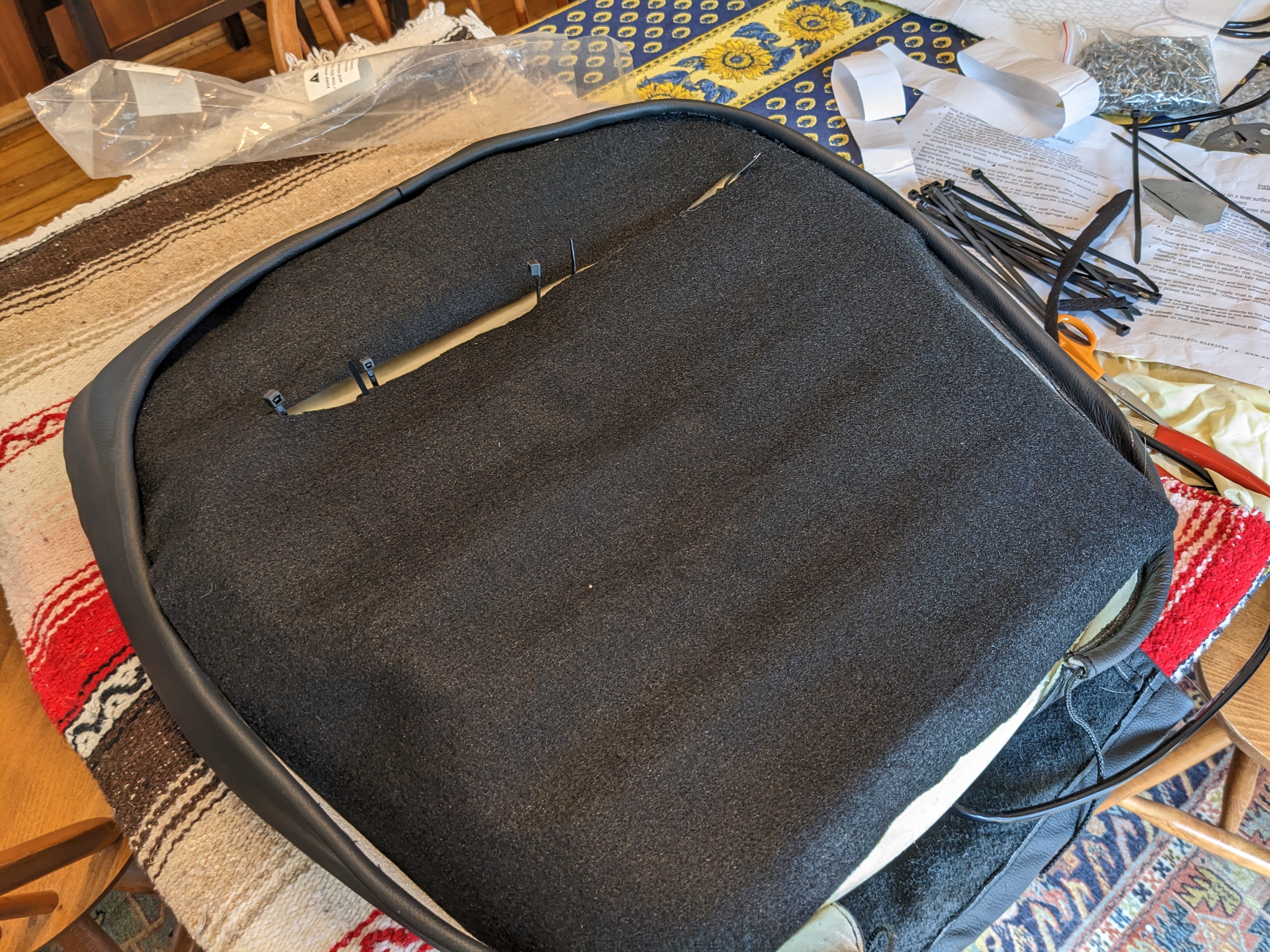

Layer of felt to protect the foam

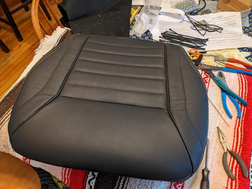

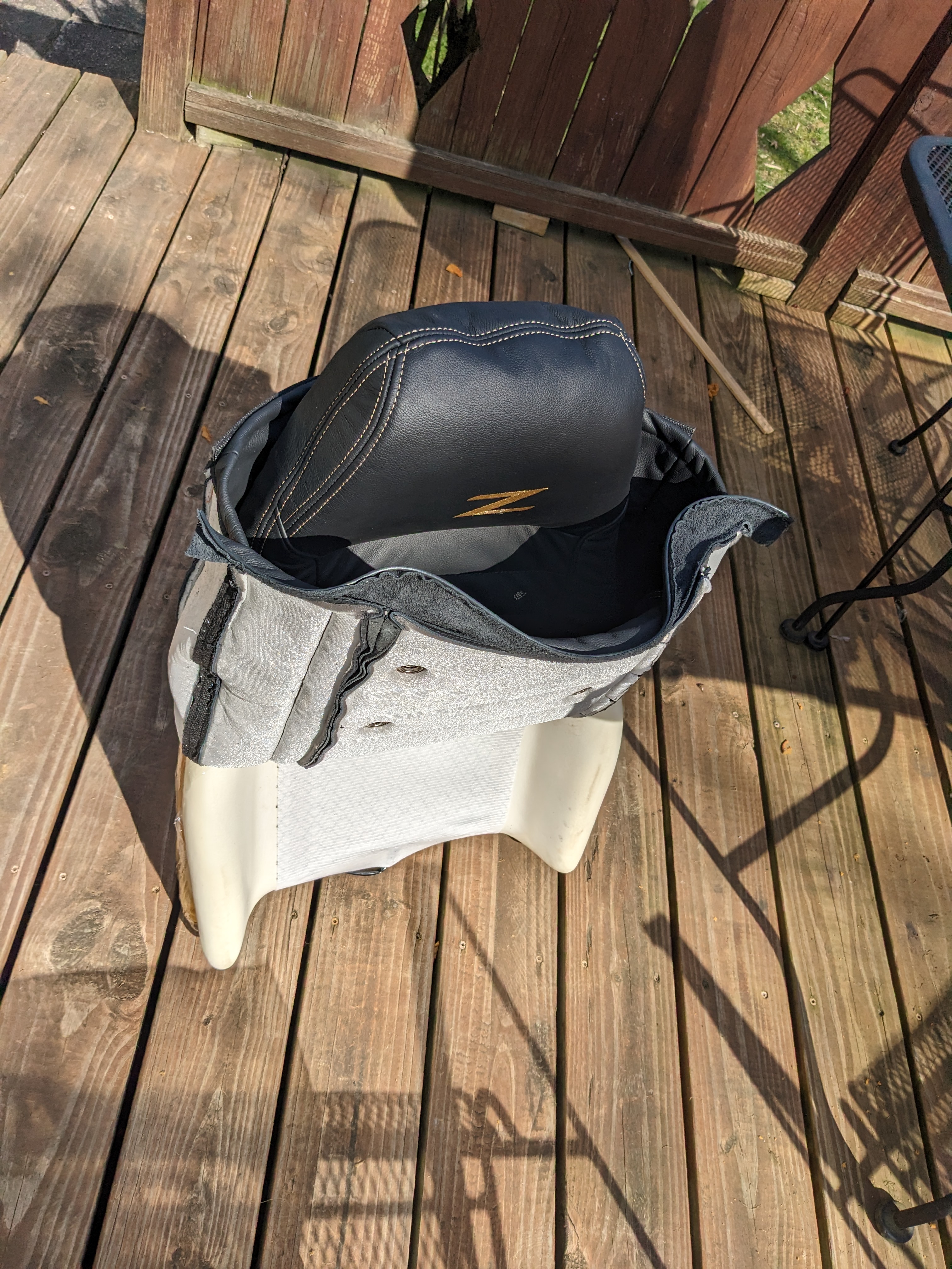

Frame wedged in place, upholstery tangs pressed into leather seam, forward flap hog-ringed in place, rear flap not yet attached
Fit seems OK

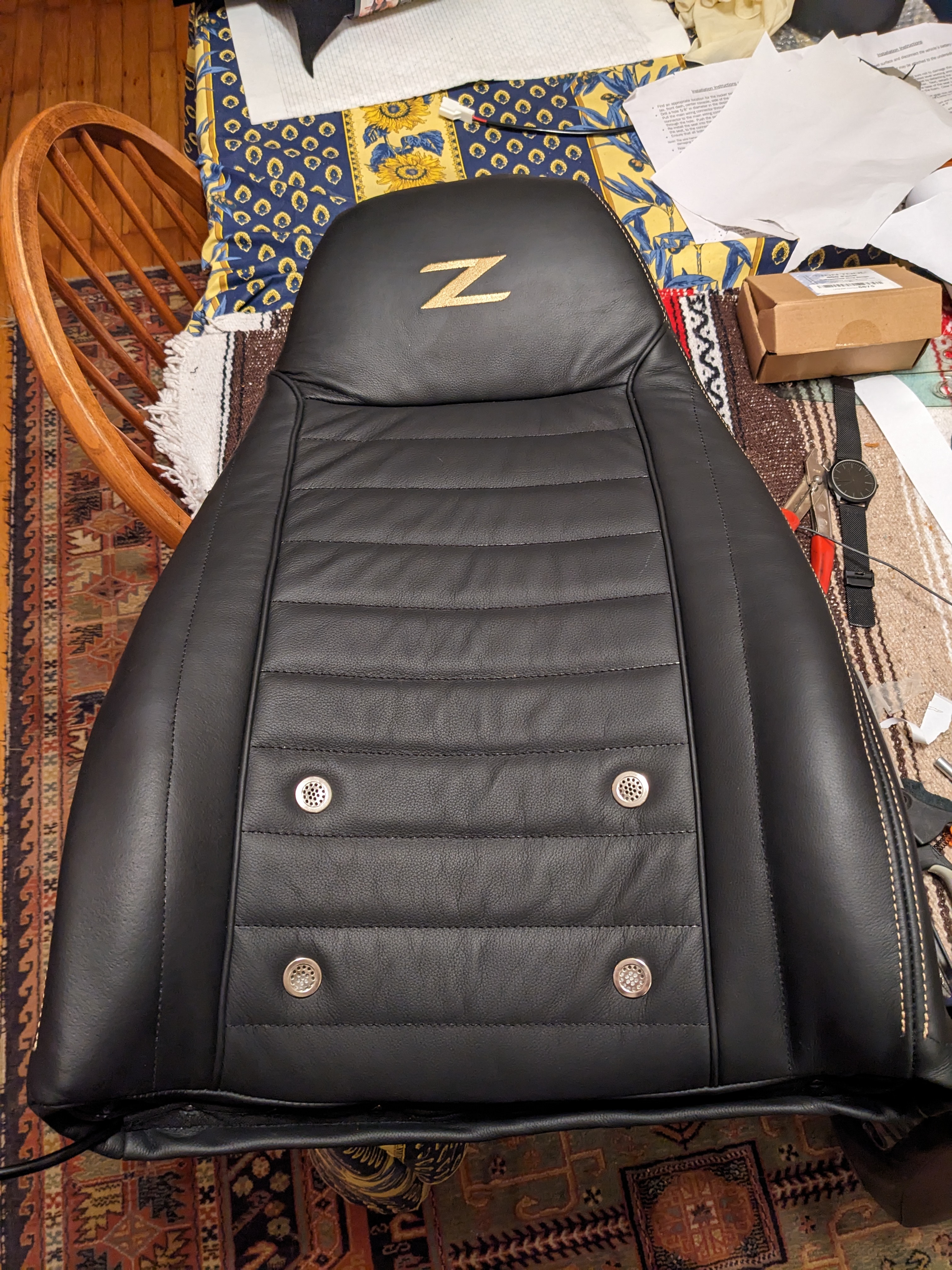

The upright foam doesn't seem to fit as well, however once the upholstery was on, it seems OK

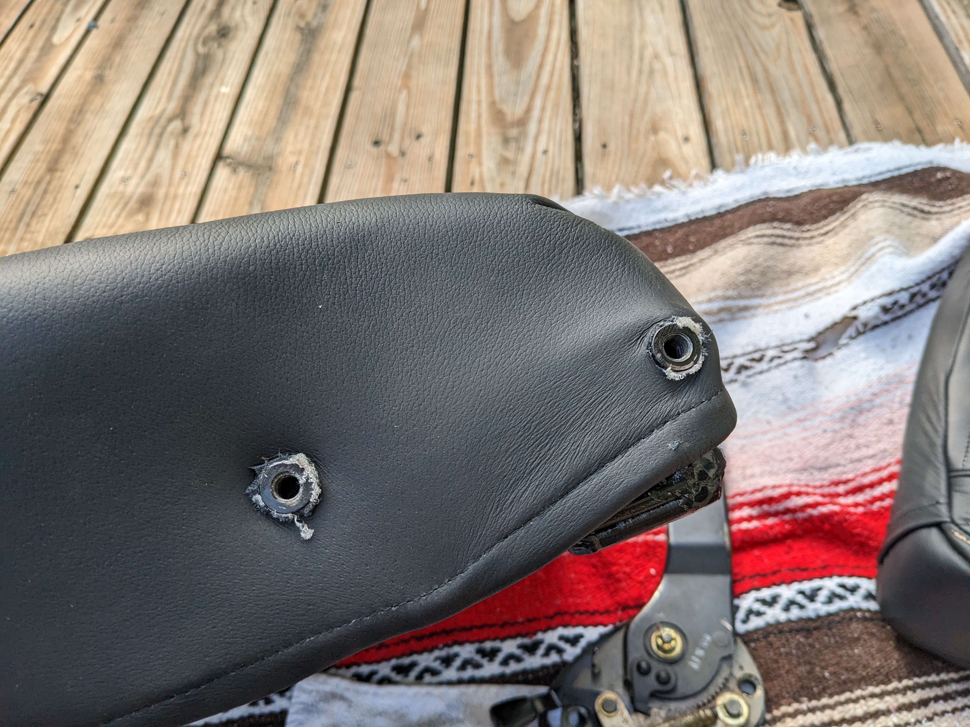

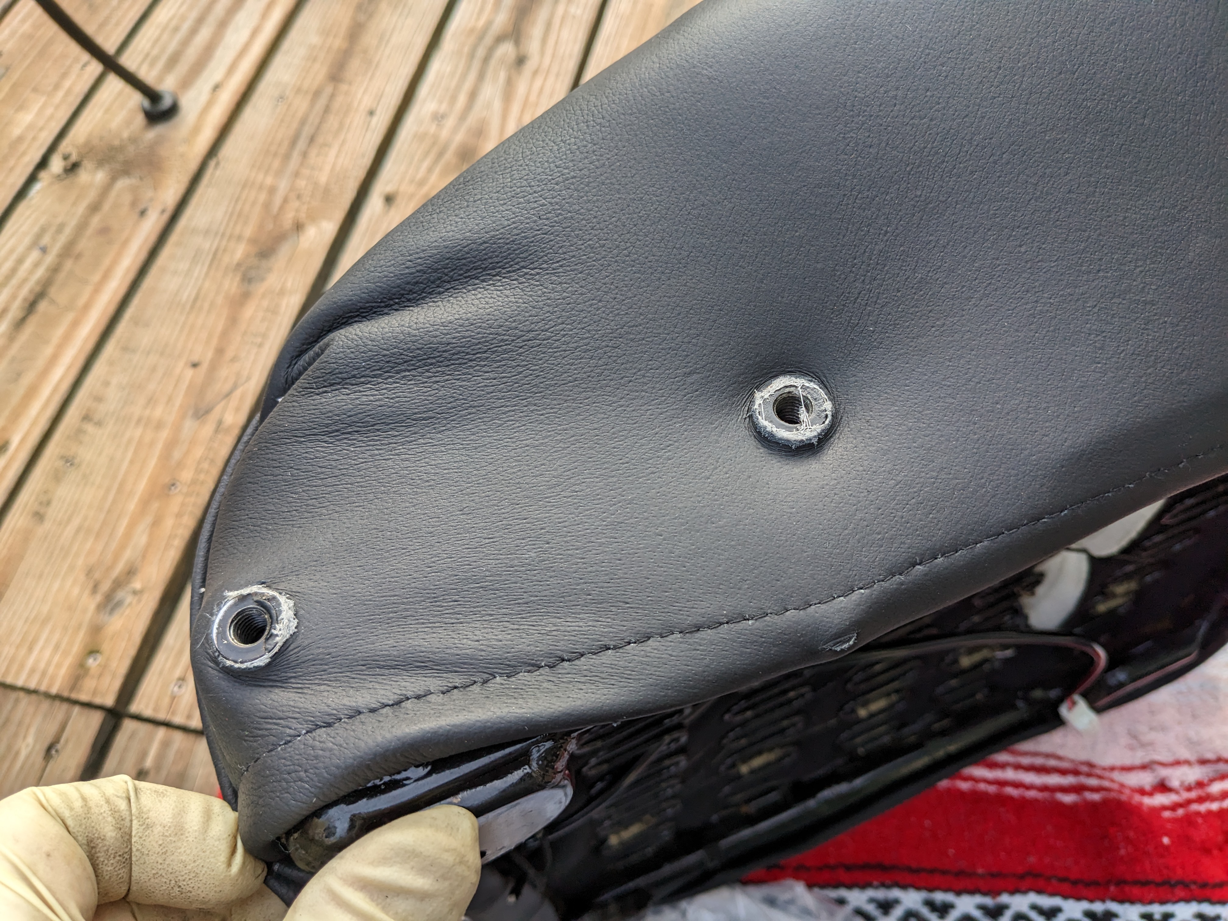

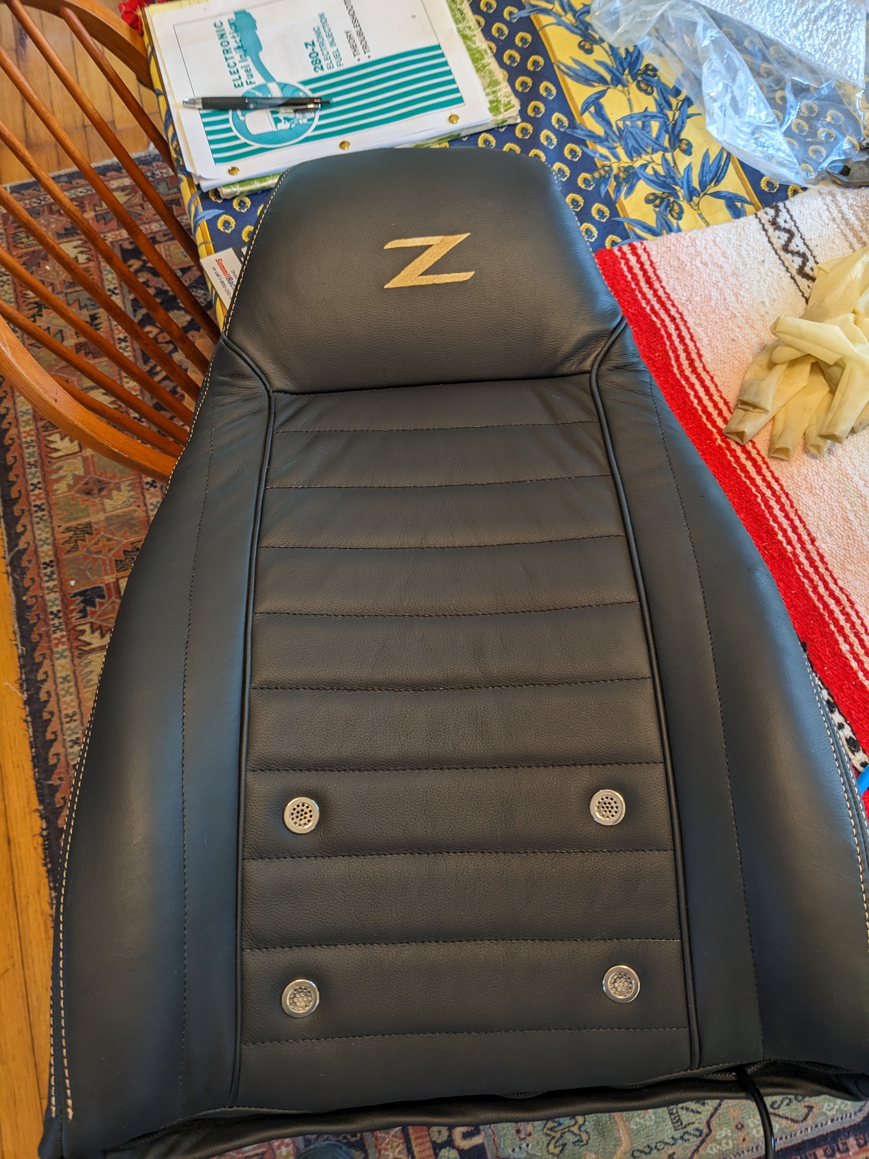

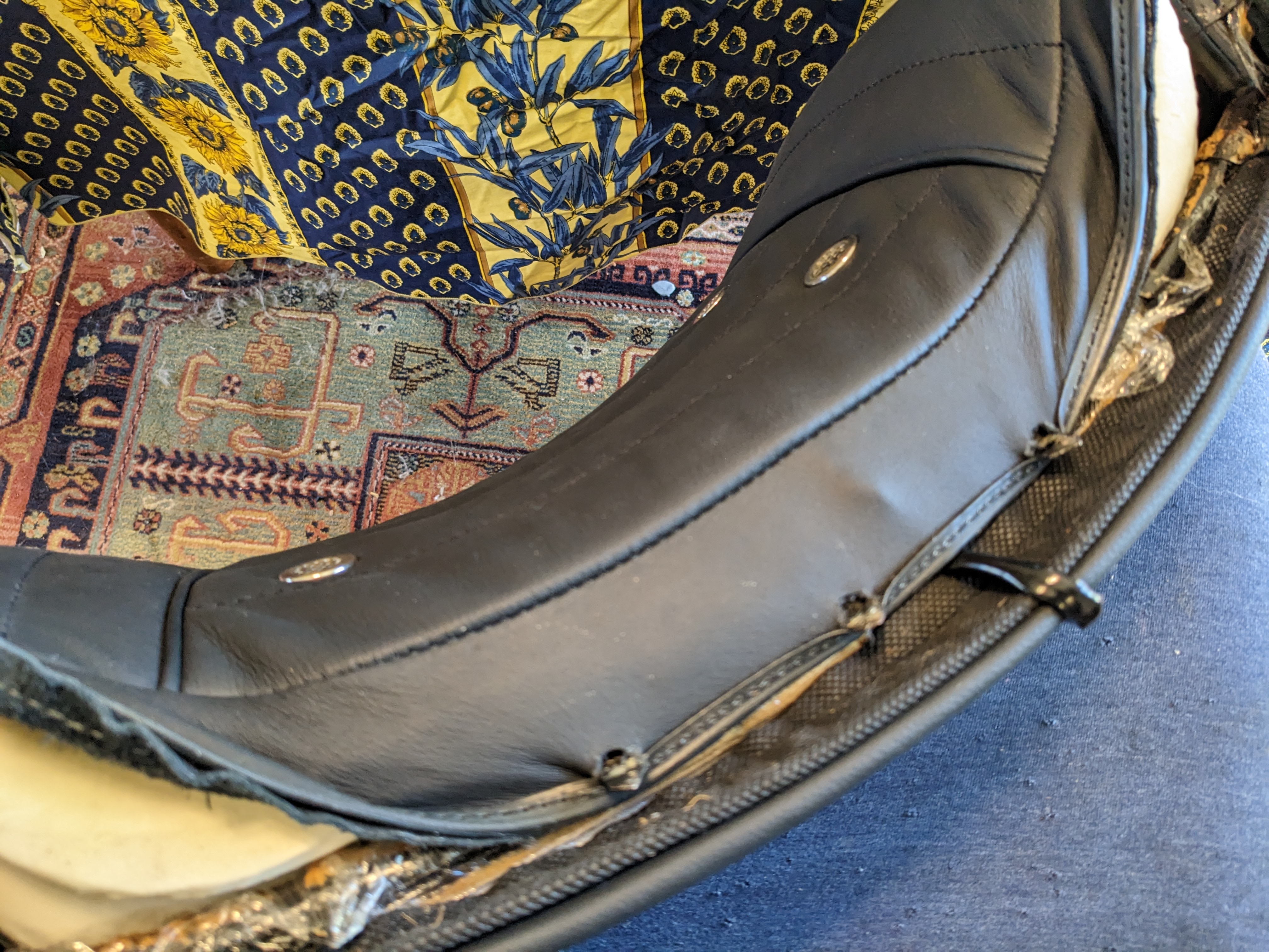

Pulled upholstery over the head rest portion & install 3 hog rings
took a couple tries to get the cover reasonably aligned, still a little off center

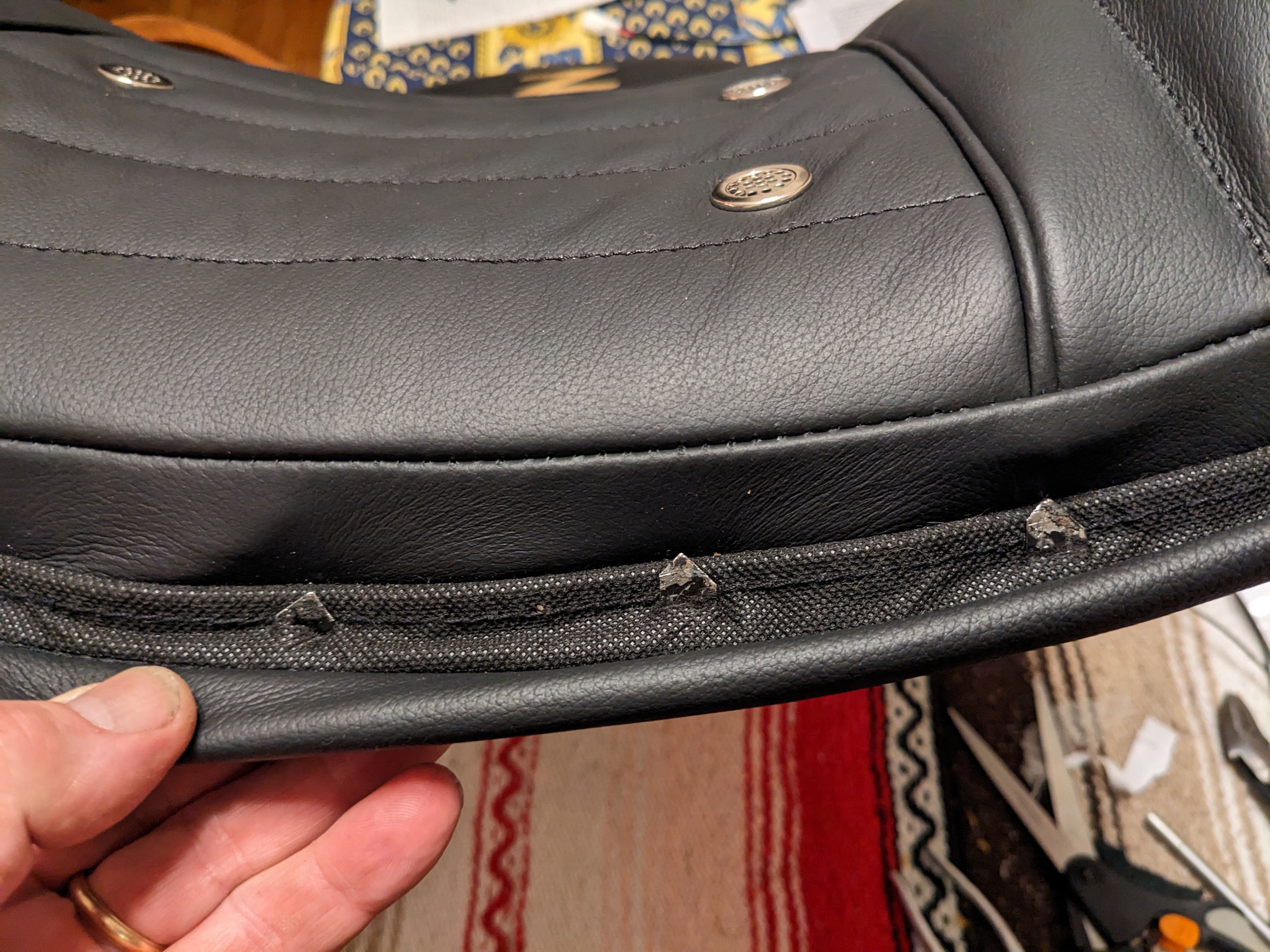

forward cover stretched over tangs, then rear lip

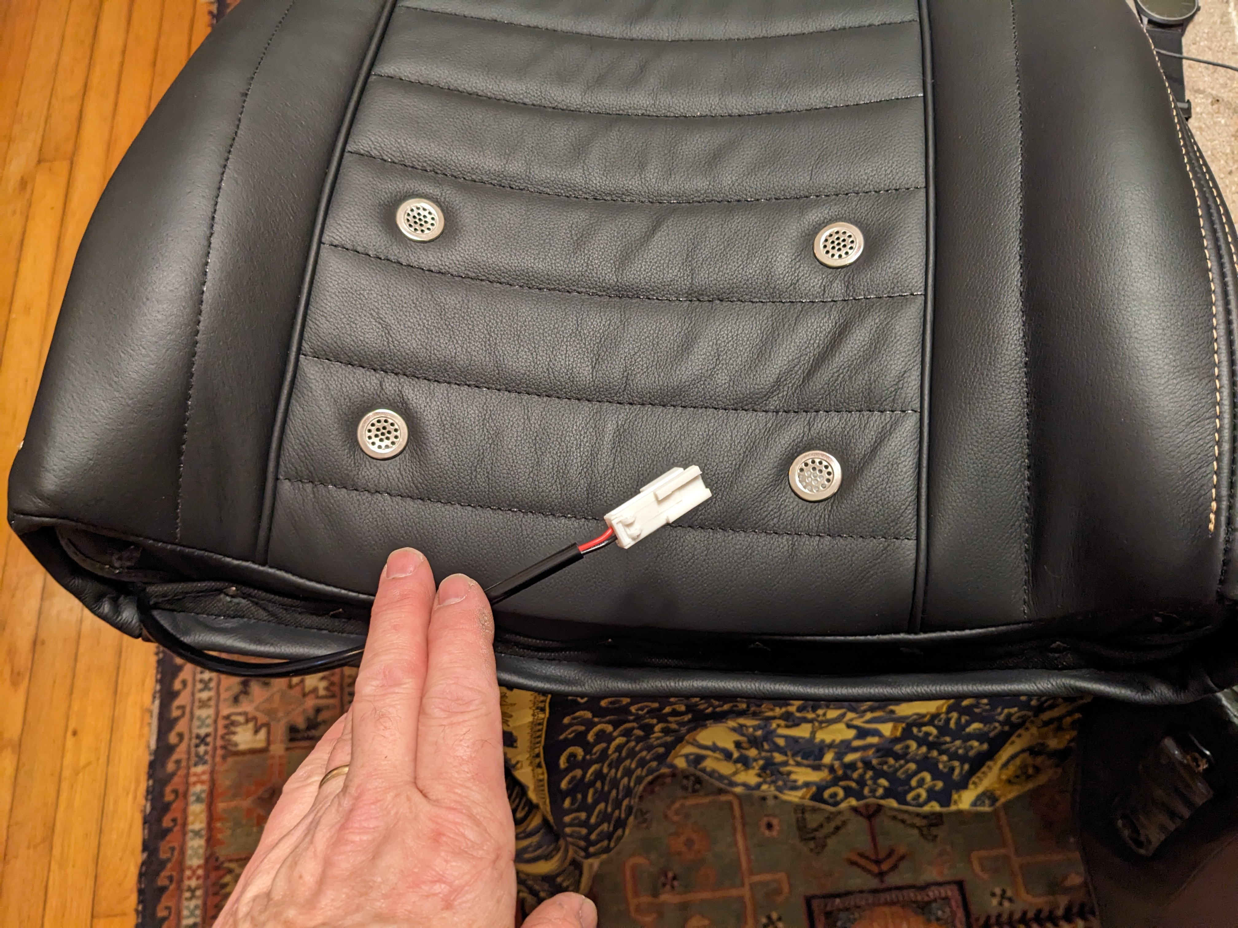

seat heater wire brought out near the hinge

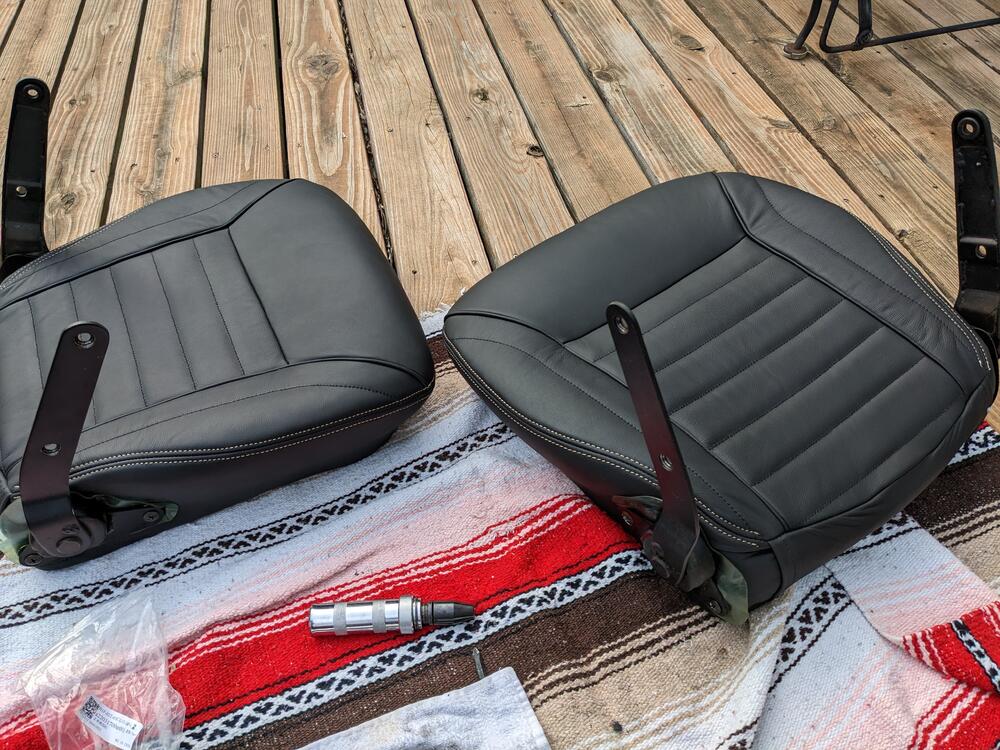

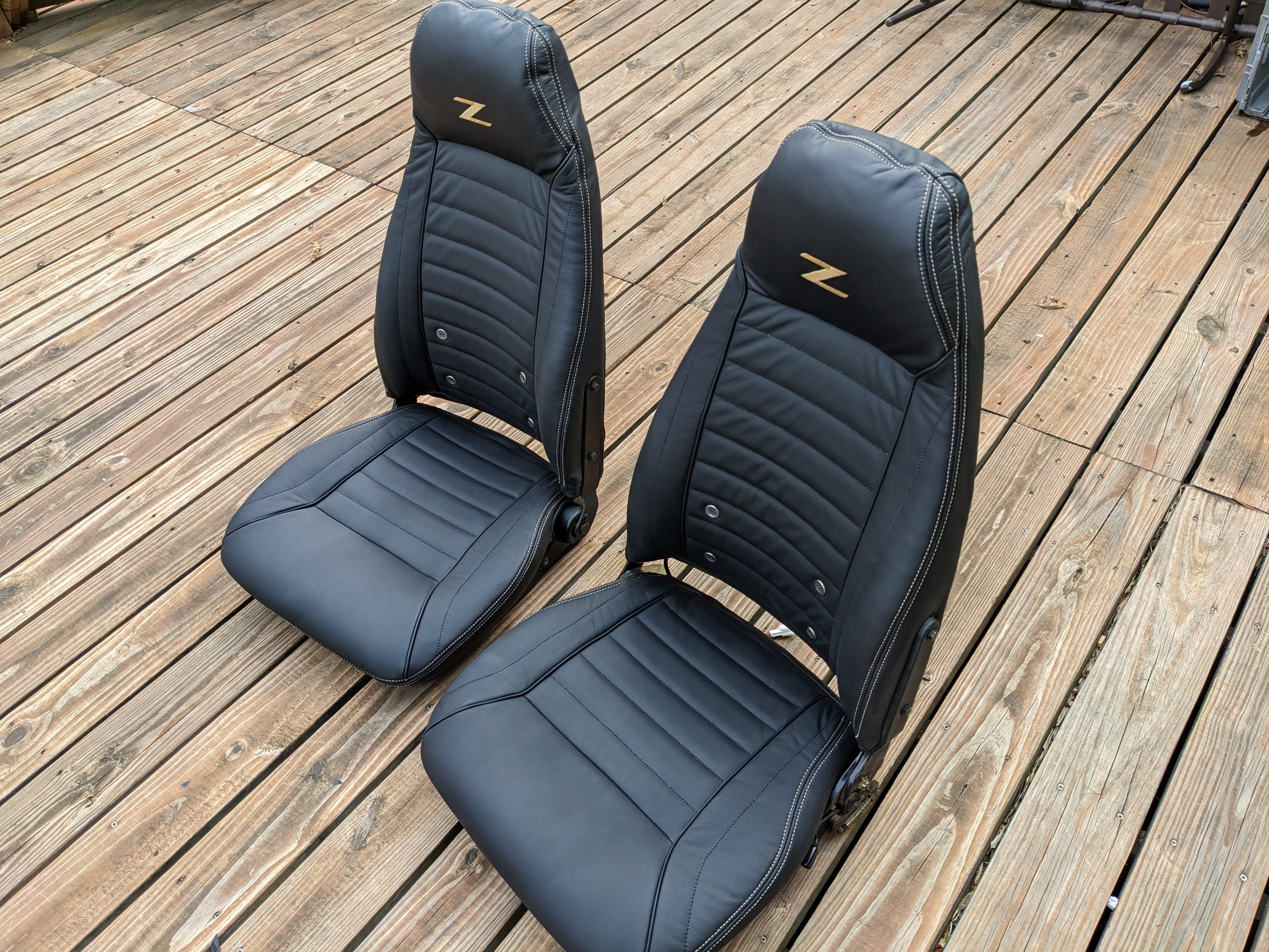

Worked on finishing the seat upholstery & re assembly today

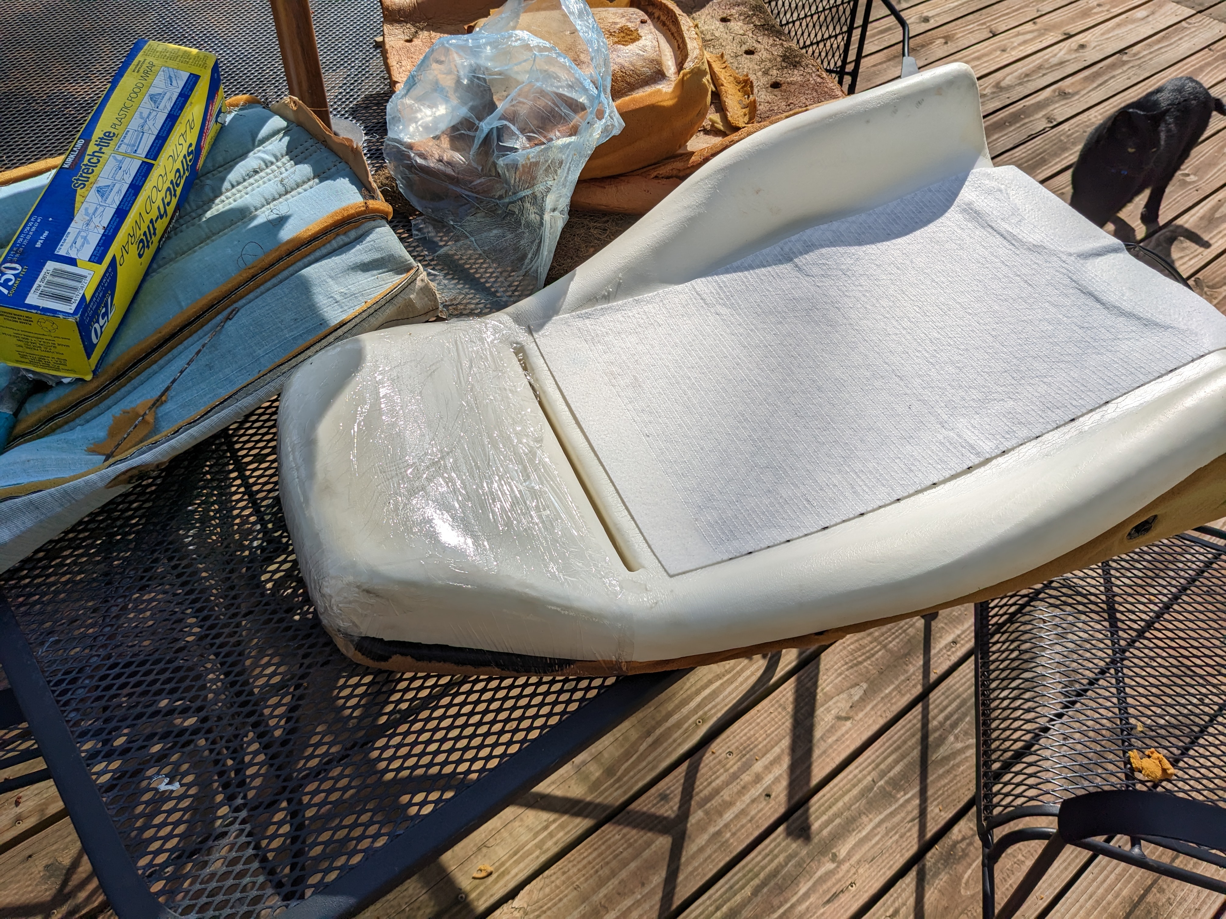

used Saran Wrap on the headrest area, made it easier to pull the cover over & align it
inserting original support wire
Cover going on
securing the bottom edge

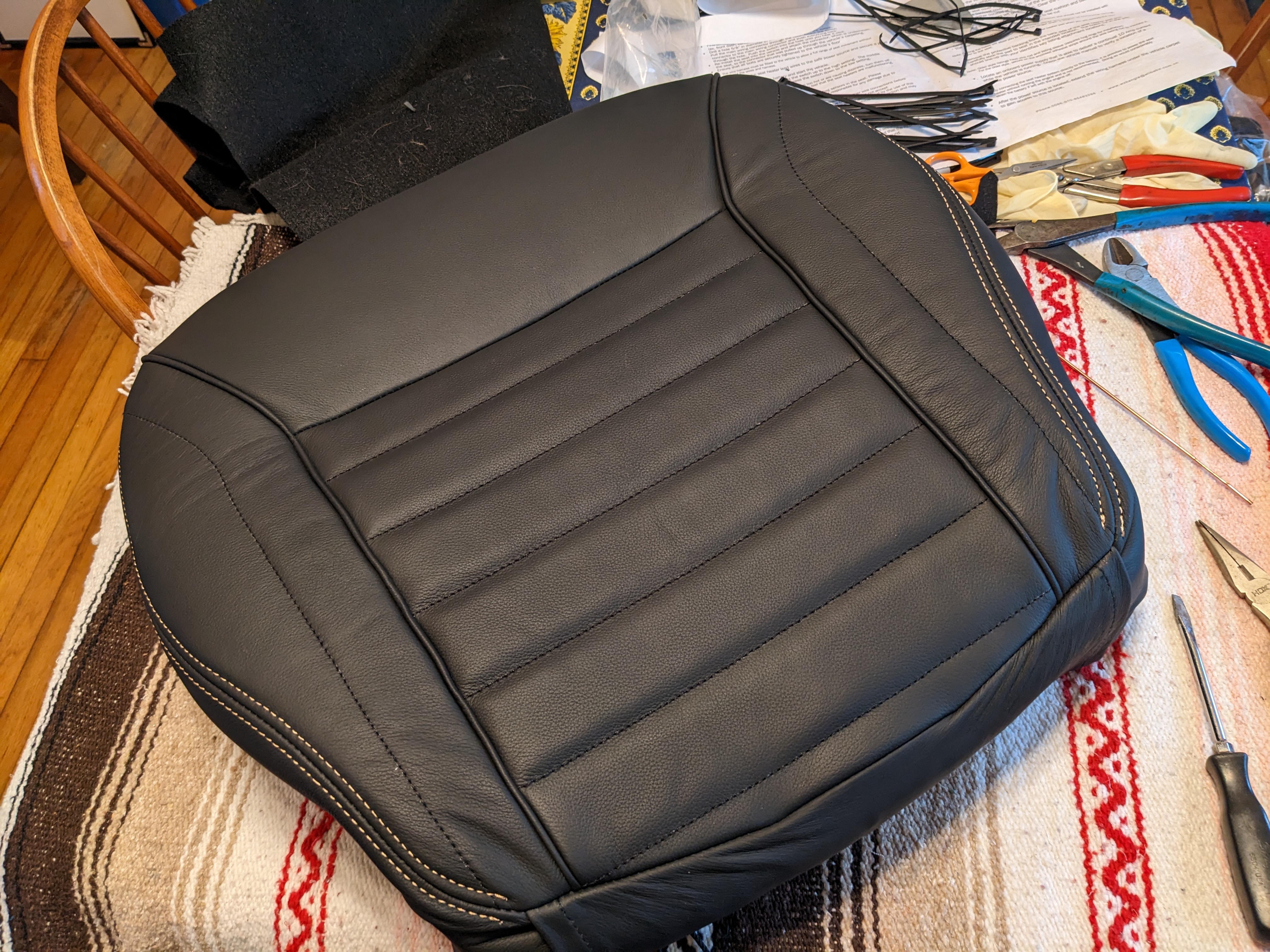

this one is more even
cut holes for the hinges
fit protectors behind hinges

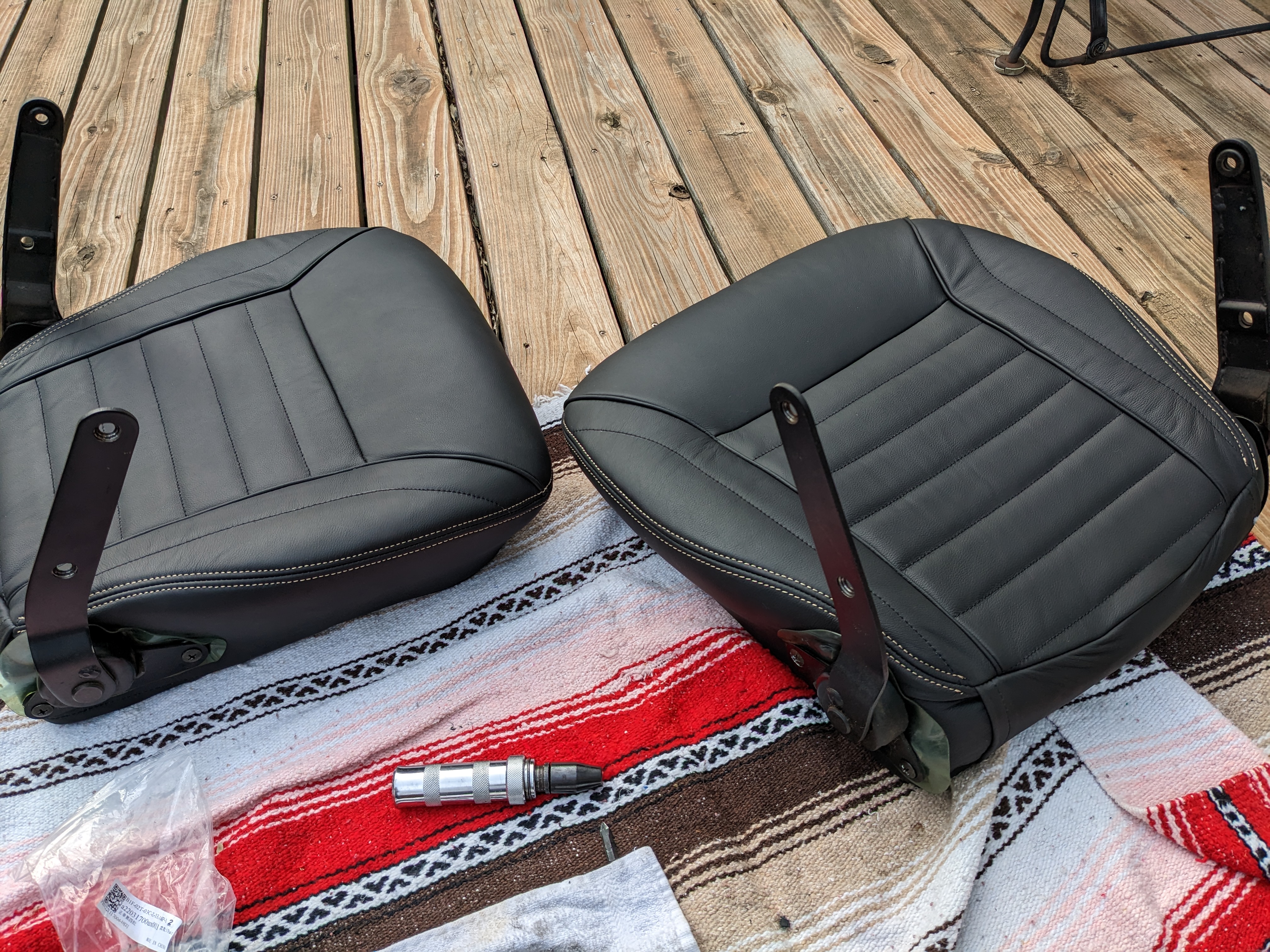

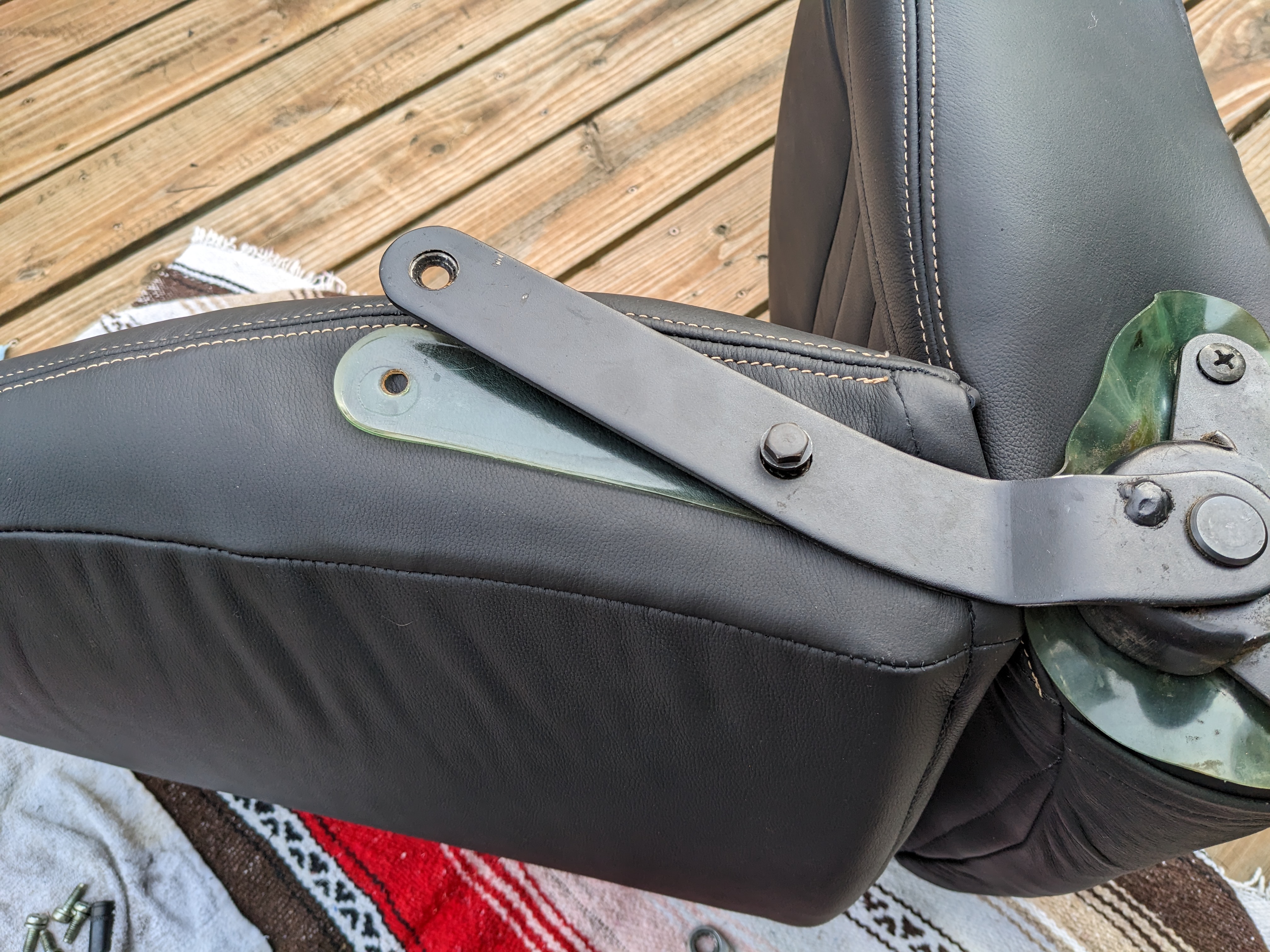

hinges in place on cushions

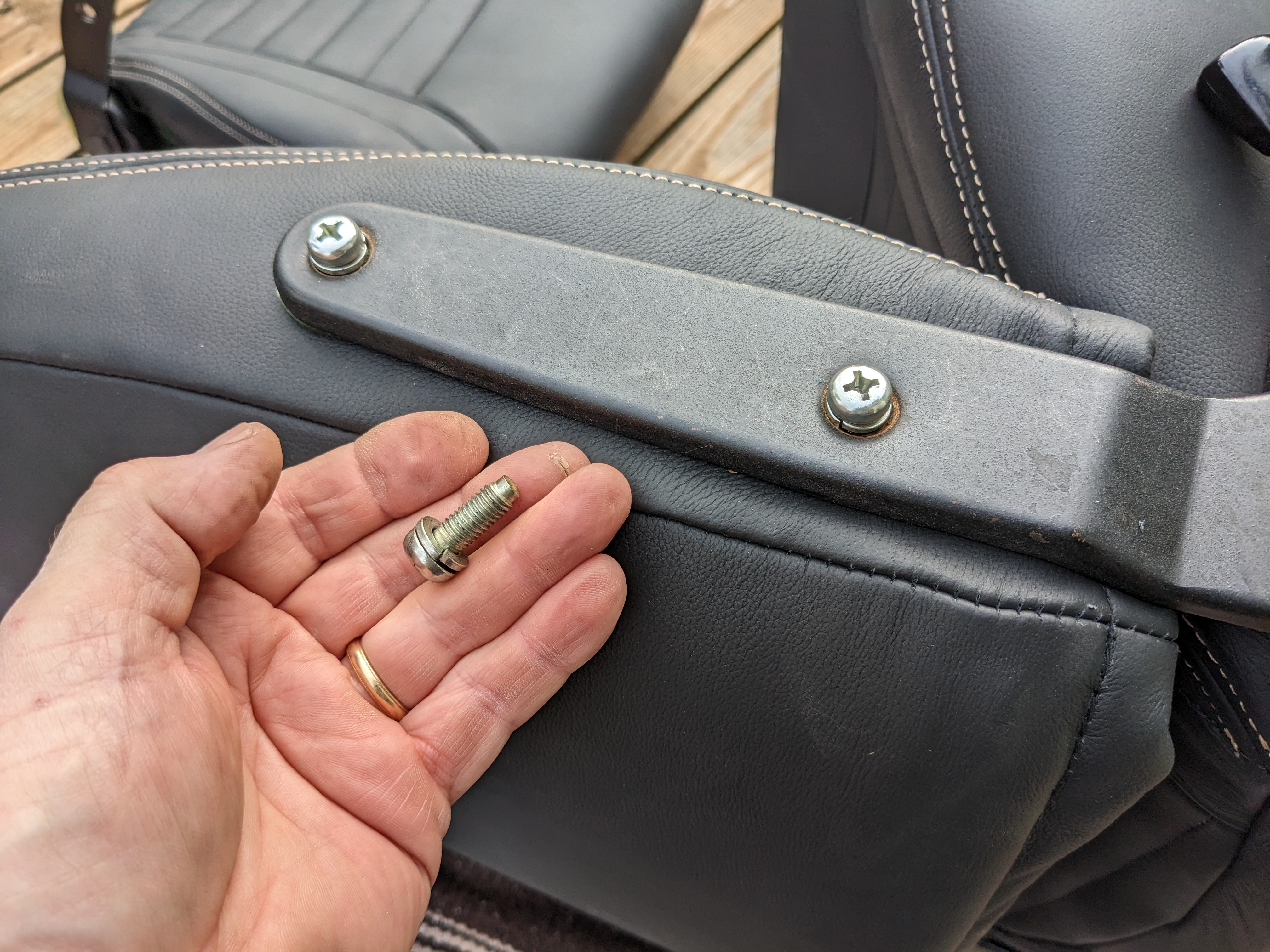

Uprights are a little tricky - the back screws don't have a taper guide tip, so I used the rail screws first to position the hinges
then swap out for the correct bolts one at a time
all together
rails back on after clean & lube

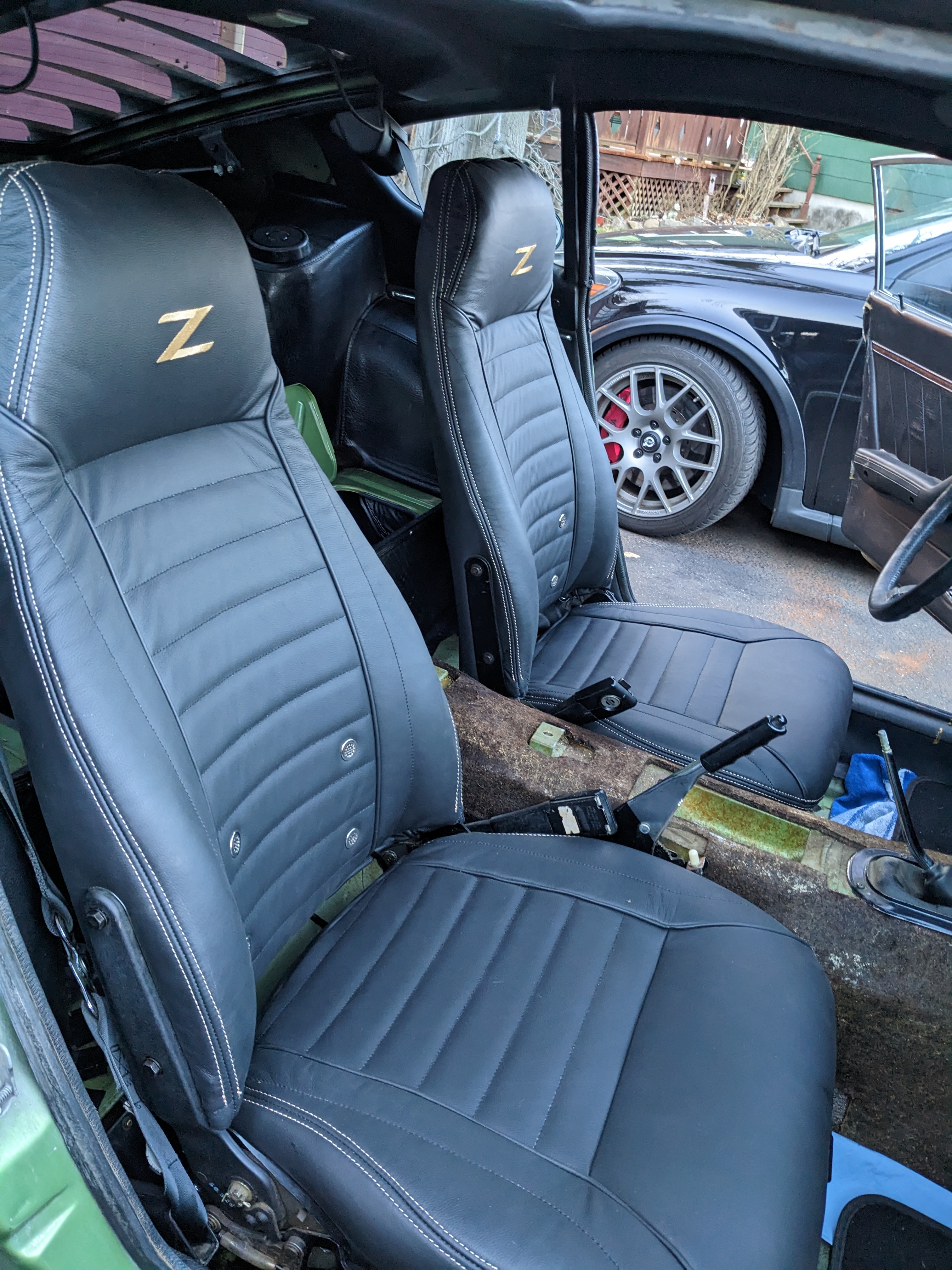

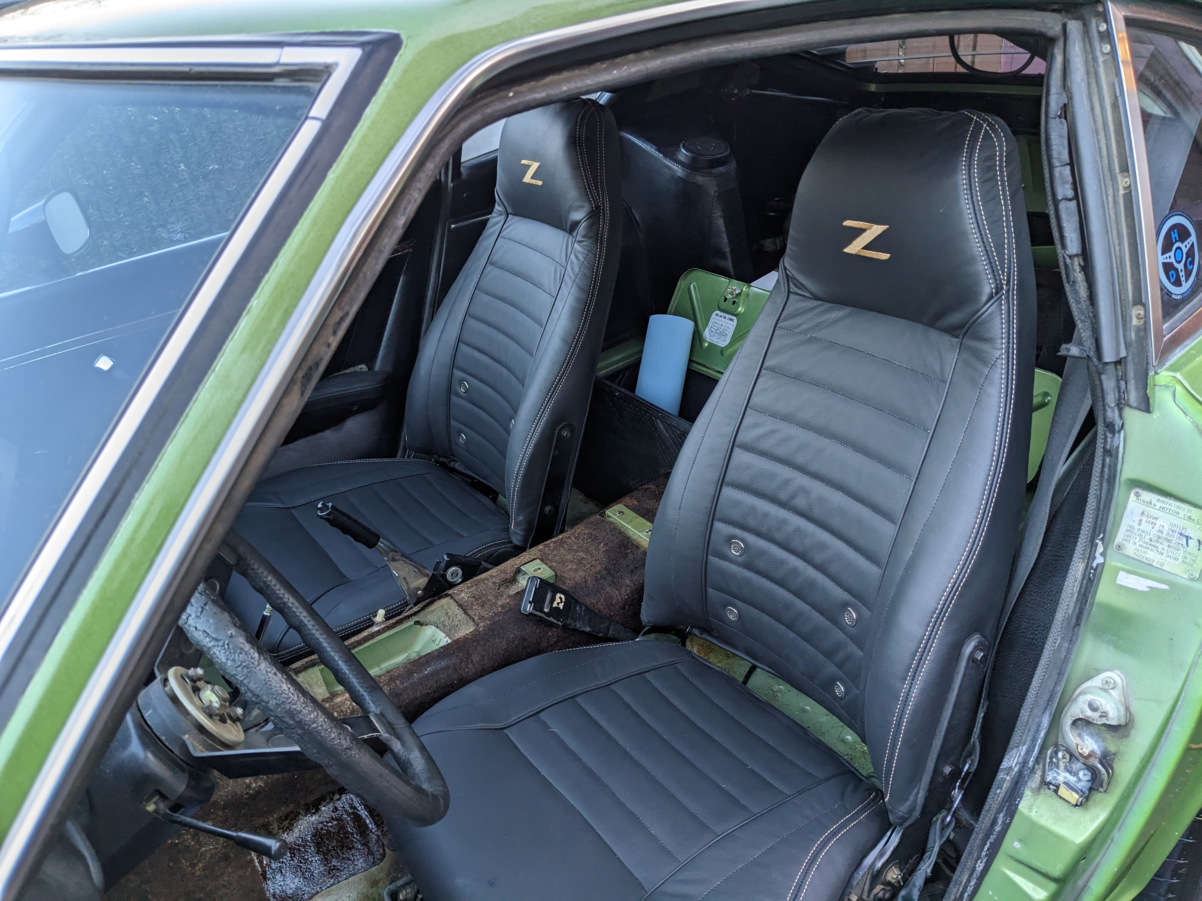

I put them back in the car for now - have to finish cleaning the floors run the heater wiring & put the carpet in before actually installing them

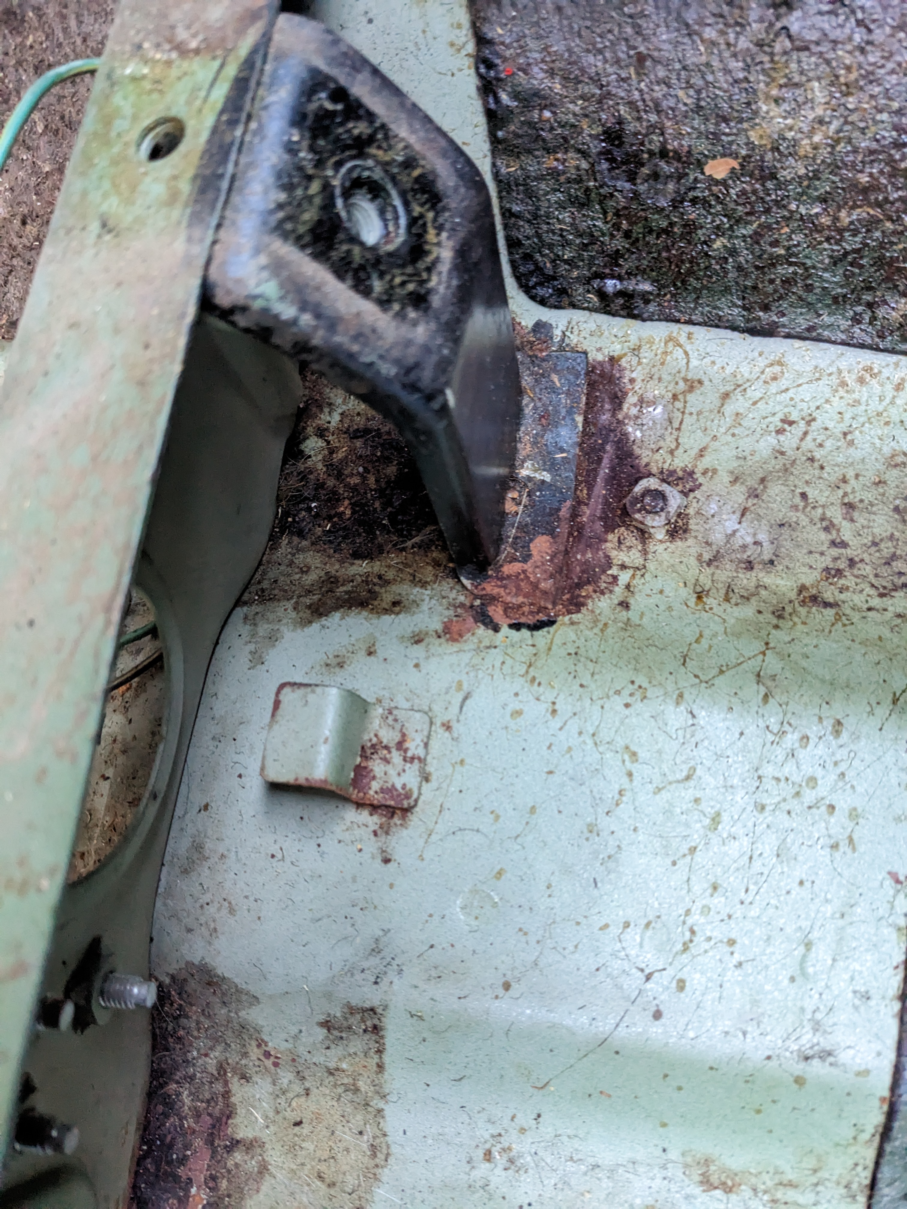

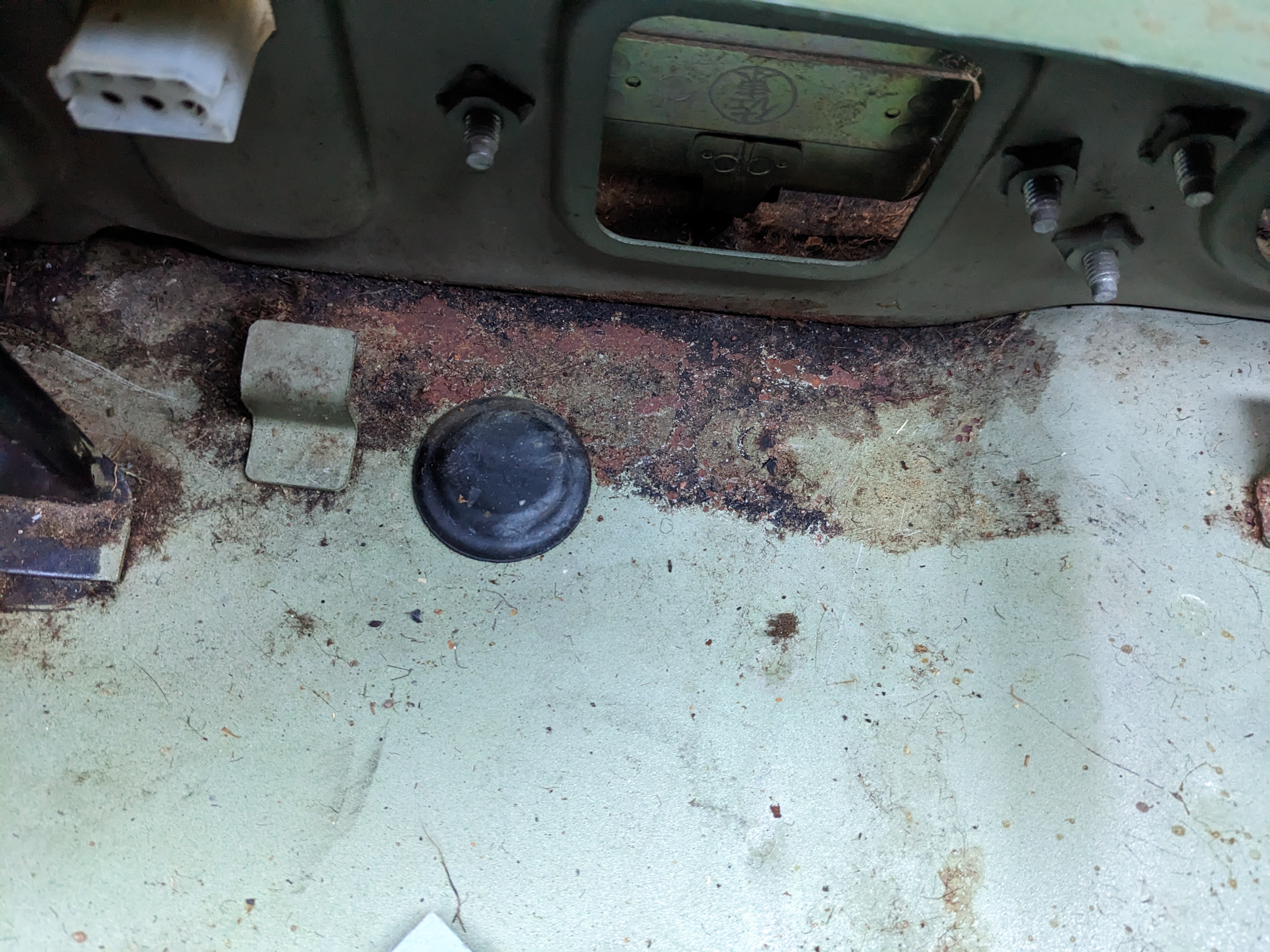

found a small area of surface rust to address on the forward passenger side seat attachment

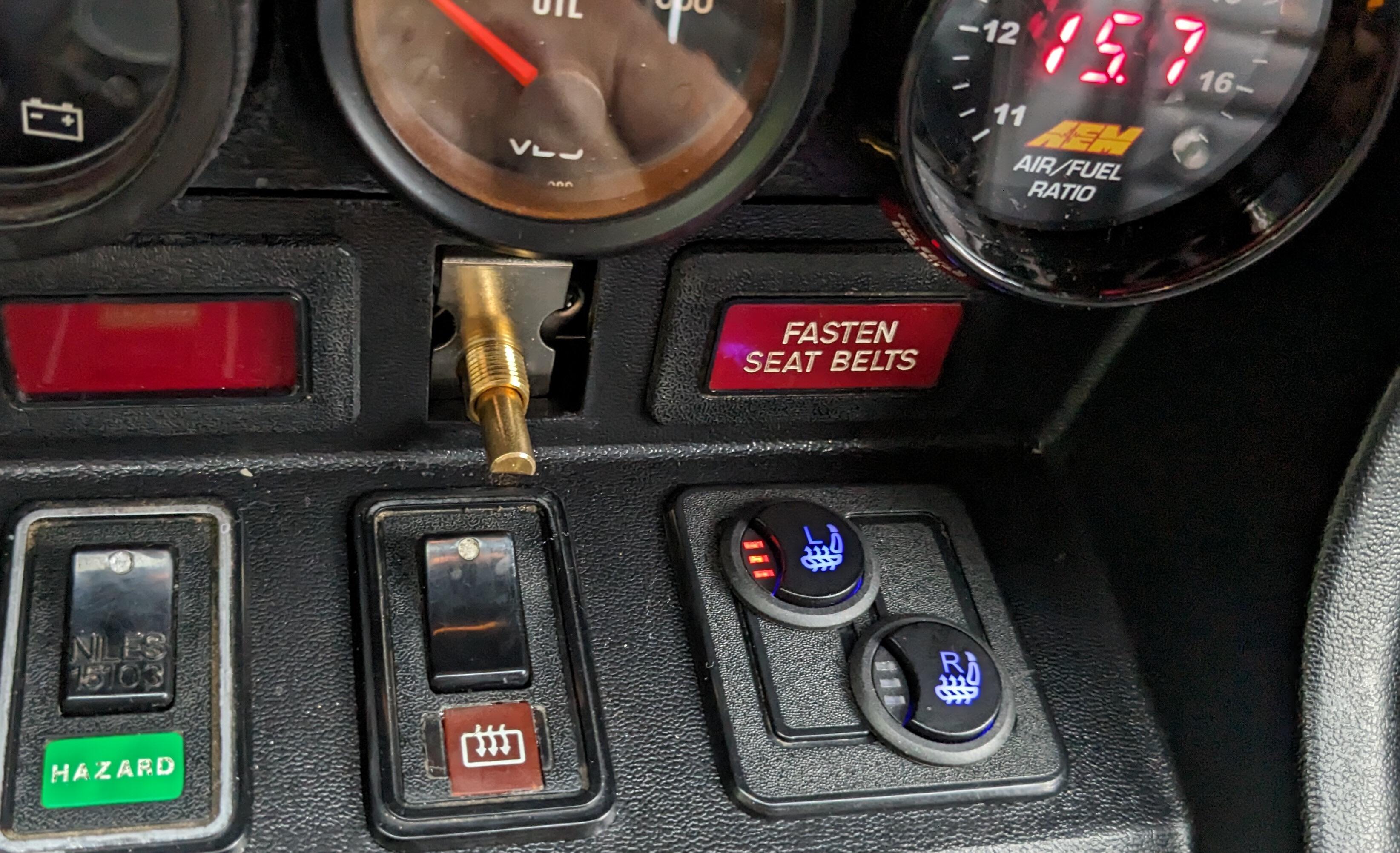

Now that I have the interior going back in, I finally installed the seat heater switches. Didn't want to drill holes in the console itself, so this was the next best option for me
