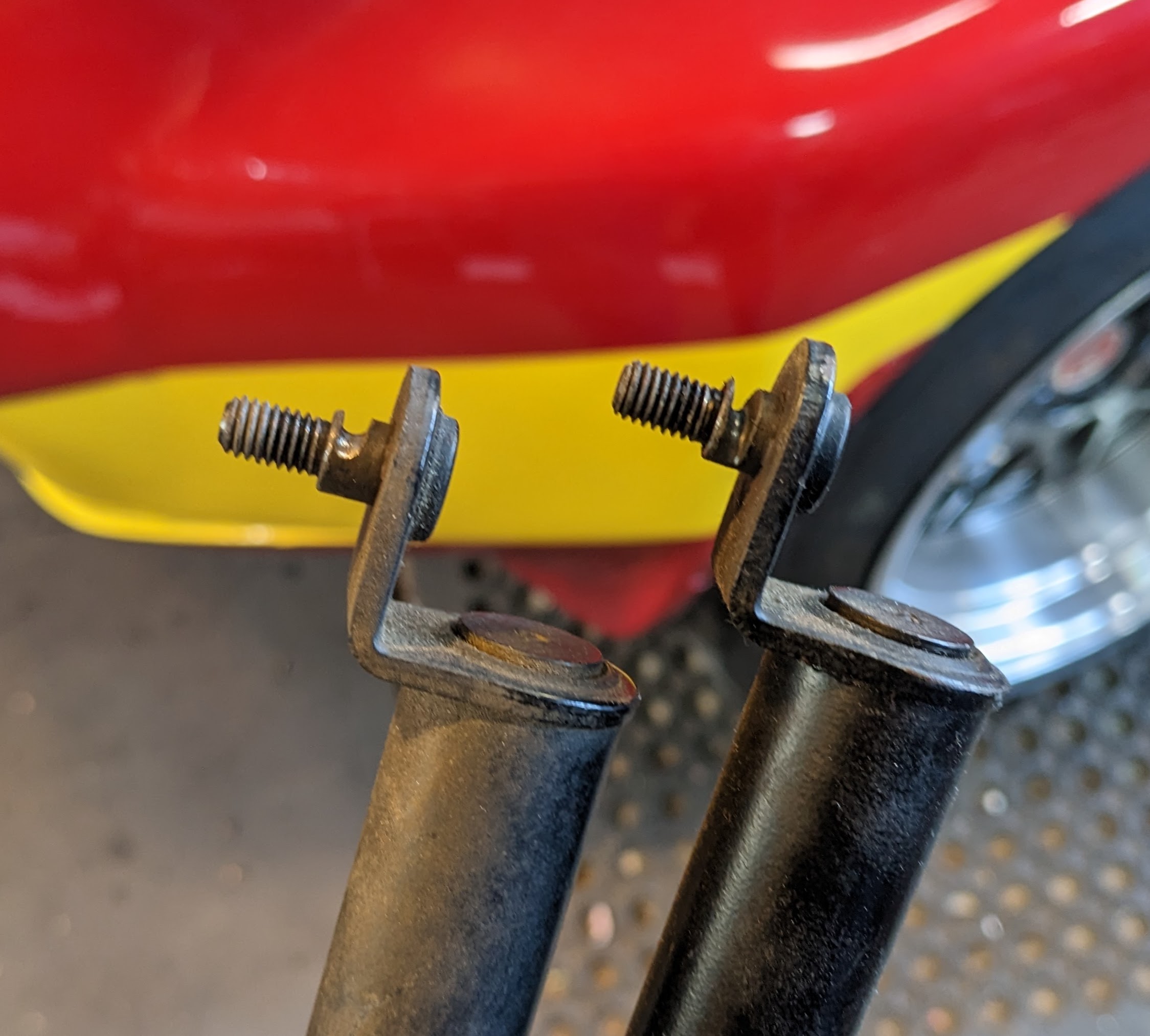

removed rear bracket from the old struts

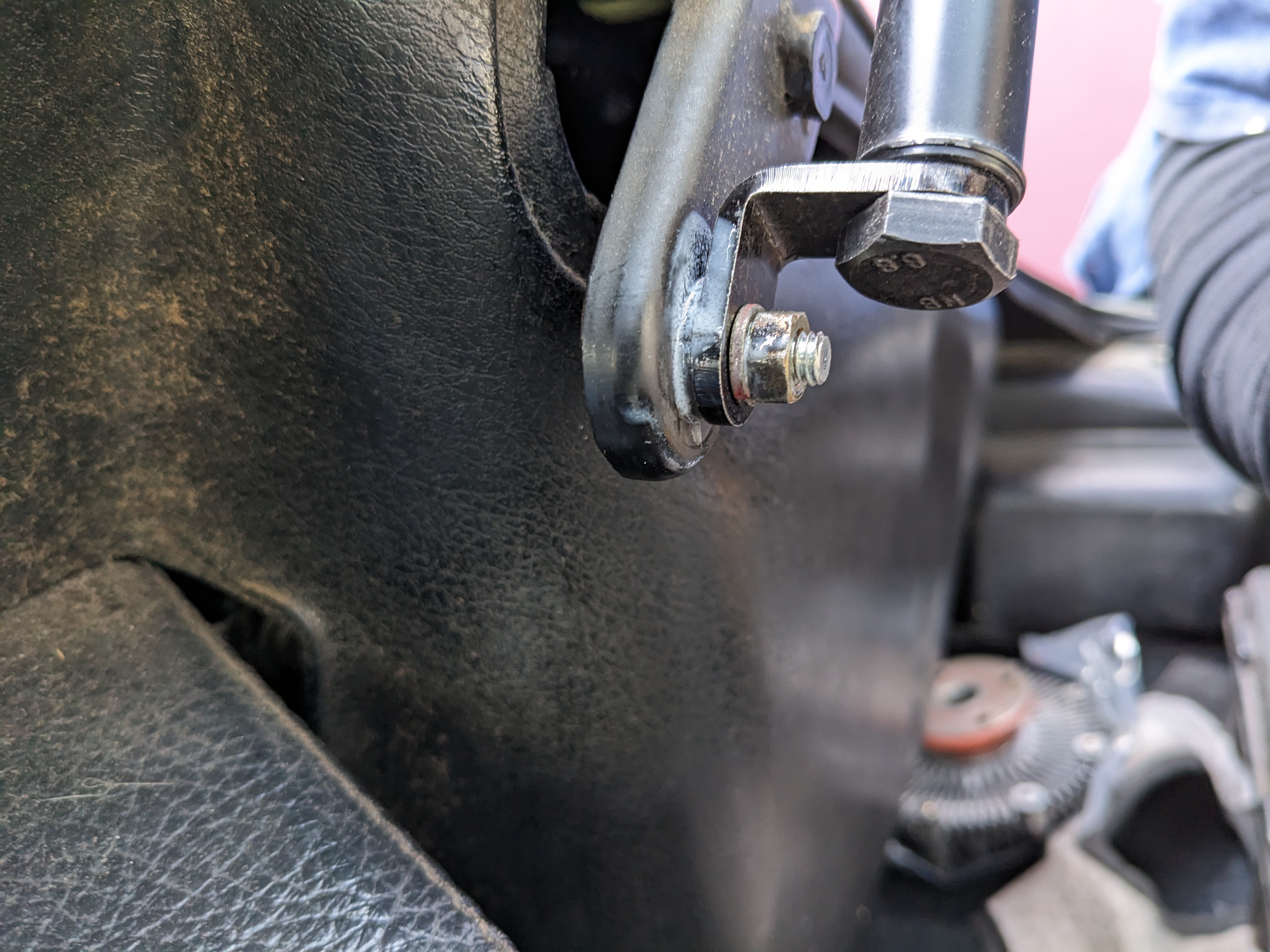

just a little wear on the body side pivot

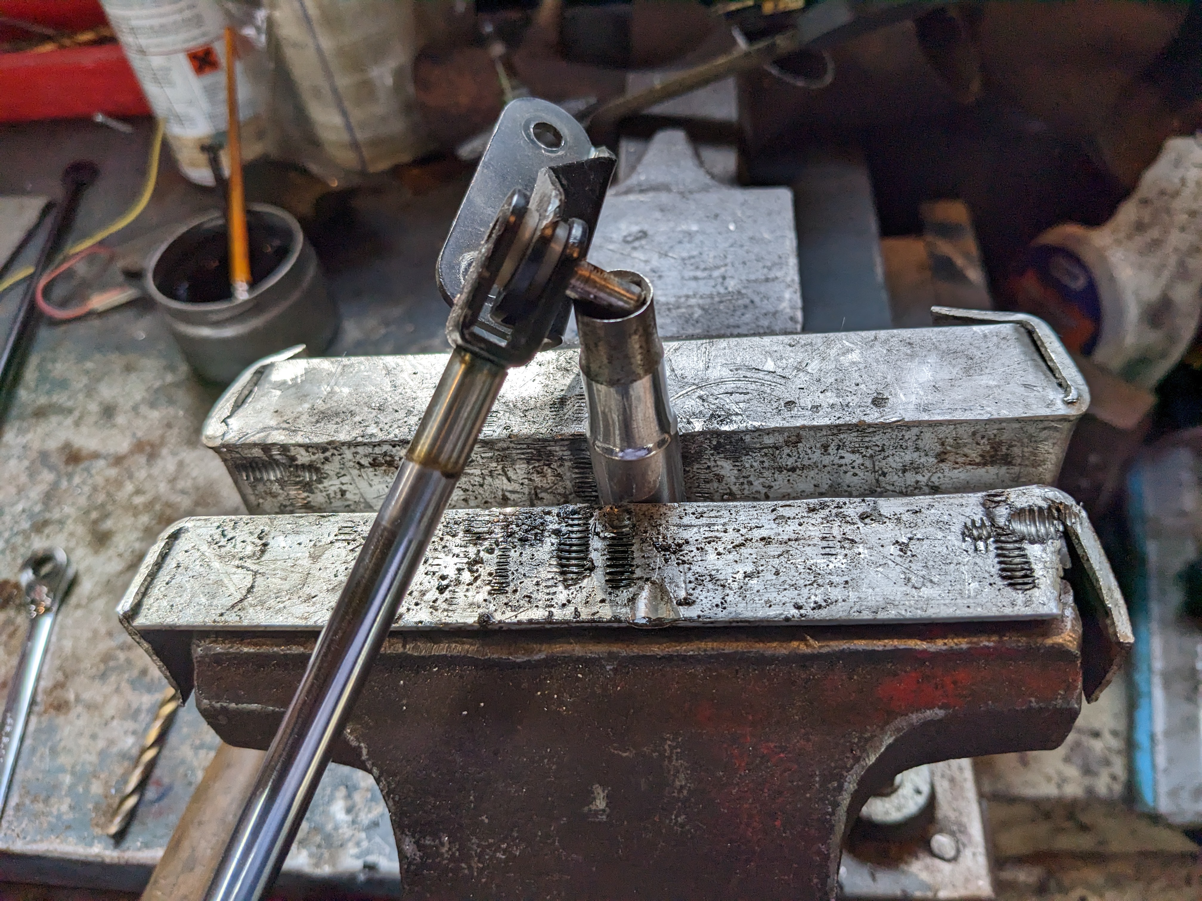

I reused one old bushing on each end of each strut

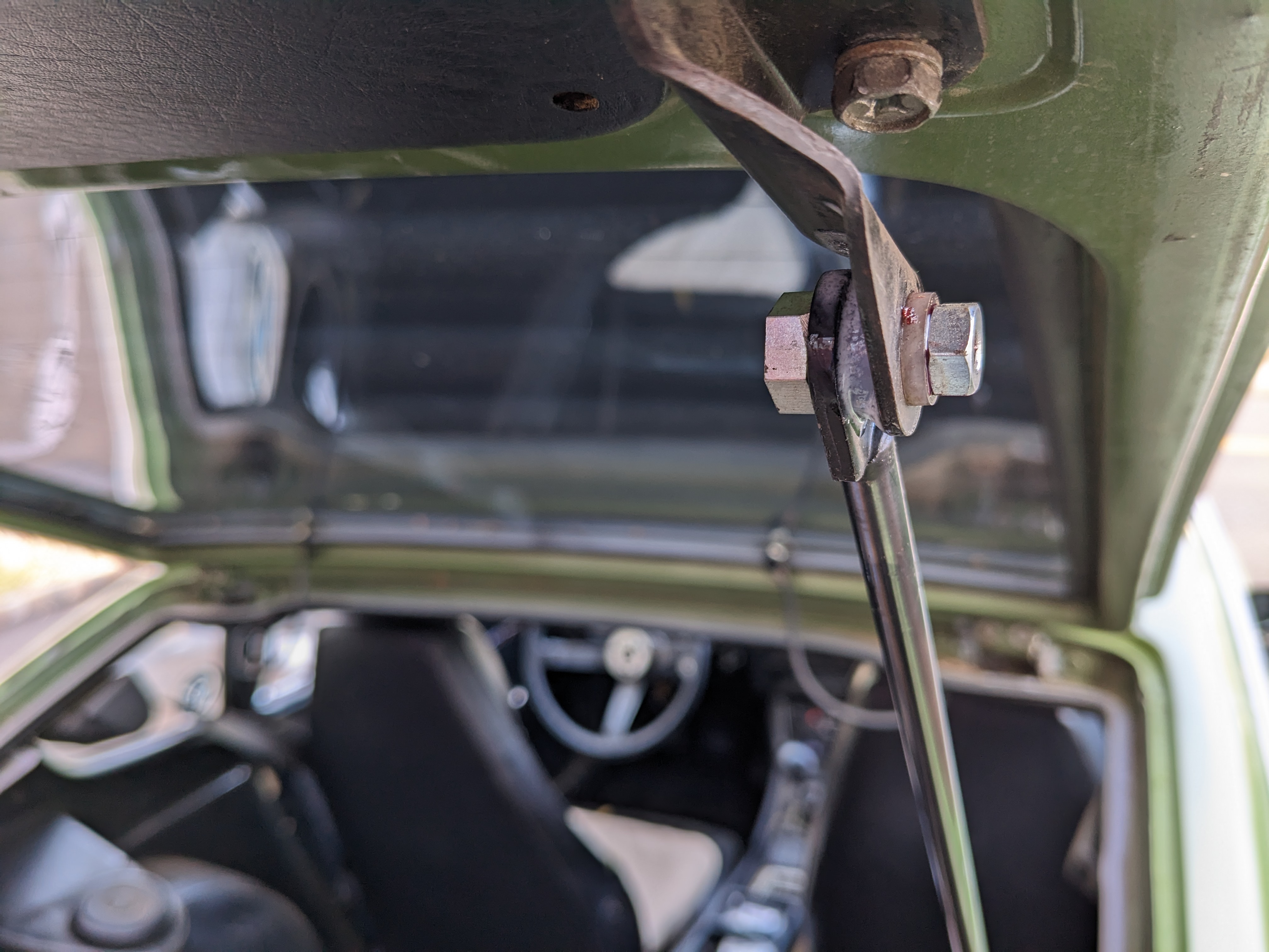

Even with the hatch blind, it now lifts itself once it's lifted about 8-10" off the catch
