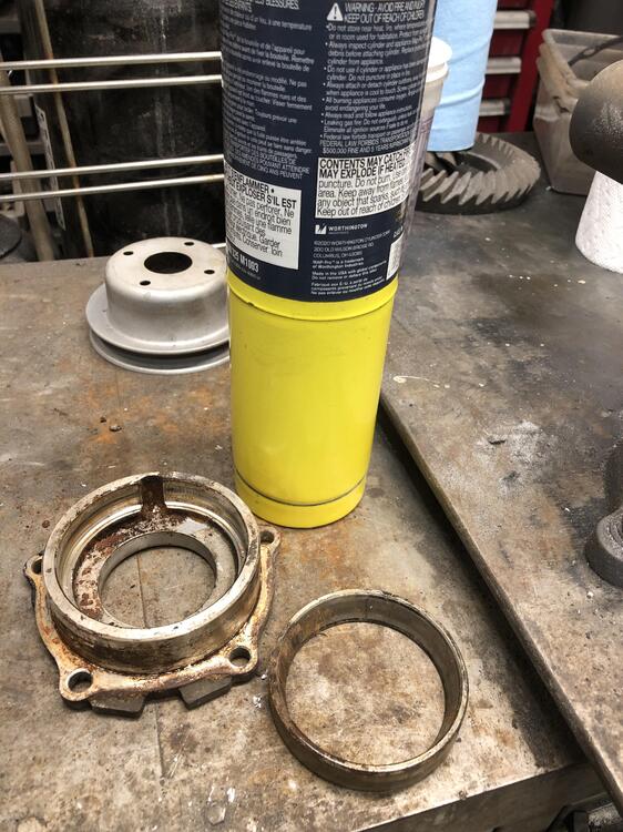

The other day I was tearing into a Subie R160 CLSD that had sustained some rust damage and thought I’d better replace the bearings. When I got to the races in the outer side covers I began my usual anxiety cycle where I think of 11 ways to get them out, but all are risky and start doubting if I can figure it out. The dang covers are aluminum and the races are stell, so there is no bangin’ or rippin’ allowed.
There is no place to just punch them out, the thick edge you have to apply force to is well shrouded. An internal bearing puller might work but you have to rig up a plate to bolt the hole thing to. Bah
After about an hour of going back and forth with ideas, each one more extreme and time consuming than the last, BANG the right way leaped into my heat. Heat. Aluminum expands like crazy compared to steel.
Edited by zKars

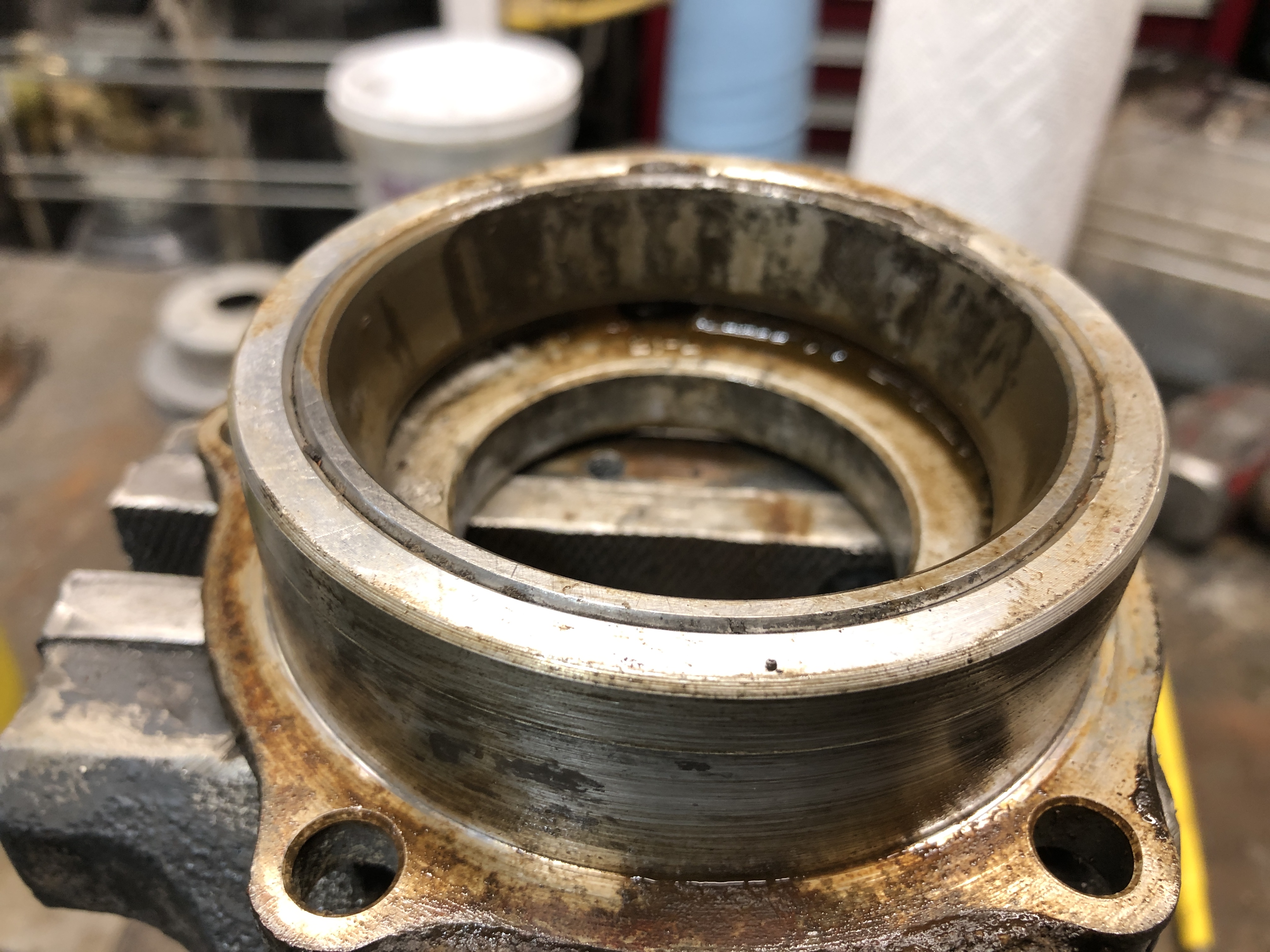

Clamped it in the vice upright, got the MAP gas torch out (propane would be just fine) and warmed up the outer circumference for about 90 seconds. The race just popped out with minimal prying with a flat blade behind it.  5 minutes, both sides done. Bamn!
