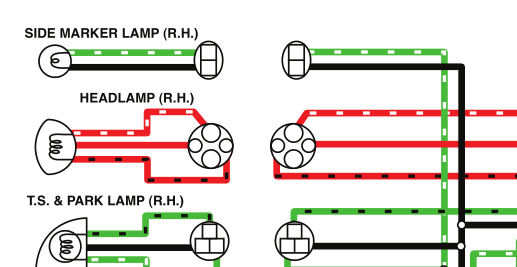

11 hours ago, heyitsrama said:
I'm sure it can be figured out.  I didn't dig in to the diagram.  My brain is stuck on how to interrupt the constant power when the marker lights are on.
"Summary
This procedure will enable the front side marker lights of any car
to blink _with_ the turn signals (if running lights are off) or to
_alternate_ with the turn signals (if running lights are on). Normal
operation of the marker lights is not affected. The procedure works
on any car with parking and turn signal lamps at the front, even if
the turn signals are not dual-filament (#1157/1157A/1157NA) bulbs,
such as on Japanese cars.
Restrictions
The marker lamps must not be single-wire designs which rely on the
car body for grounding. If the marker lamp has two wires connected
(power & ground), the procedure will work."
