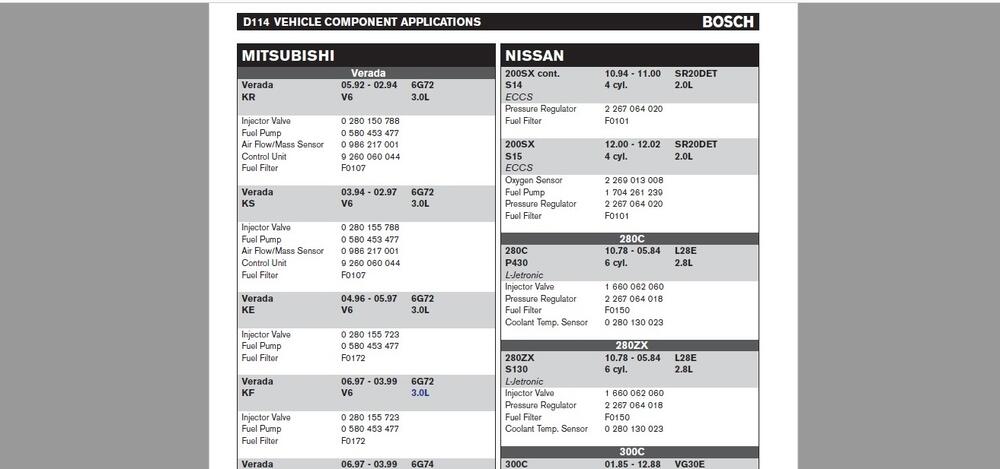

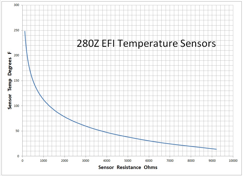

HusseinHolland Posted September 7, 2023 Share #27 Posted September 7, 2023 8 hours ago, Captain Obvious said: I couldn't dig up any data for the 028 on the web. Do you have temp/resistance points from the Volvo service manual for that sensor? The only reference I could find for that sensor in what I have here is that it was used on the Volvo 760. That's the only application data I could find. 760 02.82 - 04.86 V6 2.8L K-Jetronic (Lambda)Coolant Temp. Sensor 0 280 130 028 8/83> I put the Volvo test values in my post above 😁 8500-11500 @ 68ºF 770-1320 @ 176ºF Link to comment Share on other sites More sharing options...

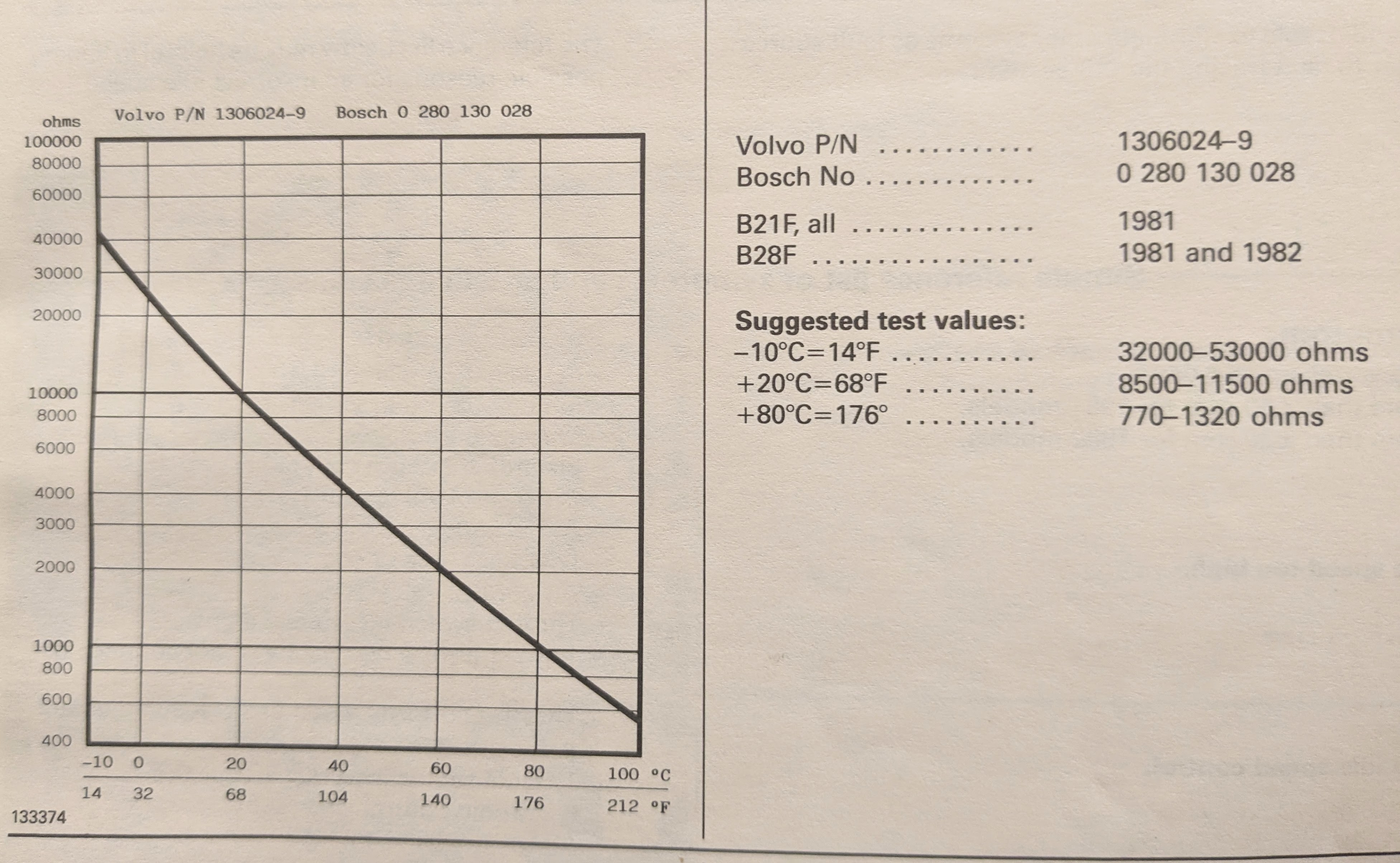

HusseinHolland Posted September 8, 2023 Share #30 Posted September 8, 2023 On 9/6/2023 at 10:12 AM, Captain Obvious said: Here's an excerpt from an old Bosch catalog that indicates that the 280ZX (which is the same as the 280Z) uses the 0 280 130 023: And here's a chart I derived from the resistance points found in the Z service manuals: OK - so I already installed the one 028 sensor in the cooling system, so I searched through my Volvo manuals, and found the chart - the axis is reversed compared to yours. it's much more linear though Link to comment Share on other sites More sharing options...

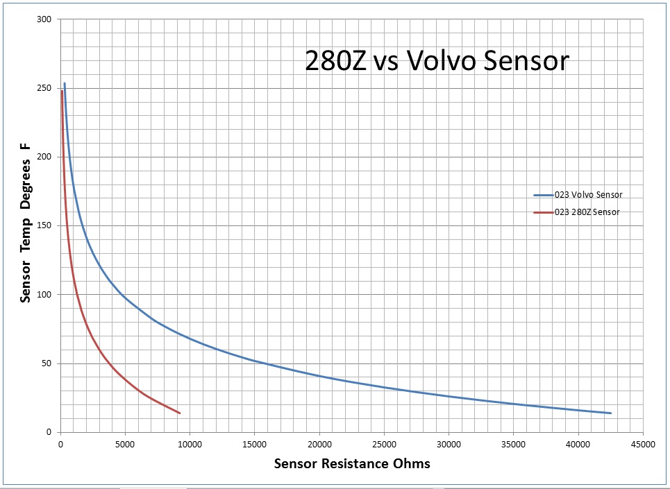

Captain Obvious Posted September 10, 2023 Share #32 Posted September 10, 2023 Here's a chart comparing the 023 (Z sensor) and the 028 (Volvo sensor). If you do some water bath testing on either sensor, let me know how the testing compares to the chart: 1 Link to comment Share on other sites More sharing options...
