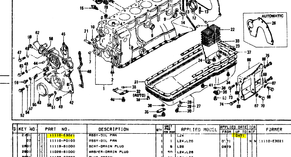

Does anyone have a comparison photo of these two type oil pans?
Thanks,
Keith

No problem, it's interesting that the earlier part number, 11110-E3021 that applies up to 04/71, has two versions. The initial version was used in early 1970 and is on some mid 1970 cars like mine. These early ones have a brazed on reinforcement plate and the drain plug is in a different location.
