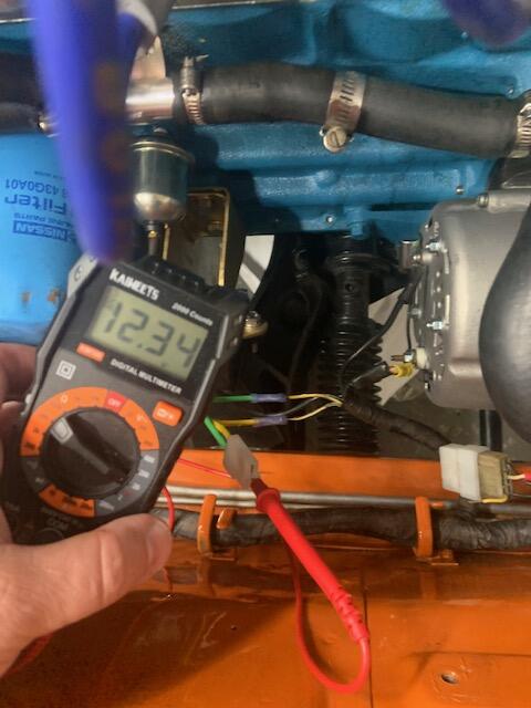

with battery connected and key off
s terminal is at 12.34 (as expected)
L terminal  at .01 (as expected)

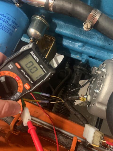

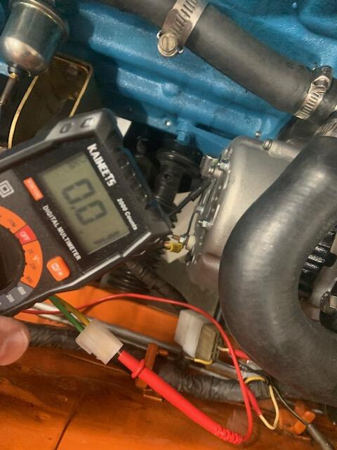

with battery connected and key on
at L terminal .01 (not expected, battery voltage)

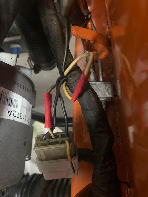

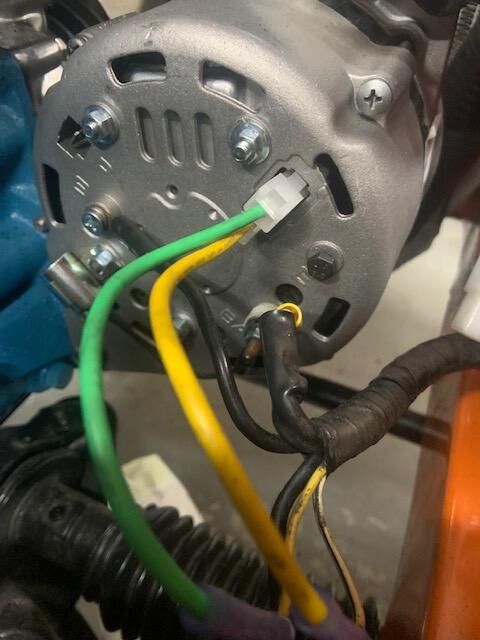

I am including some images of me using meter with results. Also a couple of connections.
Not sure where to go from here. If i had to "guess" i would say i likely messed up the
alternator conversion plug somehow

If I were to hazard a guess, I would say you have your diode backwards on the L terminal circuit. The other alternative is that there is a bad connection in the circuit.
