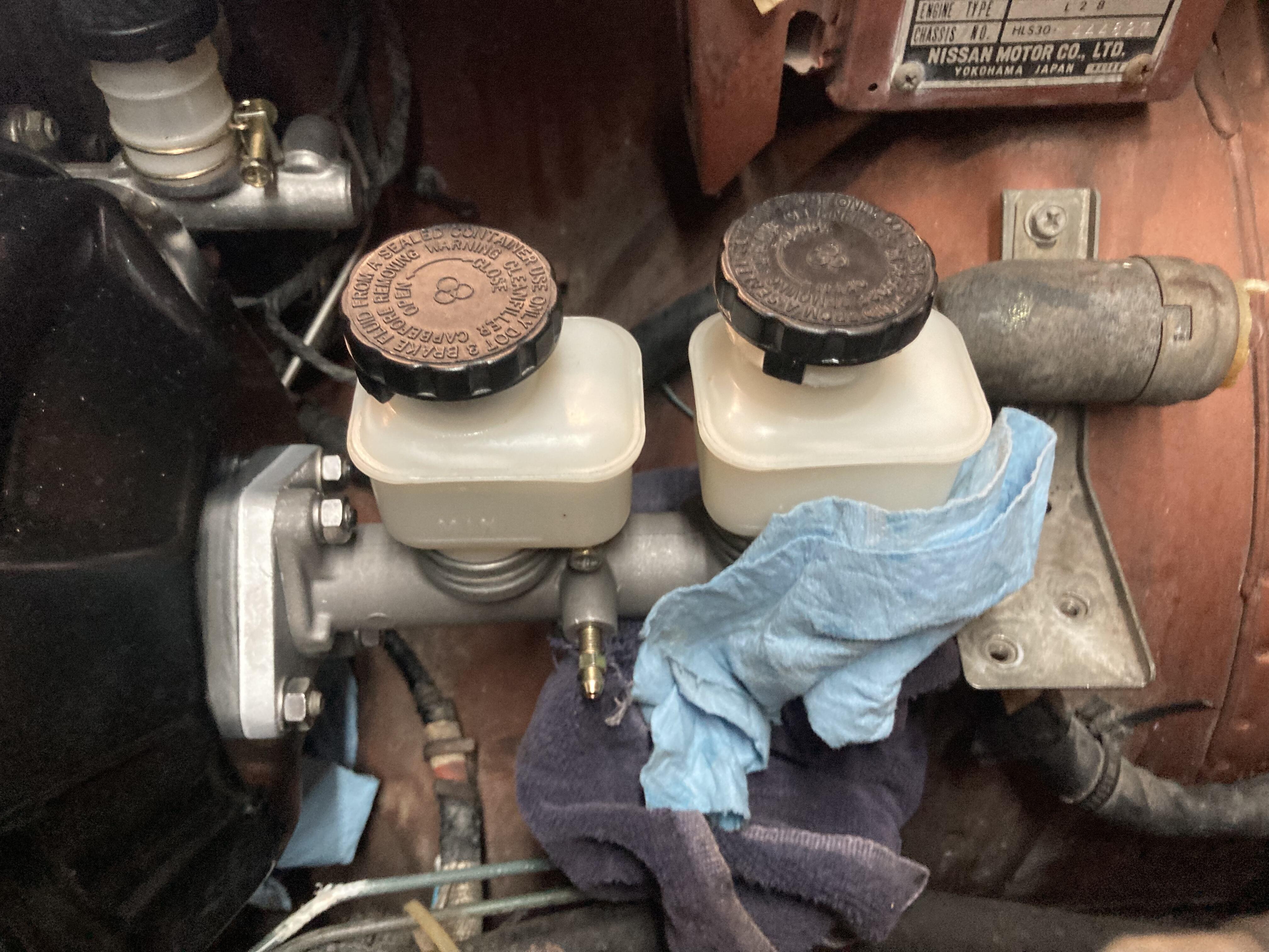

Looking for a replacement reservoir. Mine has a hair line crack which is not visible. Leaking around the clamp area.

These are pretty close to stock, but have threaded caps. Edit: Another slight difference is that these do not have a horizontal “seam” in the plastic like the originals. These work for my ZX, not positive the earlier ones are the same size.
https://www.pegasusautoracing.com/productselection.asp?Product=3558&utm_source=google&utm_medium=cpc&utm_campaign=3558&gclid=EAIaIQobChMI_aS83ZzR7AIVho3ICh03PQJiEAQYASABEgLM5PD_BwE
Ordered the tanks,caps,clamps and inserts from Pegasus. Thanks @mailnomefor the information. $50 including shipping. Hopefully this will resolve the leak. I will report back once installed.

How did they work out for you?
I guess you mean the screens by “inserts”?
I must have misread their description for the screens. I thought they only fit the large and medium, but now realize the small should work.
They worked perfectly like they were made for the car. Sorry, got caught up on next issue and forgot to report back. So anyone looking for reservoir's this is the answer to your problem. Thanks for the help. Saved the day. Working on clogged/corroded NP valve at the fire wall.
