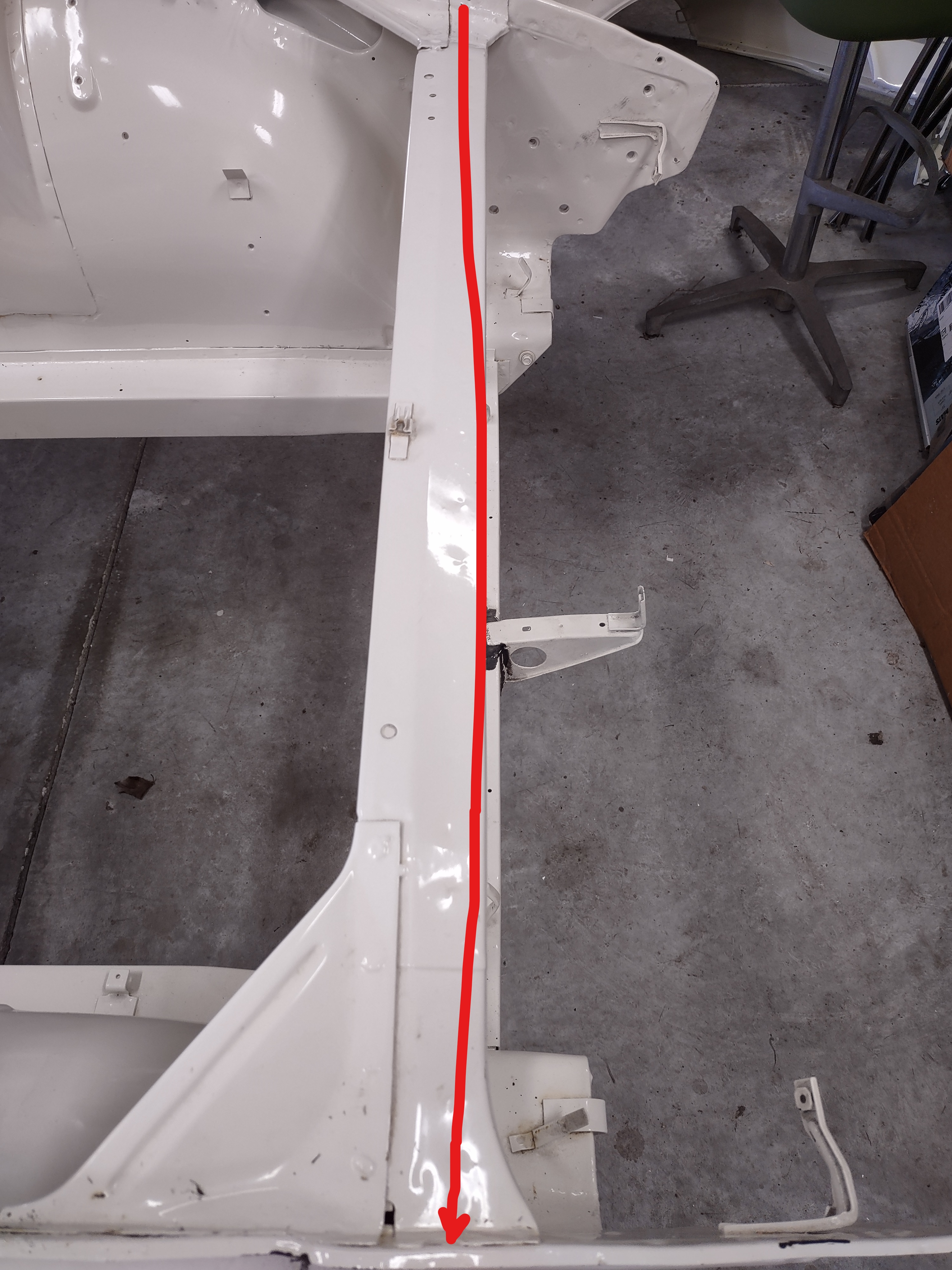

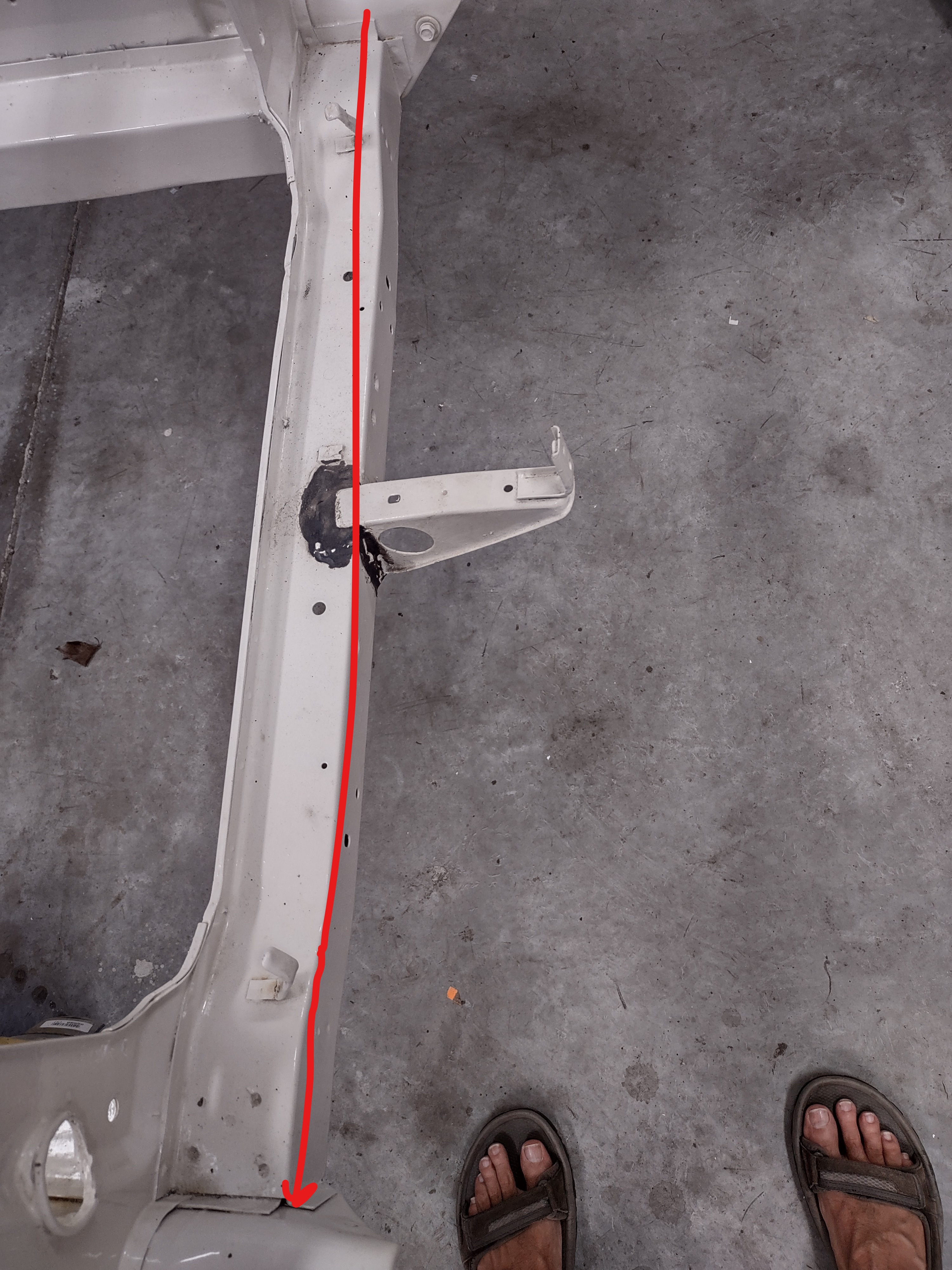

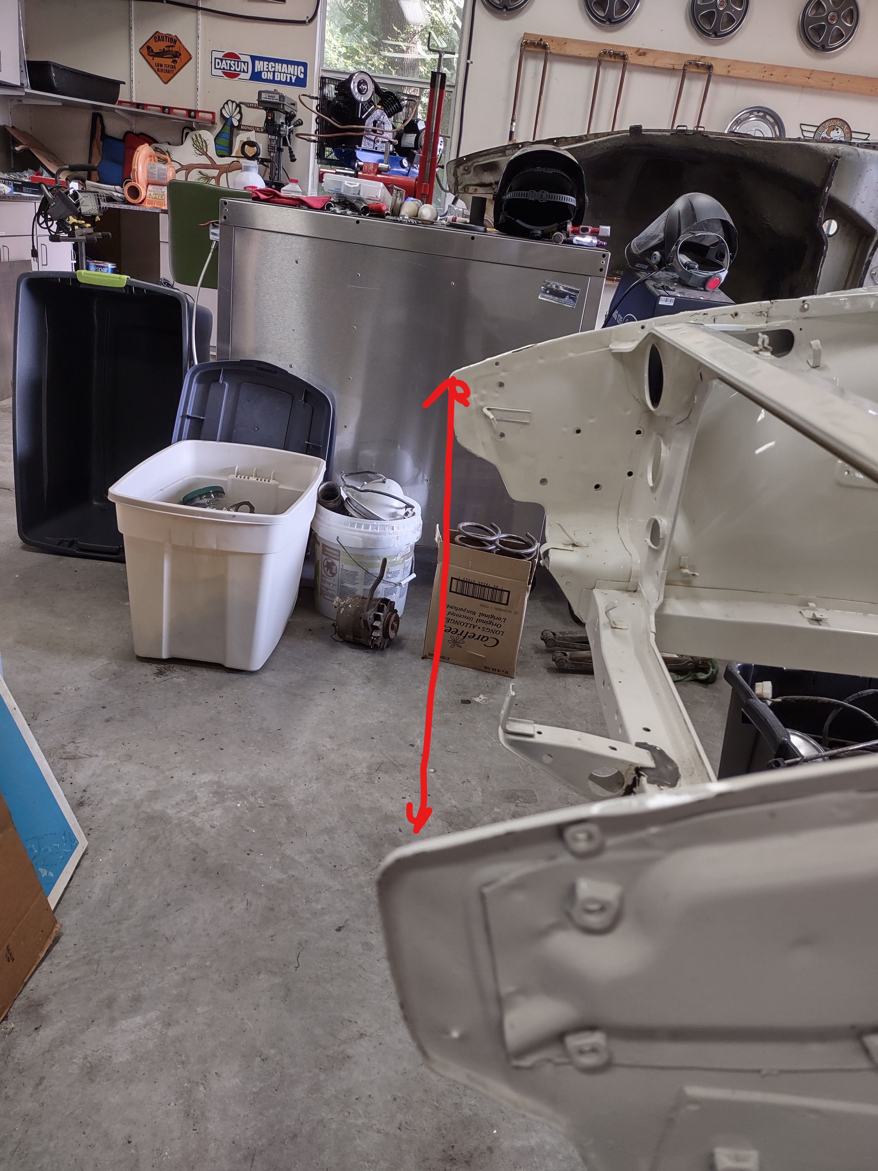

Posted October 12, 20213 yr comment_629903 Looking for measurements on the following. This is an early VIN car under 1000, not sure if that matters if its series 1-3. Thanks. Link to comment https://www.classiczcars.com/forums/topic/65927-measurement-request/ Share on other sites More sharing options...
October 12, 20213 yr comment_629909 So, I have 1973 240z - not aware of any differences that would affect these measurements. Across the radiator support your image #3 -39 3/4 in. Your image #1 - 39 5/16" Your image #2 - 39 1/2" If this satisfies you - great - If you need really accurate measurements then let me know and I will dig out the laser and get some batteries in it. edit: Okay so I went back with the laser: your image #1 measured 39 5/16" your image #2 measured 39 1/2" your image #3 measured 39 3/4" now realize: my hood is attached and generally aligned my fenders are not fastened to the body my grill, bumper, and valence are not mounted Hope this helps Just curious what issue are you trying to resolve? Edited October 12, 20213 yr by qz16 Link to comment https://www.classiczcars.com/forums/topic/65927-measurement-request/#findComment-629909 Share on other sites More sharing options...
October 12, 20213 yr Author comment_629916 3 hours ago, qz16 said: So, I have 1973 240z - not aware of any differences that would affect these measurements. Across the radiator support your image #3 -39 3/4 in. Your image #1 - 39 5/16" Your image #2 - 39 1/2" If this satisfies you - great - If you need really accurate measurements then let me know and I will dig out the laser and get some batteries in it. Awesome, thats perfect. Thank you. Link to comment https://www.classiczcars.com/forums/topic/65927-measurement-request/#findComment-629916 Share on other sites More sharing options...
