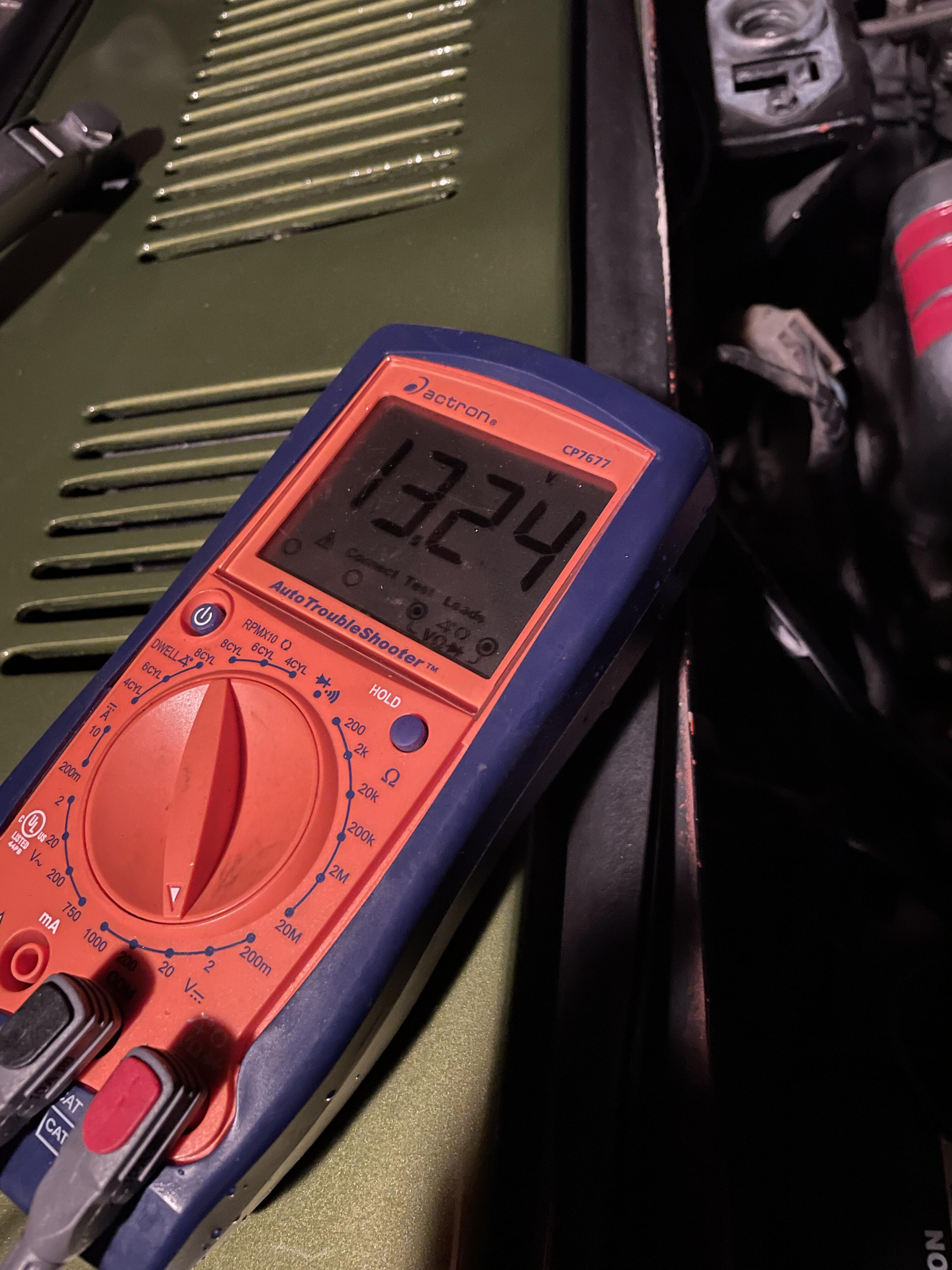

Welp, I don't know what I'm doing wrong here, but I obviously have something wired improperly. When I try to fire the car, I get no cranks, and all lights go blank. With the key at the accessory position,  lights come on, and I hear the fuel pump run. Everything goes immediately dark if I try to start. Here's my specs:
-all fuses have continuity
-new starter motor
-proper motorsport auto 6 pin adapter for internally regulated alternator
-battery on trickle charger for 3 days straight; reads over 13V once removed from charger
I'm sorry to be the problem child here;  really stumped here. Any help appreciated.

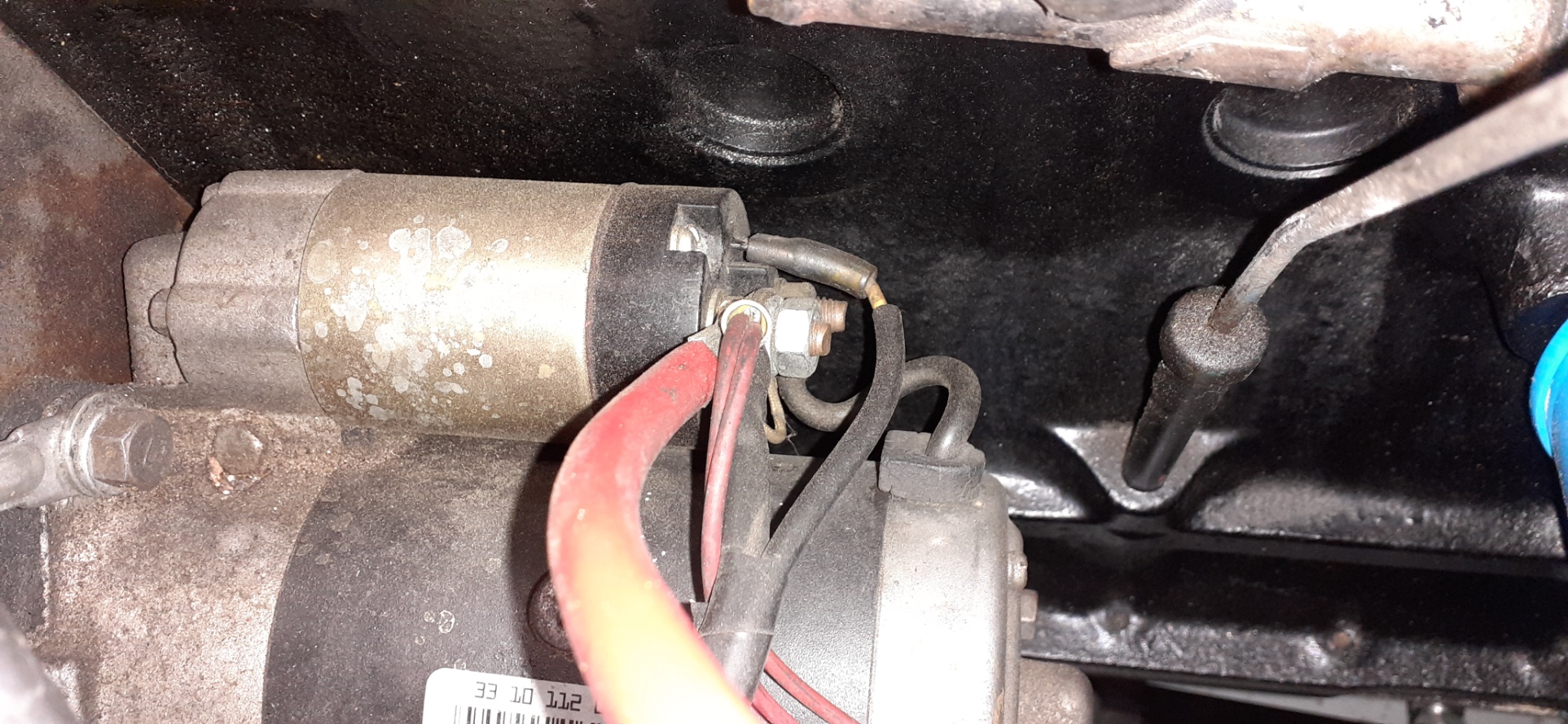

I can see the black/yellow wire going to the solenoid in you last photo, but the solenoid is partially obscured by the heater hose.

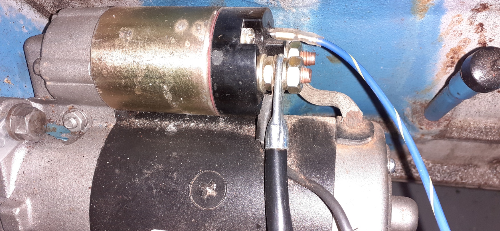

Here is the solenoid power connection in my cars. In the first photo, the solenoid wire is the blue/yellow wire with the insulated connector. In the second photo, it is the yellow wire with the insulated connector and black insulating sheath. The smaller gauge red wires are for my headlight relays.

Occams razor reared its' head on this one, I think. The problem was the battery....I replaced it with a new battery, and the car cranks fast and strong. When I saw the voltage reading, I assumed it was sufficient, but it doesnt look like it could move enough amperage fast enough to turn the engine over. Thanks so much for your help folks!
