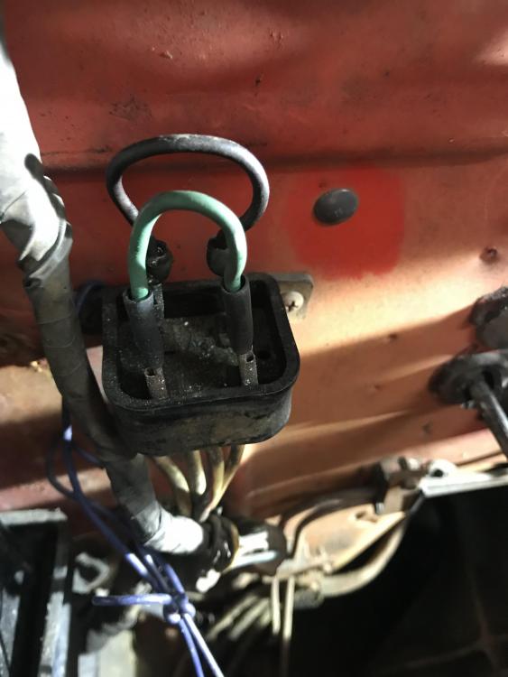

June 21, 20214 yr Author comment_623891 Ok. Here is a photo of these links.  With the key to the power position. Car not running. Should I have power going across those? I touched the power indicator screw driver with bulb across those and no light bulb turning on. how can I test power there? Link to comment https://www.classiczcars.com/forums/topic/65522-260z-horn-signals-wipers-not-working/?&page=2#findComment-623891 Share on other sites More sharing options...

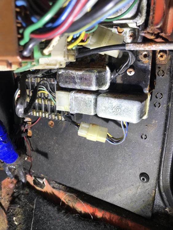

June 21, 20214 yr Author comment_623893 And these relays. Â Link to comment https://www.classiczcars.com/forums/topic/65522-260z-horn-signals-wipers-not-working/?&page=2#findComment-623893 Share on other sites More sharing options...
June 21, 20214 yr comment_623900 54 minutes ago, Shawninvancouver said: Ok. Here is a photo of these links.  With the key to the power position. Car not running. Should I have power going across those? I touched the power indicator screw driver with bulb across those and no light bulb turning on. how can I test power there? Put one end on a terminal (link end) and the other end on a ground, like the block, or a body screw. With the key on you should get a light on all of them. You won't get a light (power) going across them unless there is a device turned on inside the car. Link to comment https://www.classiczcars.com/forums/topic/65522-260z-horn-signals-wipers-not-working/?&page=2#findComment-623900 Share on other sites More sharing options...
June 21, 20214 yr Author comment_623901 there are 2 fusible links on the firewall beside the battery.. a green one and a black one... when key is on the green one has power going to it and going across it.. link is ok..  the black one has NO power going to it with the key one..  is there a problem or does that one only get power when car is running??    Link to comment https://www.classiczcars.com/forums/topic/65522-260z-horn-signals-wipers-not-working/?&page=2#findComment-623901 Share on other sites More sharing options...

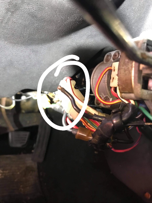

June 22, 20214 yr Author comment_623915 Where in the world could this black wire go?? Link to comment https://www.classiczcars.com/forums/topic/65522-260z-horn-signals-wipers-not-working/?&page=2#findComment-623915 Share on other sites More sharing options...
