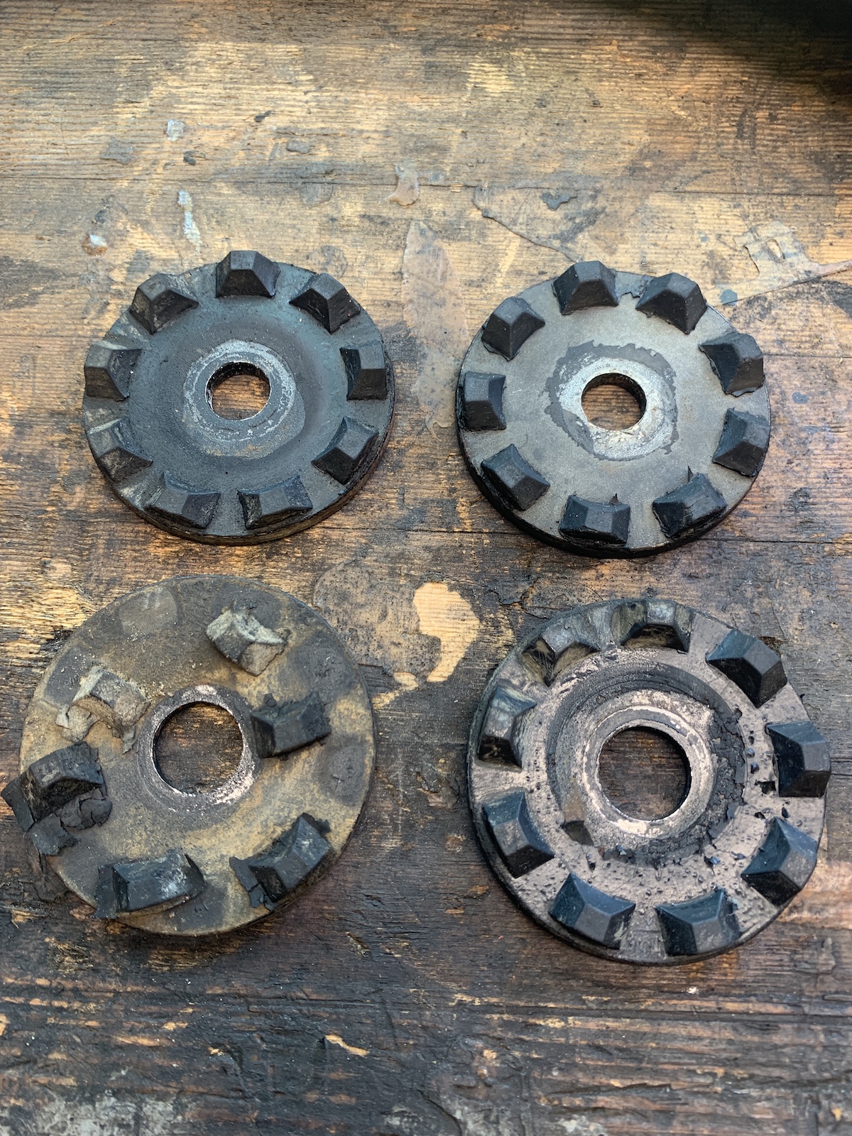

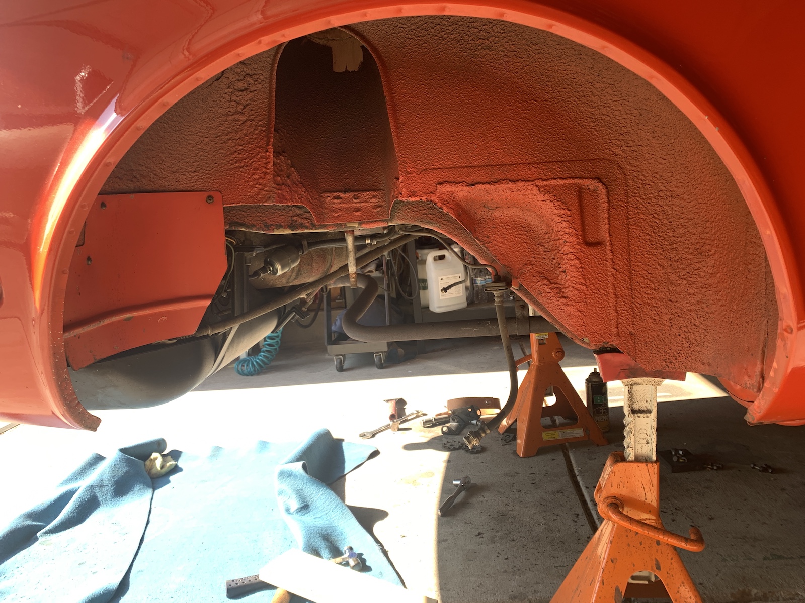

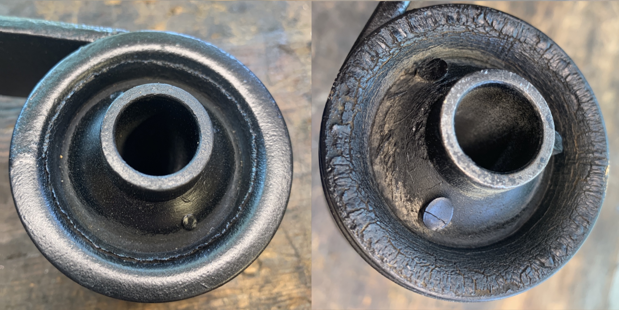

July 11, 20214 yr Author Popular Post comment_624910 Cleaned up the rear wheel wells with soap and a scrub brush, turned out pretty good. Dealing with the mustache bar now, to get the differential in place so I can adjust the bushing on the new TC front mount I bought. I've read a few mustache bar links here, pro's and cons of replacing the bushings, the nonexistent serrated rubber washers, etc. The bushings in mine seem good, not too hardened, so I don't want to replace with poly for now. The washers on the other hand, not so fortunate. While cleaning in my solvent tank some of the rubber nubs fell off, and a few were already missing. I know these are no longer available, but was wondering if anything has changed in the last couple years since those last posts? It seems to me that these washers only come into play as the differential attempts to twist, and there's an 1/8" gap between them, IMHO they're just added insurance in case of complete bushing failure. I suppose with a healthy engine there would be occasional contact, especially with new soft rubber bushings. I could be wrong. Anyway, just wondering what others are doing for the washers for the stock rubber bushing setup. Fabricate your own? Motor mount washer substitution of some sort? Use as is and forget about it? On another note, I wish the TC mounting bracket had a little more clearance next to the brake/fuel line bracket! I did ground out a little notch for added room, but just another 1/8" more in that dogleg bend would have been really helpful. I had to use a bottle jack to wedge it into place. [emoji53] And, got most of the fasteners decently plated using my home Caswell system, not perfect. About 4 hours work here for cleaning and plating. Link to comment https://www.classiczcars.com/forums/topic/65437-another-suspension-rebuild/?&page=4#findComment-624910 Share on other sites More sharing options...

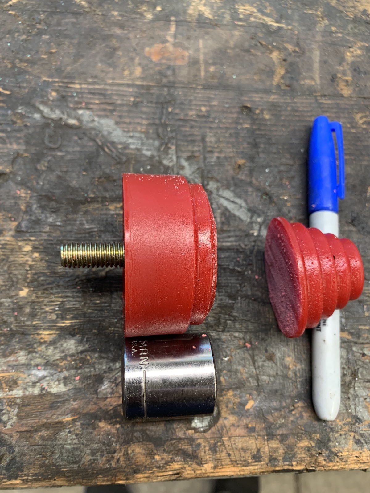

July 23, 20214 yr Author comment_625538 I'm back from a trip to Wyoming, need to get moving on this. Got everything cleaned up, ready to bolt in. Mounted the differential so I could measure and cut the TC mount bushing. I tried a few sockets to stick between the mount and diff housing to get a measurement with about an 1/8" gap. Using new front lower mount. Then I busted that little plastic breather vent 😠, so I'm ordering another one of those from the dealer. New Koni's, Eibach springs, and axle bearings installed. Link to comment https://www.classiczcars.com/forums/topic/65437-another-suspension-rebuild/?&page=4#findComment-625538 Share on other sites More sharing options...

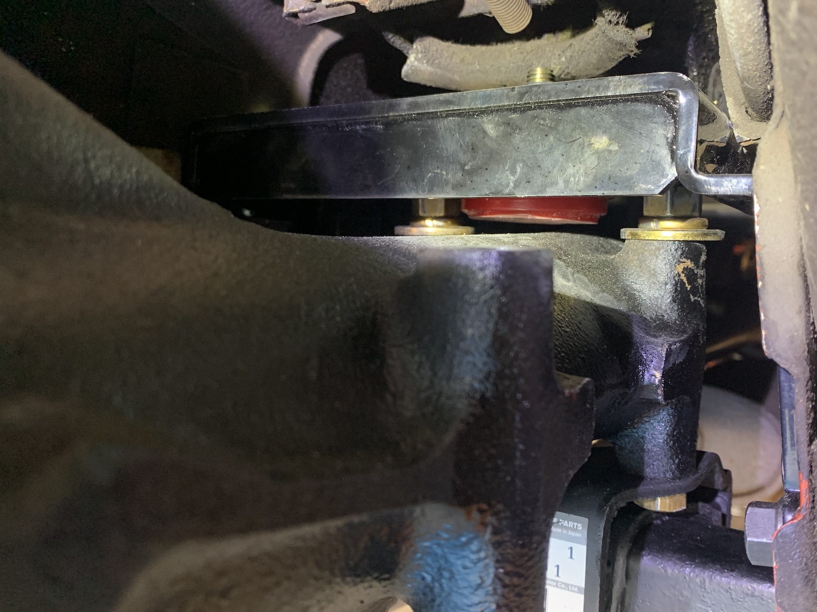

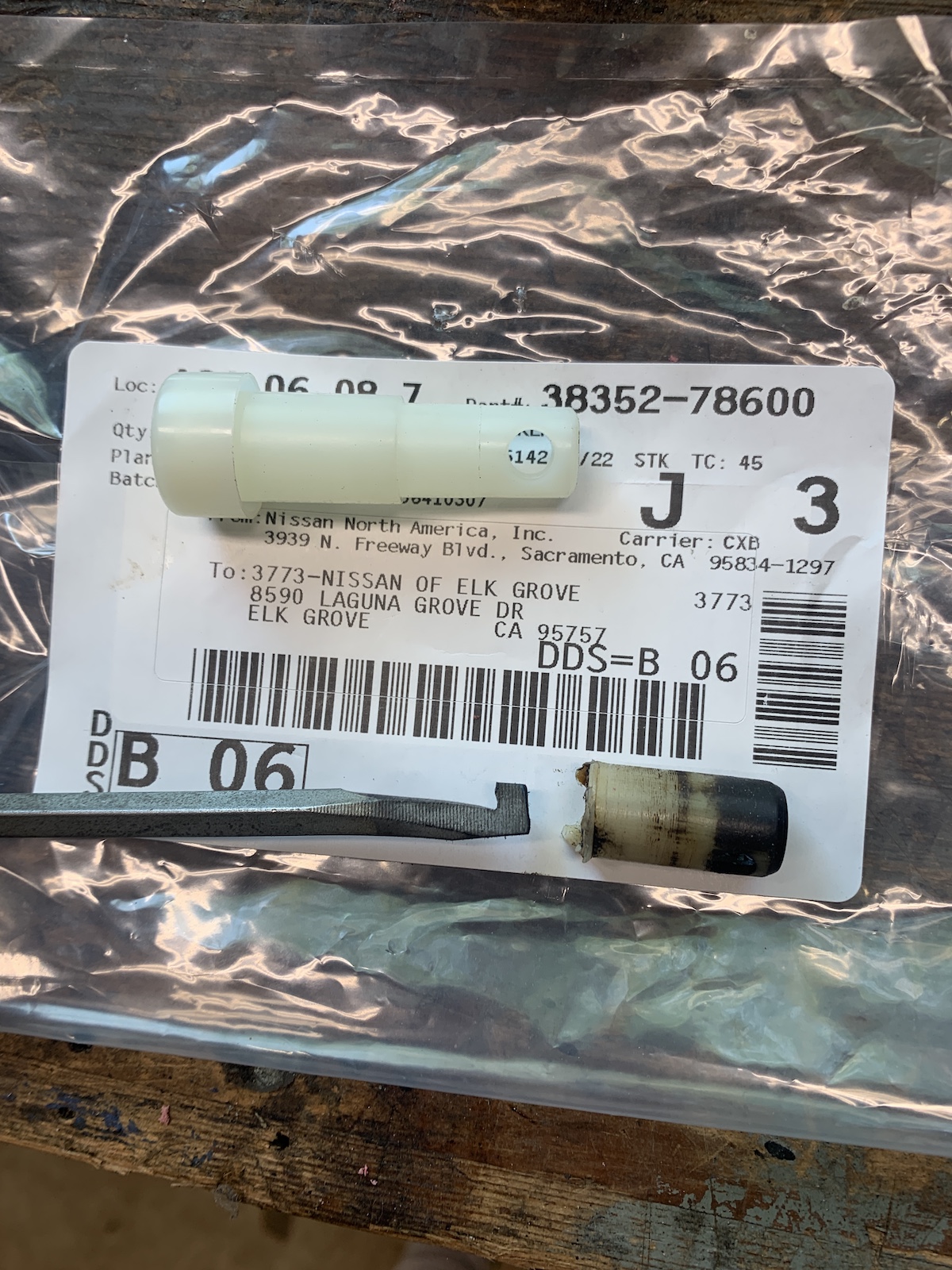

July 25, 20214 yr Author comment_625689 I modified an old screwdriver to help remove the broken off breather vent. Basically catch the top of the sideway holes and pull up. New 38352-78600 is $7 from dealer. Here's a pic of the TC mount clearance. Hard to believe the factory used a belt instead of something like this. Link to comment https://www.classiczcars.com/forums/topic/65437-another-suspension-rebuild/?&page=4#findComment-625689 Share on other sites More sharing options...

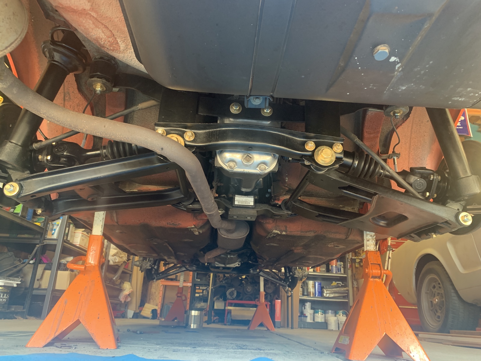

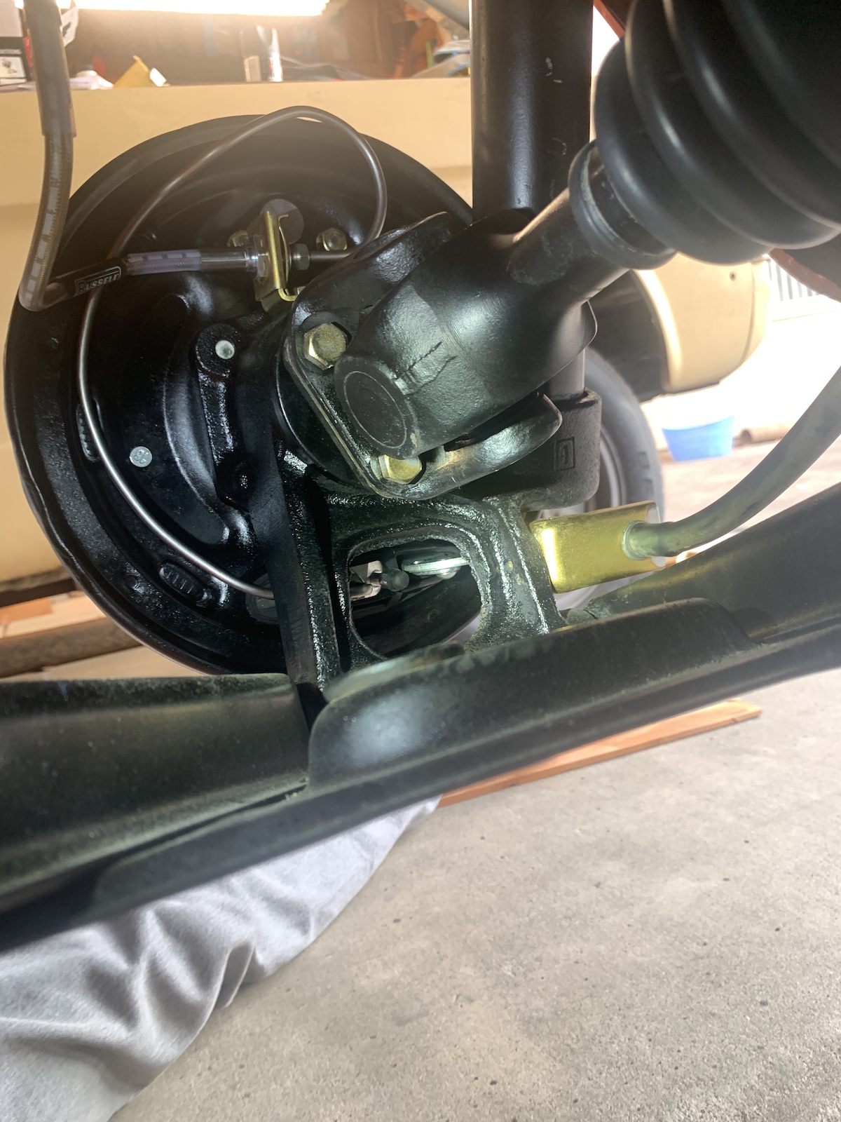

July 25, 20214 yr Author comment_625712 Rear suspension is back together. Not sure how loose others leave the inner bushing brackets so they can be tightened with wheels on the ground, but I left about an 1/8" gap between brackets and frame. Spindle nuts are loose too. I guess I should start looking for an exhaust system, pretty rusty, saw a few small holes in the pipe. It has Nichira mufflers, looks like they're date coded Dec-84. Now onto the rear brakes. Link to comment https://www.classiczcars.com/forums/topic/65437-another-suspension-rebuild/?&page=4#findComment-625712 Share on other sites More sharing options...

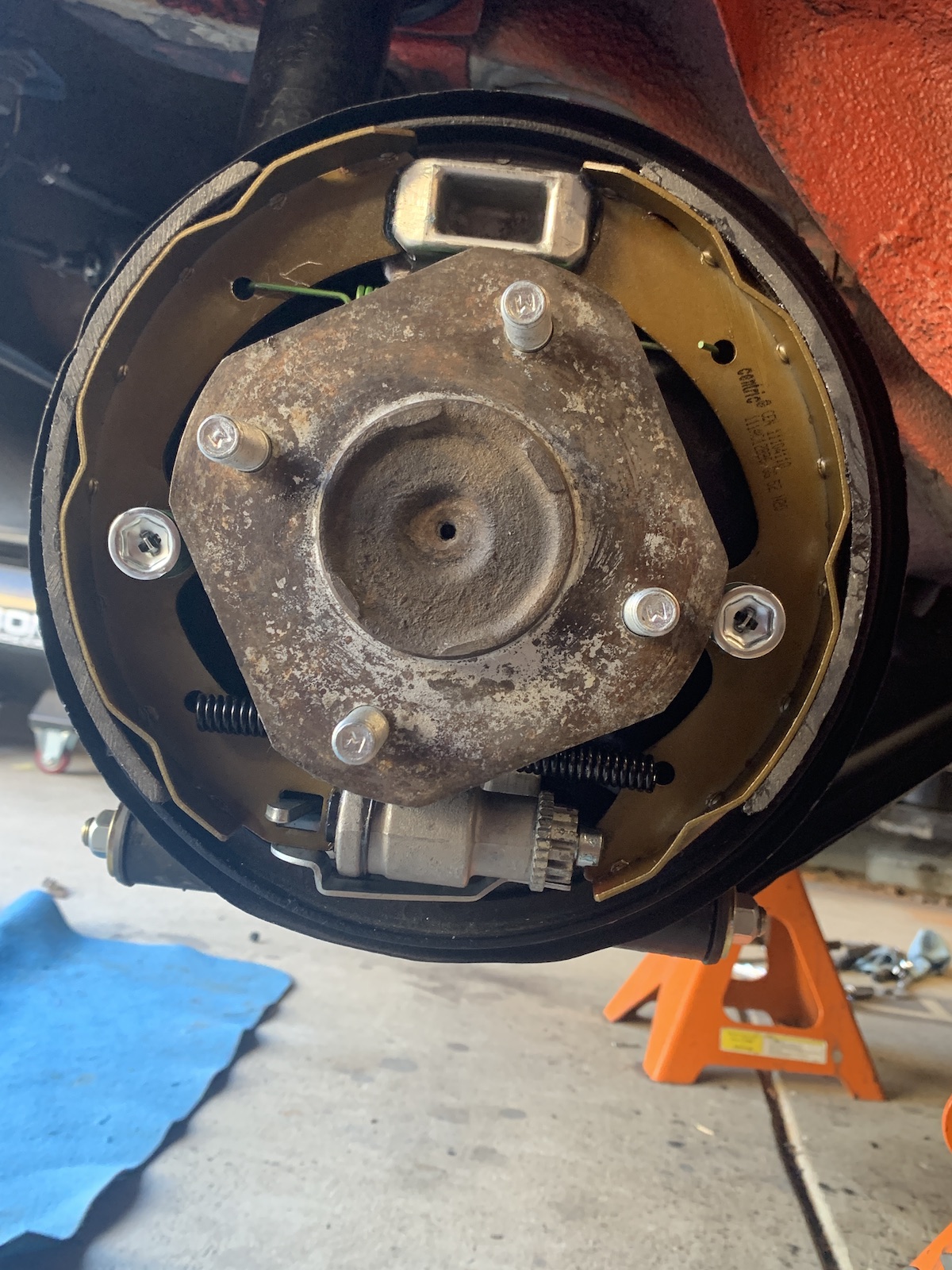

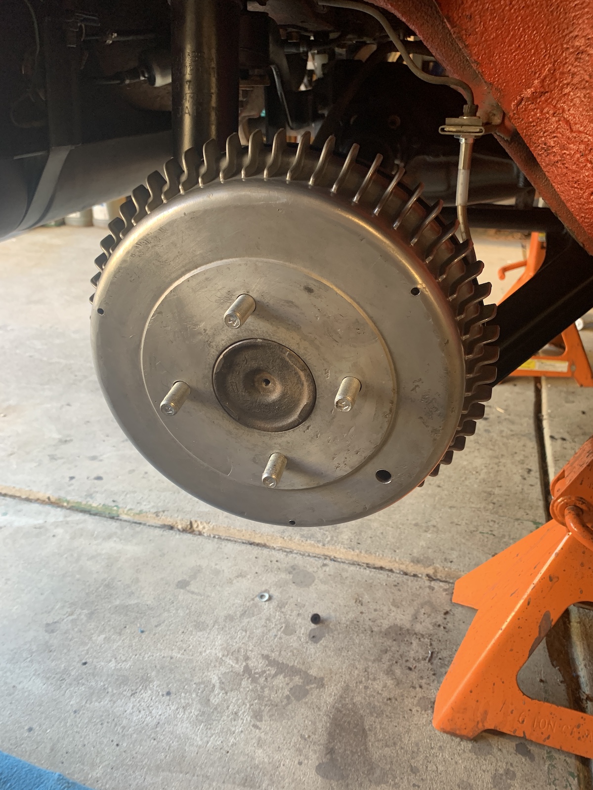

July 31, 20214 yr Author comment_626062 Got the rear brakes put back together. Next step is to get my wife out there to help me bleed the brakes. The new MSA wheel cylinders had a different angle on the inlet so ordered to new set of hard lines to fit. Link to comment https://www.classiczcars.com/forums/topic/65437-another-suspension-rebuild/?&page=4#findComment-626062 Share on other sites More sharing options...

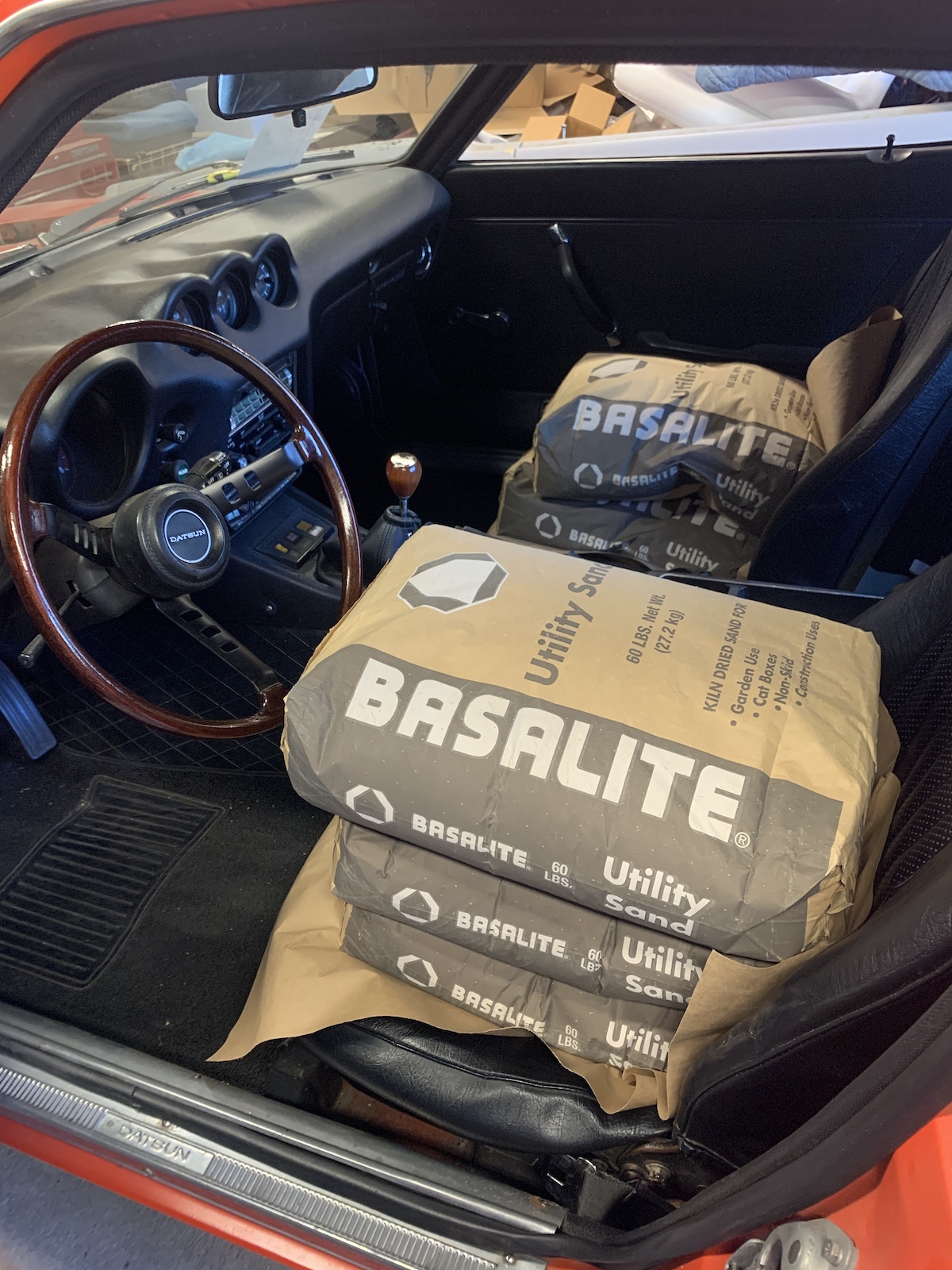

August 1, 20213 yr Author comment_626141 Here are my "two passengers" loaded per the FSM while tightening a few of the suspension bolts. Not sure what size passengers they had in mind, a Sumo wrestler, or a petite lady. 180 and 120 lbs should do. I bounced the springs several times before tightening. I guess I'll make up something to get the toe-in adjusted close enough to get it to an alignment shop. The normal flat rate alignment charge is ridiculous for 240Z's, not much to adjust really! But I'll bite the bullet and get it done, at least I'll know where it's at. Once I get a few miles on the Eibach springs, I'll let you know how much the drop was. Link to comment https://www.classiczcars.com/forums/topic/65437-another-suspension-rebuild/?&page=4#findComment-626141 Share on other sites More sharing options...
