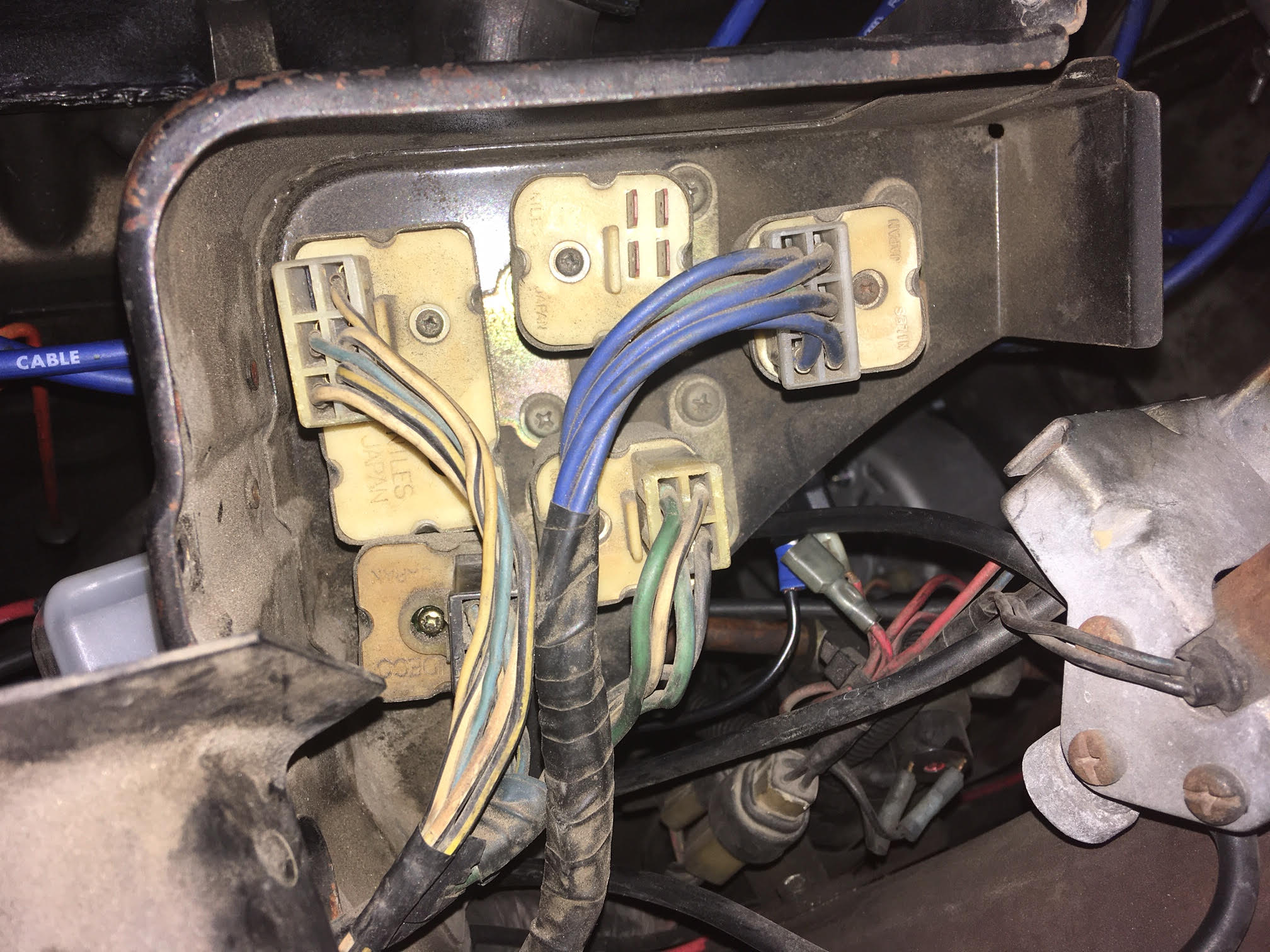

Posted May 11, 20214 yr comment_621405 So this is an odd one - I opened my engine relay bracket (the one under the black metal cover on the passenger's side) to clean the teeth on the relays and noticed one relay wasn't plugged in and there doesn't seem to be a connector for it on the harness (top middle). Any ideas what's going on here? The car runs as-is but I'm just curious Link to comment https://www.classiczcars.com/forums/topic/65368-engine-relay-bracket-missing-a-connector/ Share on other sites More sharing options...

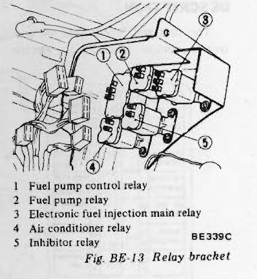

May 11, 20214 yr comment_621410 The connector for the fuel pump relay is plugged into the inhibitor relay. I am guessing you have a manual transmission. The inhibitor relay is used in cars with automatic transmissions. I haven't checked, but I wouldn't be surprised if the part number for those relays are the same. It could be the case that the fuel pump relay failed so someone moved the connector over to the inhibitor relay. Link to comment https://www.classiczcars.com/forums/topic/65368-engine-relay-bracket-missing-a-connector/#findComment-621410 Share on other sites More sharing options...
May 11, 20214 yr Author comment_621419 2 hours ago, SteveJ said: The connector for the fuel pump relay is plugged into the inhibitor relay. I am guessing you have a manual transmission. The inhibitor relay is used in cars with automatic transmissions. I haven't checked, but I wouldn't be surprised if the part number for those relays are the same. It could be the case that the fuel pump relay failed so someone moved the connector over to the inhibitor relay. Gotcha thanks! The car was originally automatic but the PO converted it to manual so them overlooking that wiring might also be it. Since the part number is the same, I'm guessing there wouldn't be any reason to swap the plugs so its wired 'correctly' right? Edited May 11, 20214 yr by chaseincats Link to comment https://www.classiczcars.com/forums/topic/65368-engine-relay-bracket-missing-a-connector/#findComment-621419 Share on other sites More sharing options...
May 11, 20214 yr comment_621420 Well, you could always move the connector from relay 5 to relay 2 and see if it works. If it does, you know you have a spare EFI relay. Link to comment https://www.classiczcars.com/forums/topic/65368-engine-relay-bracket-missing-a-connector/#findComment-621420 Share on other sites More sharing options...
