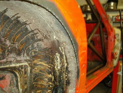

Without a full roll cage tied into the rear strut towers, you cannot remove the rear quarter panel or you will seriously compromise the unibody's strength. When I flared my two Z's I removed the springs and moved the suspension up to determine how much to cut out of the inner and outer fenders. After cutting the fenders I pounded up the inner fender, added a curved rod where the inner and outer fenders met (to make it easier to weld) and welded every inch or so. Do not continuously weld or you will warp the outer panel. (Don't ask how I know this). I trimmed off the excess inner fender and painted. I also had the gas tanks out when I did this.
