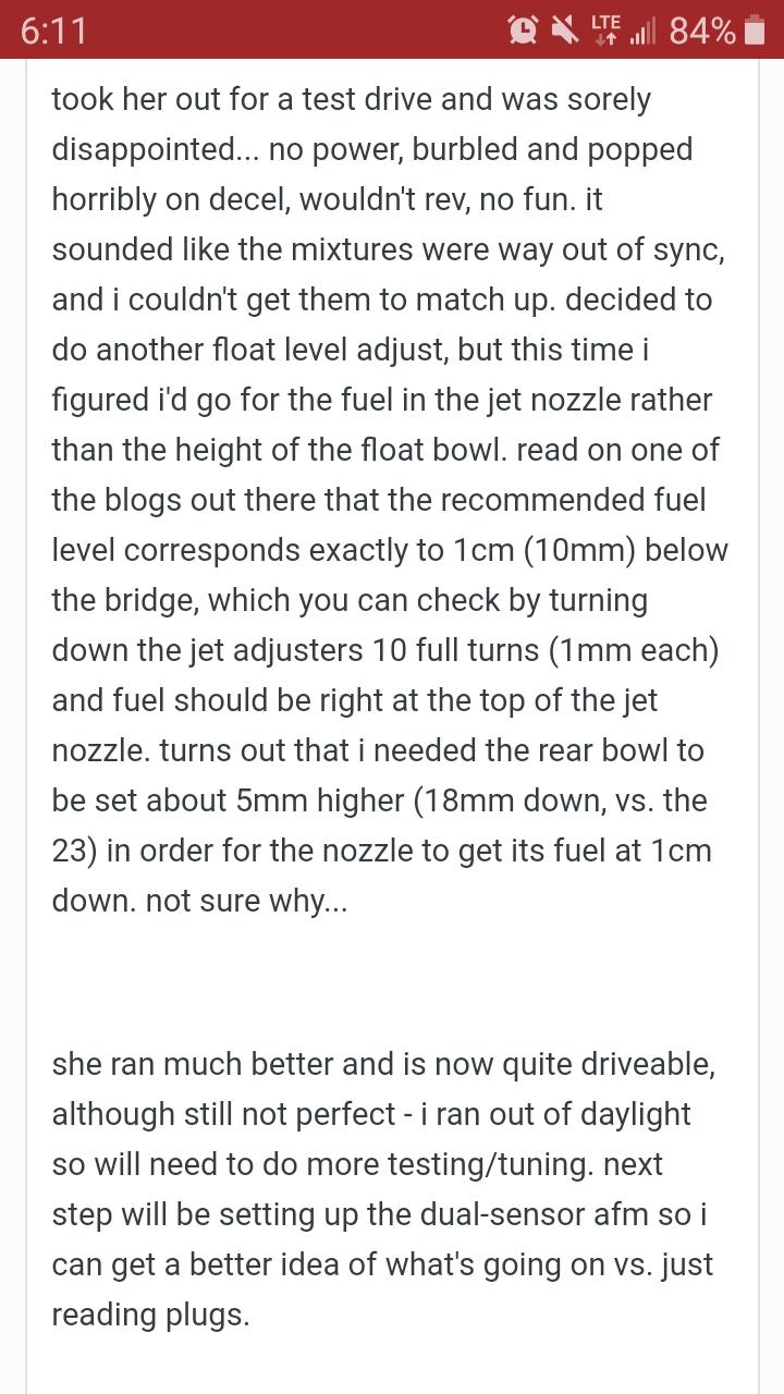

Anyway, here's a thread you might could read over and get that lightbulb in your head idea. Good luck with it and you'll get some replies, mostly questions I bet.
