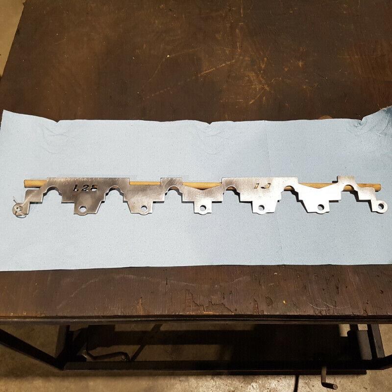

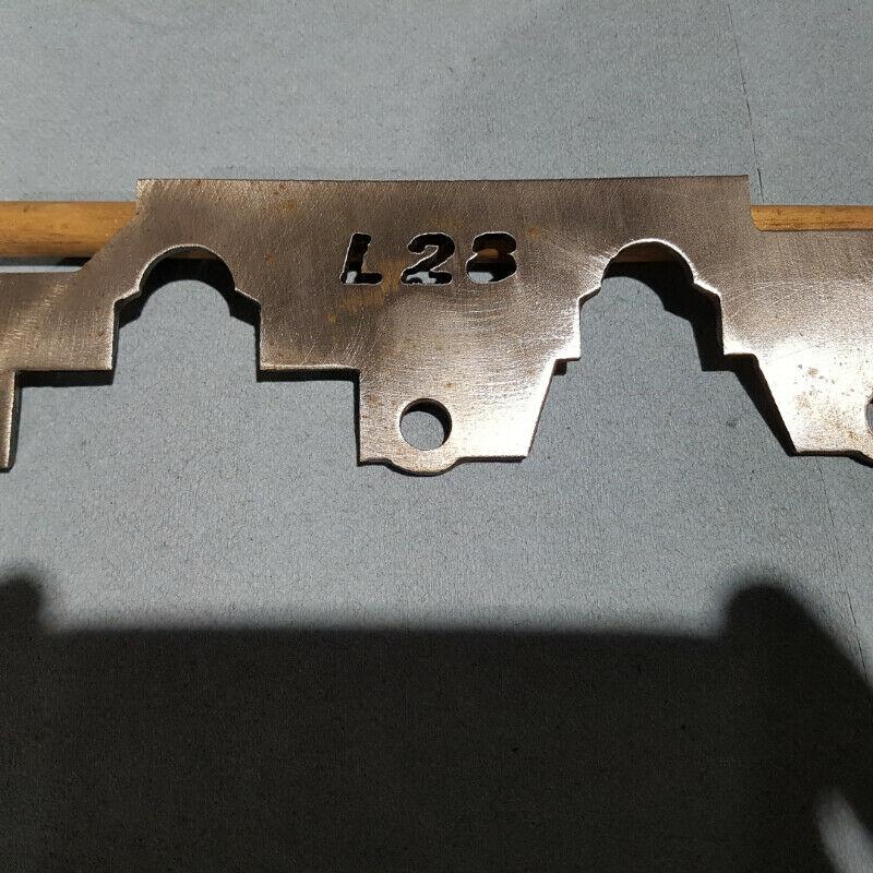

I've never seen an oil scraper made for an L28 engine before so thought I would post it.
https://www.kijiji.ca/v-engines-and-engine-parts/markham-york-region/280z-crank-scraper/1537652171
Edited by grannyknot
https://www.classiczcars.com/forums/topic/64774-here-is-a-rare-one/
It looks like it was made by Ishihara-Johnson http://crank-scrapers.com/Datsun-Nissan_L_SERIES.html
$129 new! It looks like it comes with an additional scraper that works on the upstroke.
This guy is using the same brand `IJ` scrapper, he sets to 40thou of clearance! Quite close
I would think  couple of mm
11 minutes ago, heyitsrama said:
This is pretty sweet how close does it get to the weight on the crank?
I would think no more than a couple mm away in order to wipe off the as much as possible.
Oh I see what @heyitsrama just posted, 40 thou, Yikes!  It would certainly free up some HP but not to be used on an engine that requires splash to lube moving parts.
