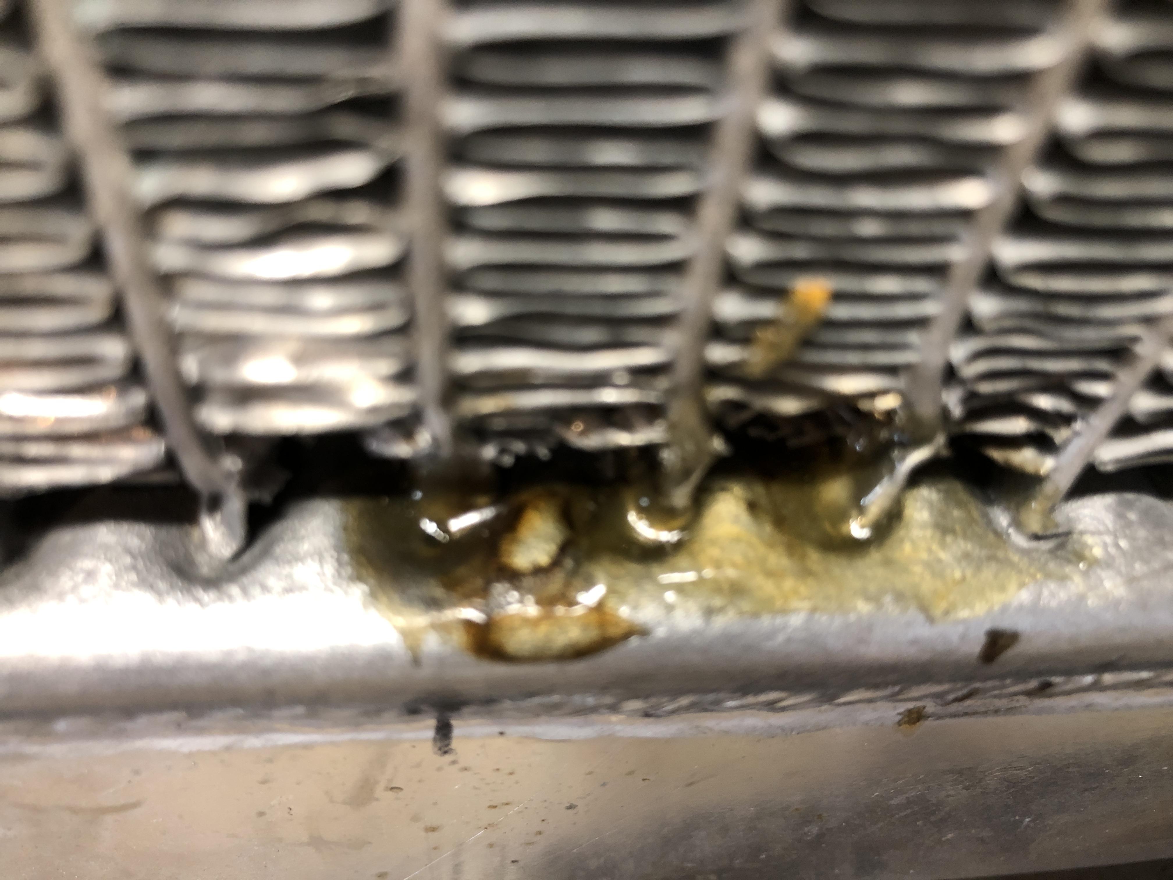

I’ll let the pictures do the talking.
Note: The story of how the hole happened is fictitious, but thought representative of the situation. I will never reveal how these holes were created in my customer’s rad....

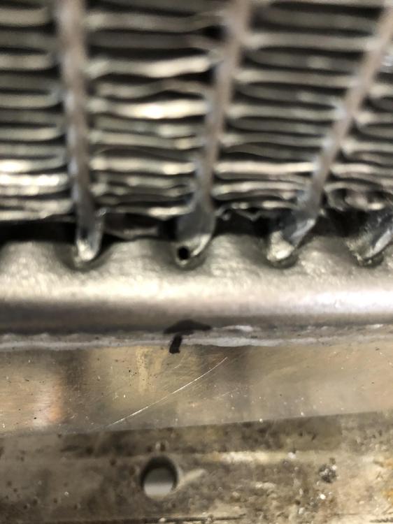

The one hole is obvious, the one to the left also has a tiny hole in the bend in the tube. Found that during the wet pressure test.
Here is the repair all done. Took literally 4 minutes until I was ready to pressure test.
And here is the magic product. STIC-TITE hot melt plastic aluminum repair rod.
