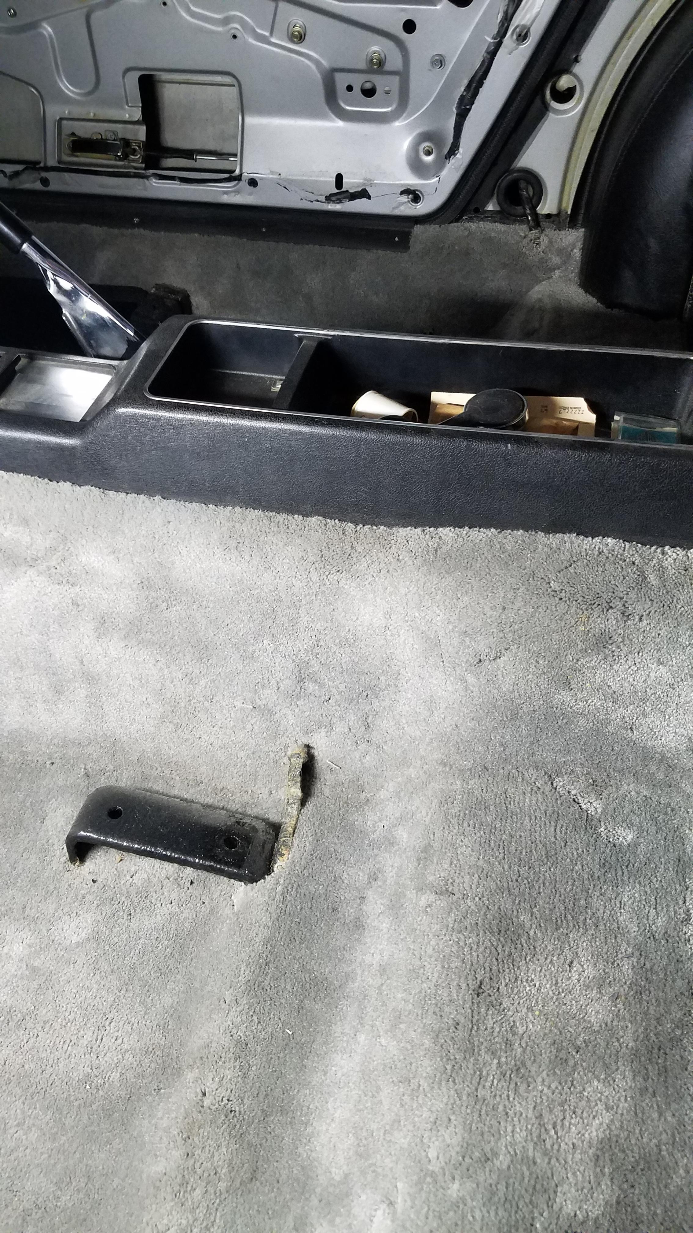

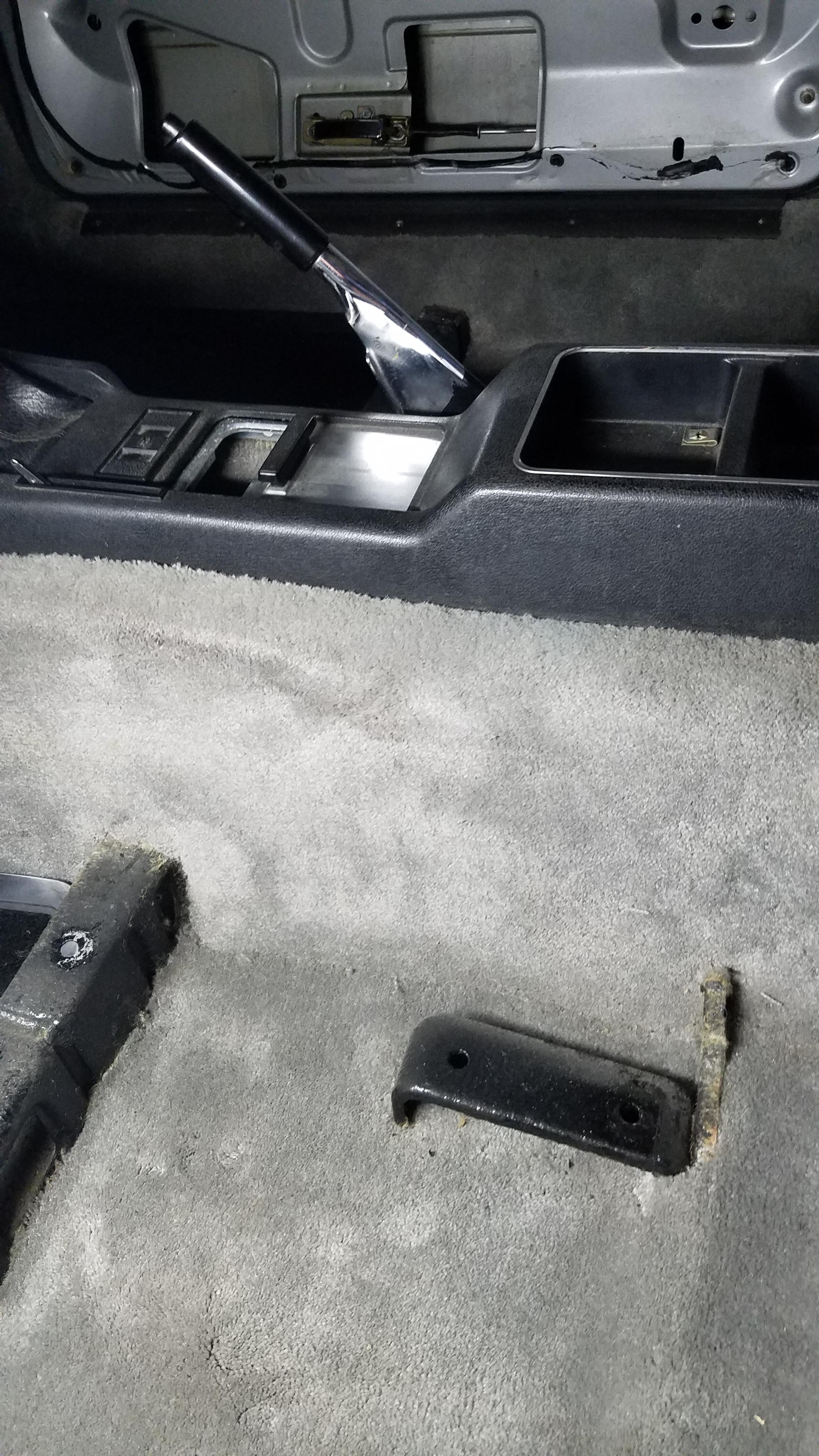

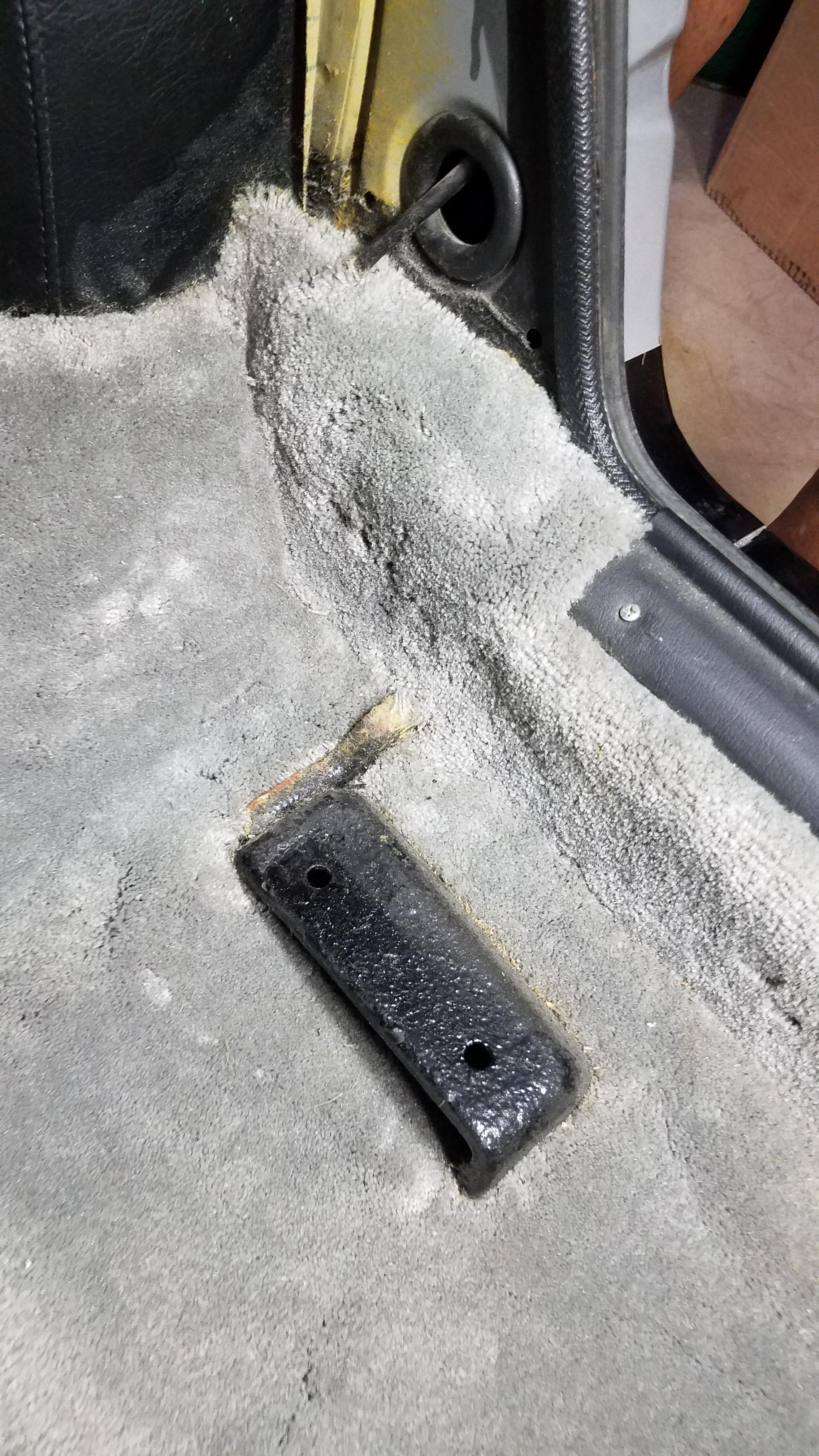

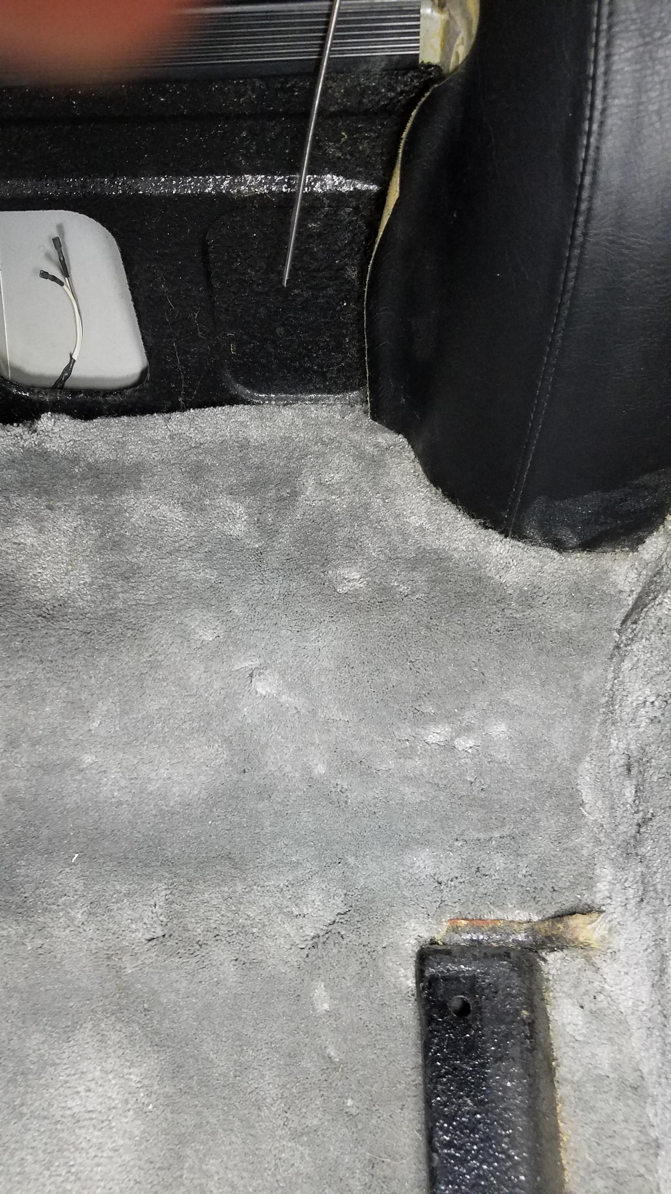

I have a 1973 240z that the seat belts has been removed, previous owner took them out to install padding and carpets which he glued them down. I do not want to pull up the carpet to locate the bolt holes, can anybody provide me with pics of your seat belts locations where that are bolted in? The pockets for the seat belt retractors are also padded and carpeted over, I do not have any of the belts or retractors, planning on purchasing all new belts assy. Any help will be appreciated.

Look under the car for the welded in nuts and poke a, well, a poker, ah ice pick, from the outside in through the carpet.
There should be a sizable pocket on each side where the retractor reel goes that you should be able to find from the carpet side too.
Thanks for the input, the hole for the belt mount lower b-pillar  can not get from outside of car. I found the retractor pockets, I will poke around with for the mounted holes from the carpet side.
